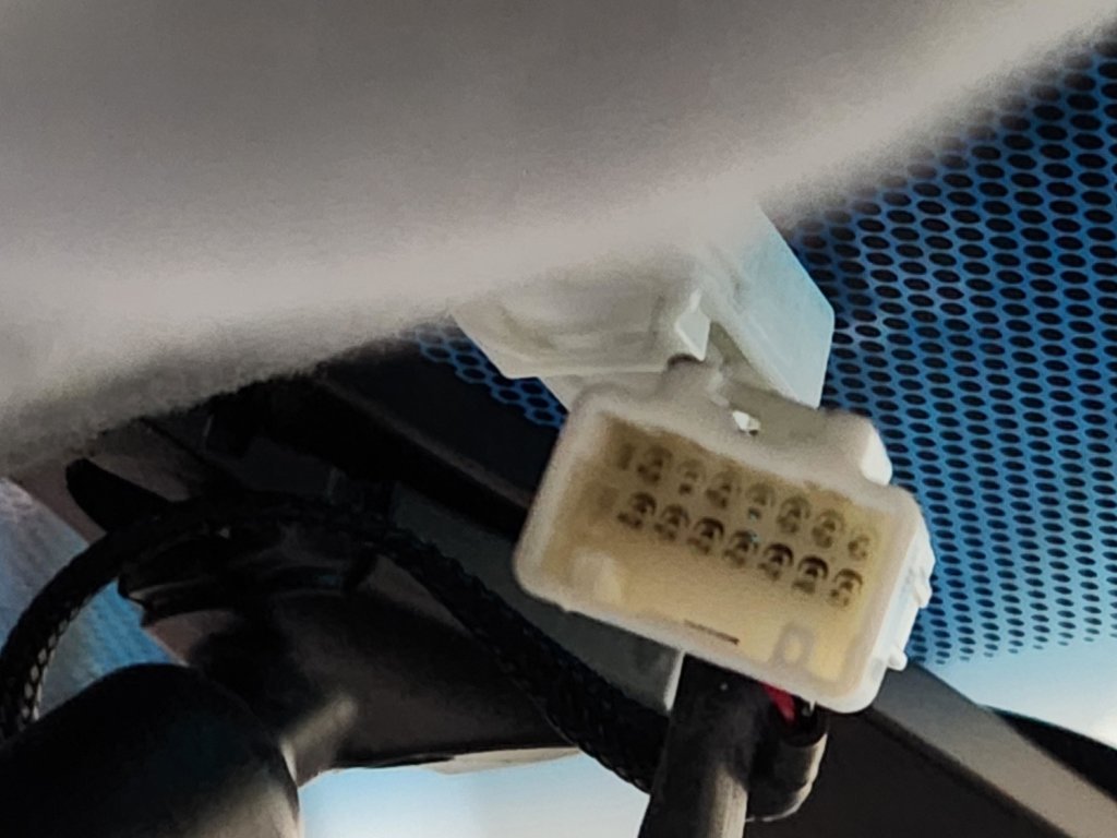

    WAIT.... The connectors don't come with pins. The pins are purchased separately and must be CRIMPED to the wires. Then properly inserted into the connectors. It's a BITCH, but if you have the proper crimper and insertion tools it's doable.

    I know someone who has insertion/de-pinning tools so I was going to borrow that, just need the parts. I know. I could be spending my time doing something better.

    This is the crimper and pin removal set that I bought. It might be somewhat easier and cheaper for you to buy the pin removal tool set and the 12-pin connectors, and try to swap the pin/wires over from the 14-pin to the 12-pin. But it's still gonna be difficult. You had trouble counting the pins on your existing harness... so your eyes might be as old as mine... :eek:

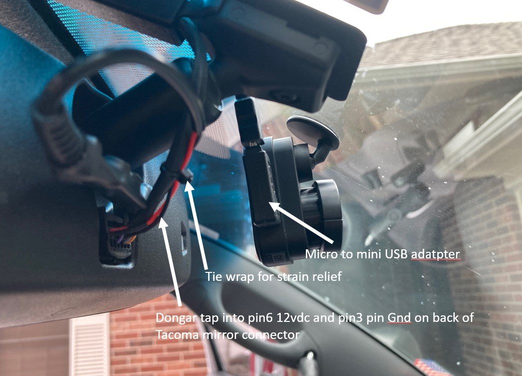

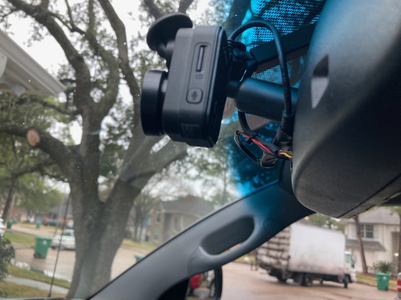

    All done.
    Used the Dongar universal and micro-to-mini USB adapter.
    https://www.amazon.com/dp/B07R7JGCL1?ref=ppx_yo2ov_dt_b_product_details
    https://www.amazon.com/dp/B094J5PH7H?ref=ppx_yo2ov_dt_b_product_details
    Finally. After considering several options I settled with this approach. I really wanted to use the Garmin mini2 dash cam since my other vehicle had one. This makes it simple using their app no matter what vehicle you're driving.
    My other vehicle uses a Dongar adapter and I was trying to use one for my Tacoma but it looks like I have a different OEM pin out on the mirror plug. Someday I'll search for that harness #.
    The taps are secure when using a tie wrap for strain relief and won't pull loose. The dash cam requires a micro USB so the adapter mated it with the Dongar mini USB.
    Anyway, this is pretty slick and I avoided routing a cable inside the trim or trying to de-pin and re-pin connectors.
    These dash cams are so small I don't see them behind the mirror and you can't see from the outside unless you're right in font of the windshield looking for it.
    Works great! On to the next mod.

    Glad to see you got the solution worked out. I'm a little curious to know if other Tacomas like yours have a 12-pin or a 14-pin connector on the mirror. Dongar seems to think they're all 14-pin... so maybe yours is a unicorn.
