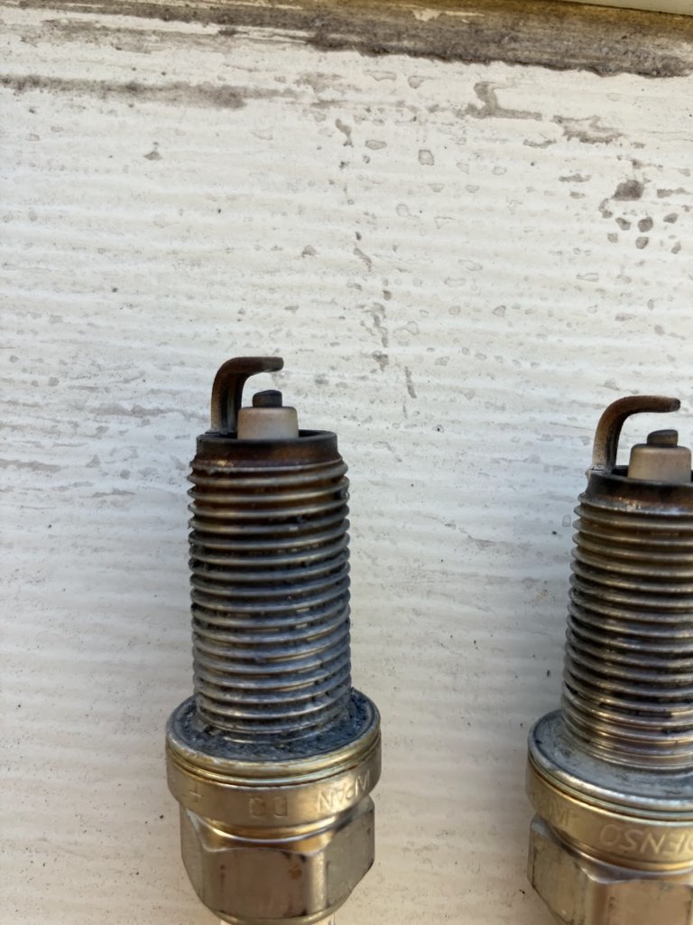

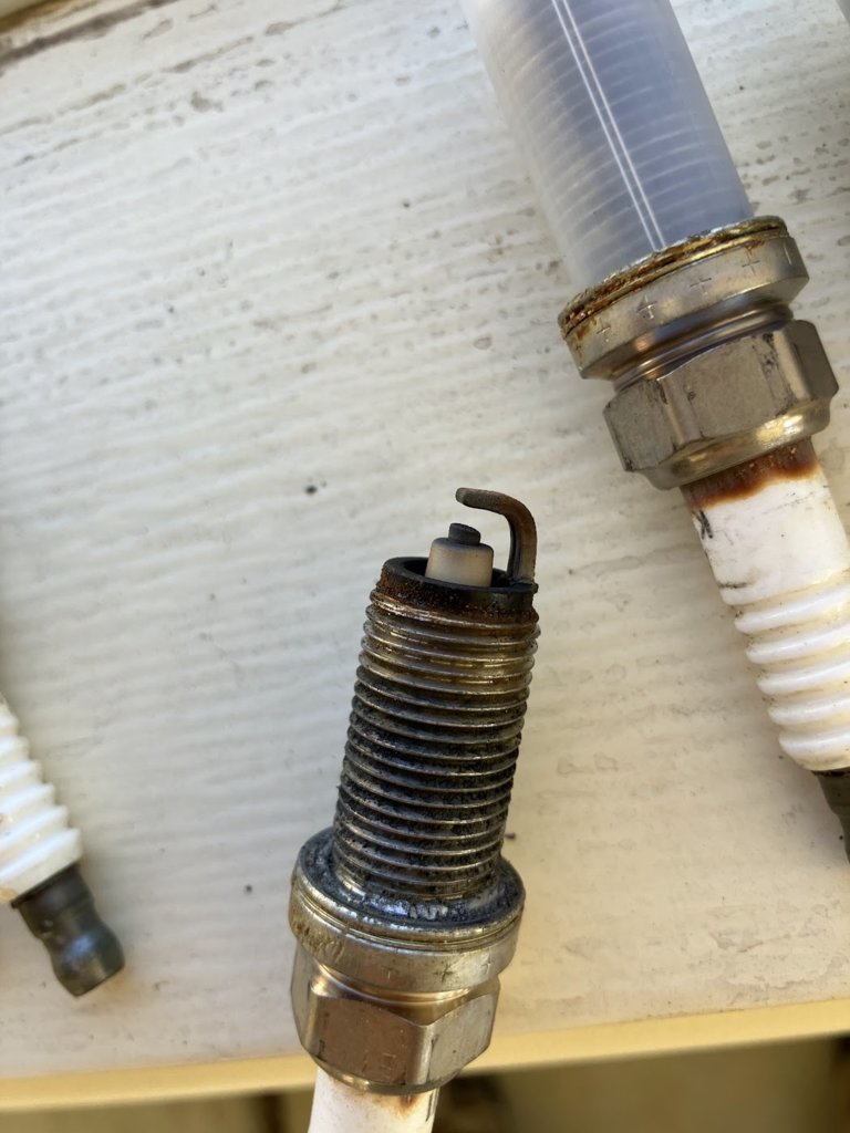

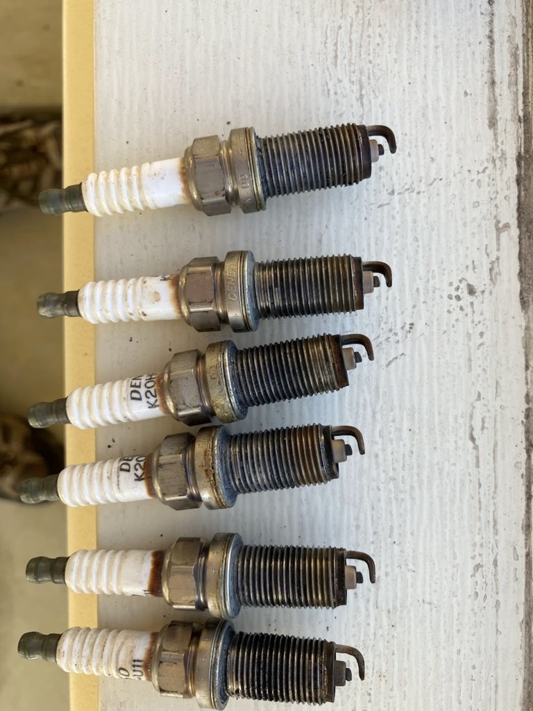

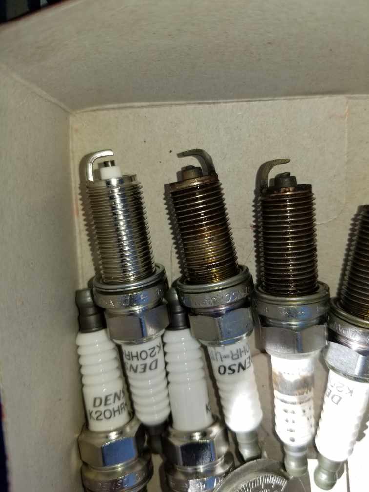

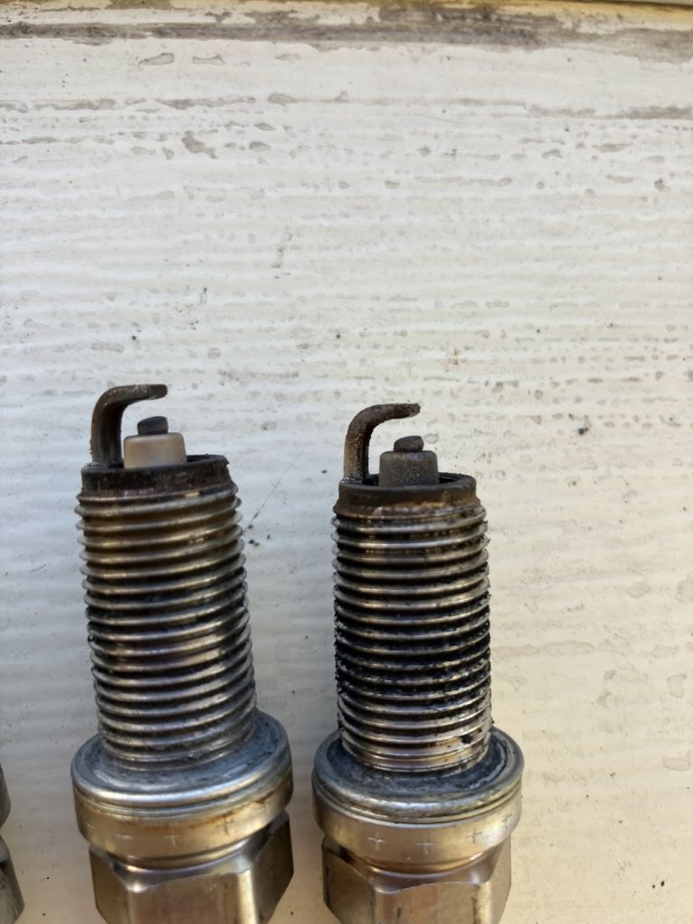

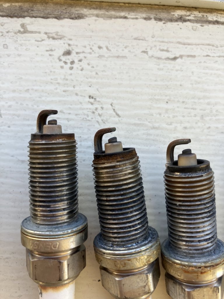

    12 years later and 120,000 miles, I broke down and changed them. (Yes, you read that right)
    Yeah, I know. Neglect....
    Those on here that know me, know I HATE working on vehicles.
    I'll happily help others diagnose and work on their stuff (if they need help).
    But my stuff...No. I'd rather dig ditched than do automotive work.
    Things I learned.
    1. Anti-seize does not help IF you don't change the plugs regularly.
    It became really "sticky" and gummy. It fought me the whole way out.
    It wasn't the carbon build up on the plug. It was the Anti-seize. (I had previously used the Silver type)
    2. If you go by the tightening process on the Denso box. It says to bottom the plug by hand, then tighten 1/4 - 1/2 more turn. Even at 1/2 a turn, it wasn't close to 15 ft/lbs. It took about 1/4 more of a turn to make it to 15-16 ft/lbs.
    3. Buy a set of magnetic spark plug socket. Life is SO much easier.
    4. I actually torqued my spark plugs. The first time in my life I've ever done that.....
    Mostly because I bought a digital torque wrench for a different job. And figured why not use it?
    And of course, here are the pics.
    Gaps were: (Plugs were Denso K20HR-U11. Previously gapped at .043 when installed @50k)
    1. .057
    2. .055
    3. .054
    4. .056
    5. .056
    6. .060

    115k on mine when I changed them after I bought it used. Service records showed a change at 15k. They weren't the OEM ones with the numbers on the terminal and were all Denso: not 50/50 Denso and NGK. They looked worn but the truck ran fine. It doesn't run any different with the new ones (Denso OEM 90919 - 01235/K20HR-U11) and the gas mileage is the same. No signs of anti-seize on the nice plated threads and I didn't apply any to the new ones.

    If they’re original, one side should be NGK and the other side are densos.
