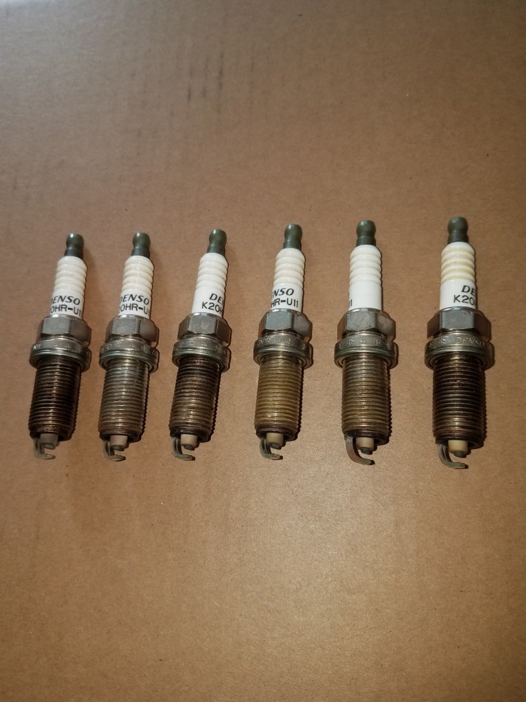

    What's kinda interesting to me is that, from just a glance without knowing anything about anything, the pictures of plugs I see here in the 2nd gen forum with 120k or more miles on them look to me like the plugs that are changed on Toyota time. Here are mine done right on the dot at 30k miles on my truck that had 60k miles on it at the time. Not a great picture, but the electrodes look just as worn as some of the others with far higher mileage.

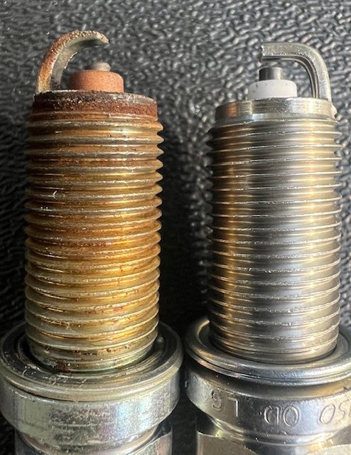

    115,000 on these
