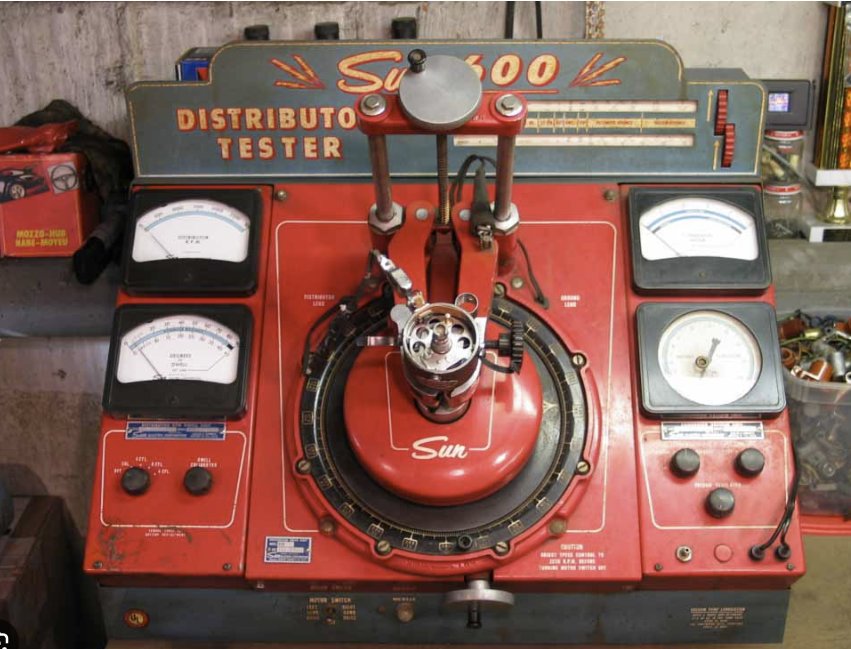

    I was at a diner last weekend that was an old shop.
    They had the big old Sun Osciloscope in the corner for decoration. And this bad boy
