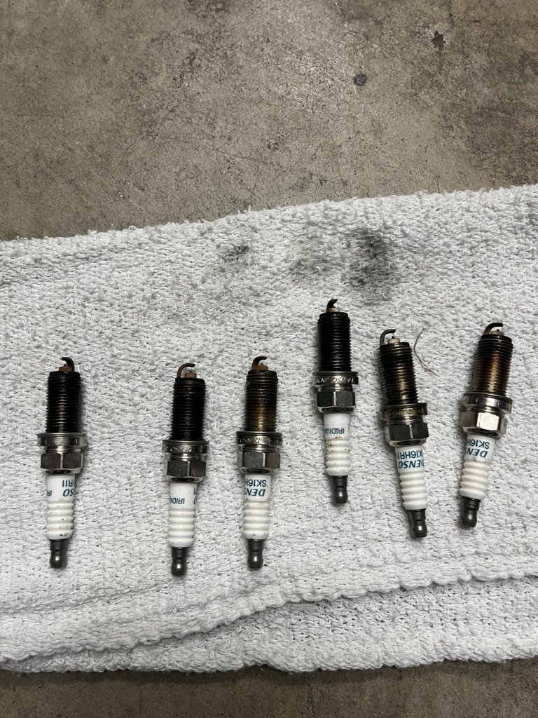

    I put 91k on my original set of plugs and they eroded to gaps similar to yours; anywhere from 55-61. I think I've changed them twice since then

    Why would they use Denso's on one side and NGK on the other?
  11. Nov 12, 2024 at 8:11 AM
    #71
    b_r_o
    b_r_o Gnar doggy
    Nov 17, 2016
    #202672
    14,474
    Alex
    WA
    2015 DCLB
    I believe Toyota was trying to spread the money around and keep both suppliers happy.

    I pulled my factory plugs at 125k. Gaps were fairly large, but I couldn't tell a difference in performance between those old plugs & the new ones I installed. Hell, I don't think I even saw a bump in gas mileage
    Now I run 50k. Figure it's a good middle ground between 30k & 125k lol
