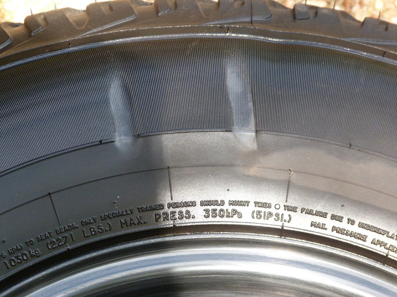

    I was getting my 2013 Access cab cleaned up for a trip and decided to check the spare. The picture shows what I found when I lowered the tire. I don't believe the dents in the tire will hurt anything but I rotated it when I put it back up. In addition, the tire pressure was only 15psi. I think I'll be checking the spare a little more often after this.

    looks rubbed, like it was loose enough to move slightly - probably from deflating while in there. Looks fine though. Like you said, rotate it and stuff it back in there. Glad you caught that it was low before you needed it. A little maintenance goes a long way.

    Mine ... as well as others ... looked the same when lowered ... kind of pissed me off.

    You can also flip the tire when its in the stored position so you dont have to take it down. Its still a good practice to lower it every once in a while to make sure the hoist is working.

    I actually put some rubber sheets on my spare where it contacts the frame and it helped stop those dents.
