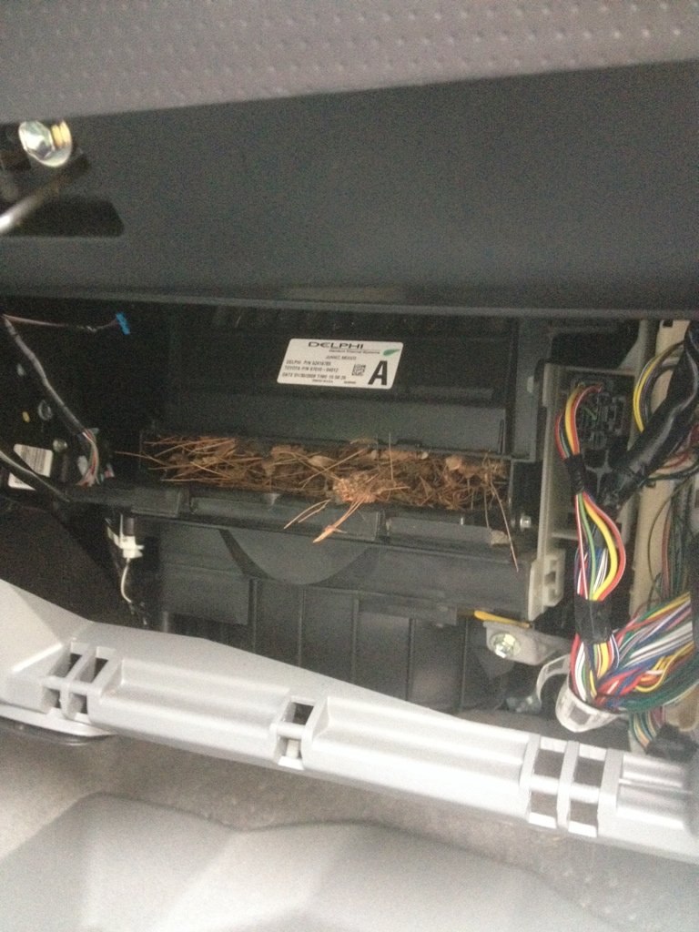

    When I bought my used 08 last Christmas I wasn't getting much airflow at any of the vents. Why? Then I found this!4a4urenu_12785833b433e9dd159169124d0546f516362e5c.jpg
