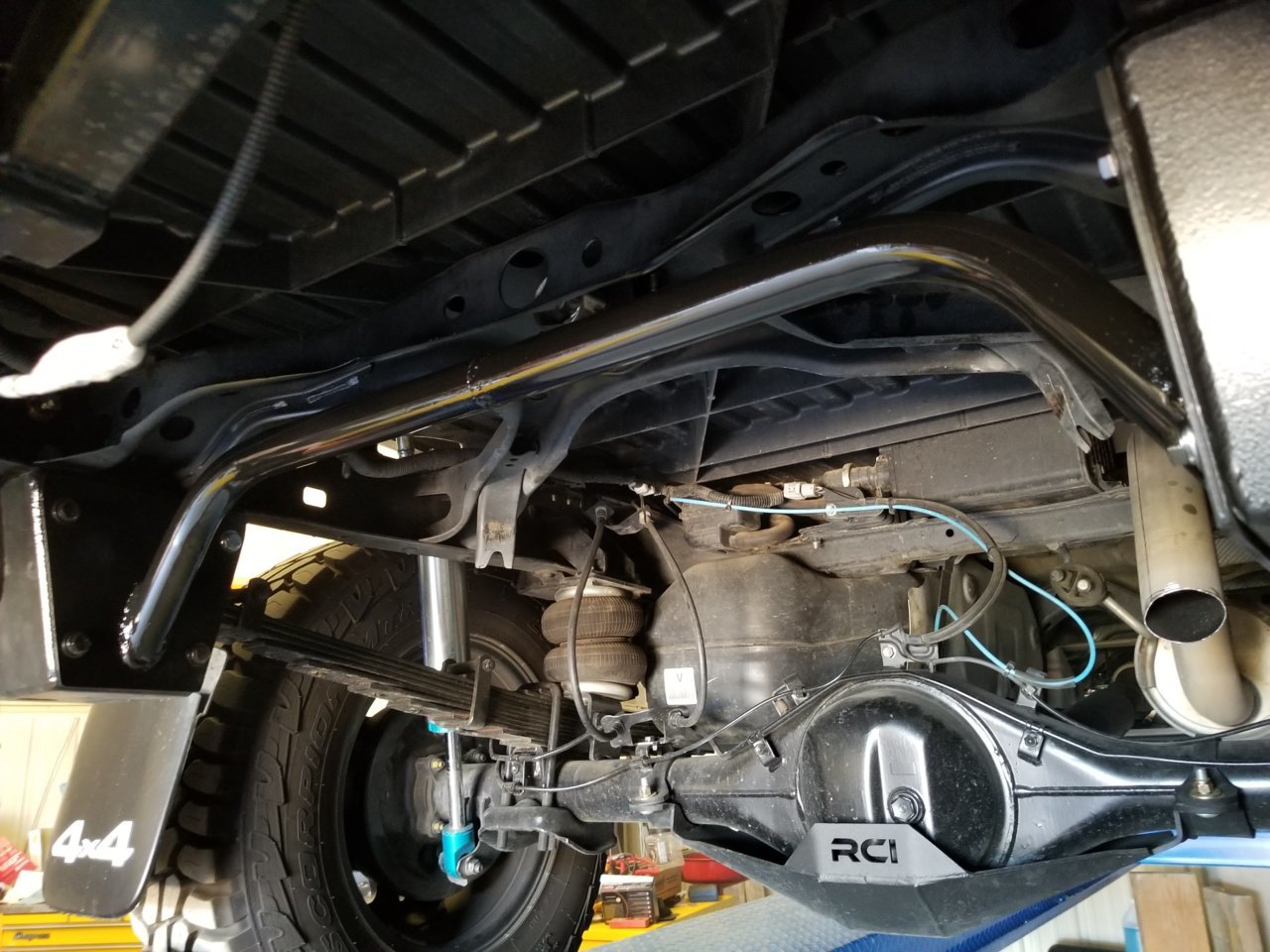

    You have to take care of your truck. Here is the frame on my 2012 and I drive through salted states every year.
    TRDSport10 and TnShooter like this.
