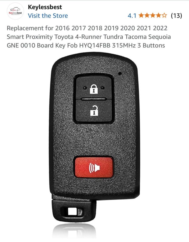

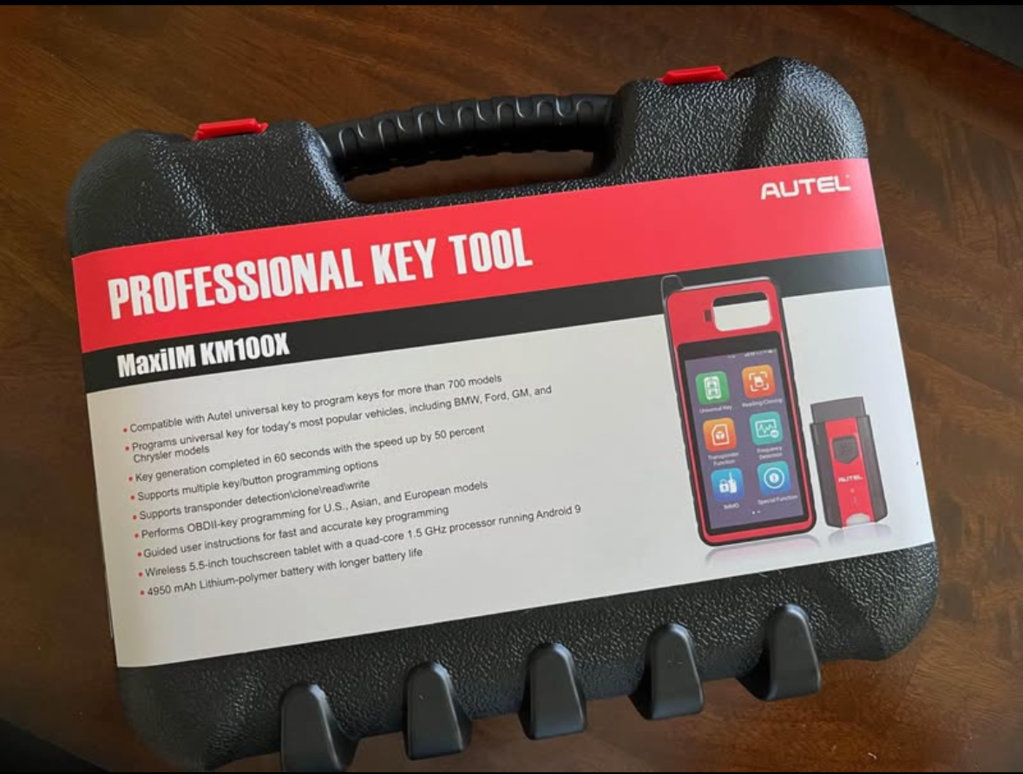

    Get yourself an Autel KM100 programmer and some blanks from Amazon.
    When I got my 3rd Gen, it came with only one fob. Dealer quoted me the same price as you so I looked into programming my own fobs.
    I bought the Autel programmer on eBay for $400. I bought three blanks from Amazon for $75/each. I followed a YouTube video on how to program them.
    After I programmed them, I sold the Autel on FB marketplace for $320. So basically I ended up paying about $125/fob (it came out more because I initially bought a fob for $70 that didn’t work).
    If you try it, make sure to get these fobs from Amazon. They worked. Another one I bought on eBay didn’t work.

    You’re experiencing the same thing I did!
    The first thing I did was buy a blank fob on eBay and then called a local locksmith with a key programmer.
    The locksmith told me he couldn’t do it because he didn’t have updated software for a 2023 Tacoma. That’s when I started looking around the internet and found a guy on YouTube that showed how to do it with the Autel.
    I ordered the Autel and tried programming the fob I got from eBay but it didn’t work. Then I got into the serials and codes and ordered one more on Amazon. It worked so I ordered two more. Now I have four functioning key fobs.

    Autel KM100 programmer Is $381 on Temu. I was looking at this about an hour before i seen this post. Im so happy you had good results with this. Its this route or Tom’s for me.
    I hate how stupid expensive these keys are these days.

    I was so stoked after programming my fobs that I even thought about advertising the service to other Tacoma owners!
    That Autel device is straight up scary. I watched some other videos about it and you can basically program a fob for a vehicle without an original!!!
