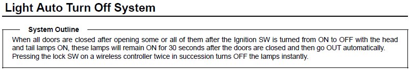

    I don’t have a remote fob but ik on my 2012 the headlights go off when I turn off the engine IF THEY WERE ALREADY ON. However, if the engine is already off when turning the lights on, they will stay on. Maybe same with your truck?

    They are supposed to go off when the driver's door is opened however if you hit the switch after the driver's door is opened they will stay on.

    If they were on when you turned the truck off, they will go off when you open the drivers side door.
    Read that again, make sure you understand it.
    A bad door detection switch can cause them to not turn off.
    Easiest way to check this is look to see if the door ajar light comes on when you open the door.

    Here's two ways to make them stay on:
    Turn off truck after opening Driver's door.
    With Driver's door shut, turn off truck and exit out Passenger side (like if my wife wants to stay warm in the truck while I run in the store, but then she decided to turn off the truck and get out)

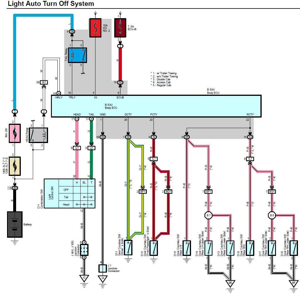

    Timer inside Body ECU, triggers are the door courtesy switch(s).

    Sorry for the stream-of-conciousness posts here, but I just opened both front doors and the dome light came on. Held in the button in both door jambs and 22 seconds later the lights went out. Soooo, does that mean the issue isn't the door jamb switch?
