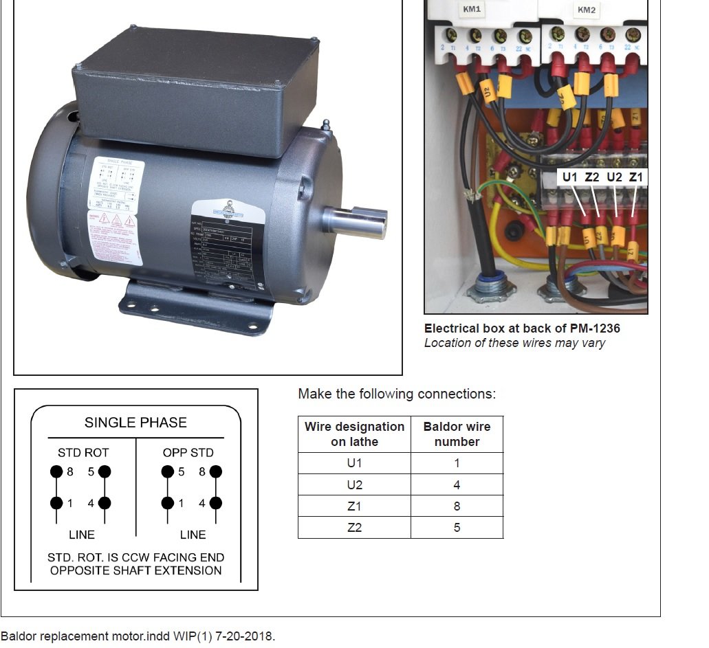

    Okay, lathe is running and about 95% set up. I still need to wire the coolant pump, but that's two wires and done (have to wait on that ... reasoning below).
    Weird thing, the breaker (at the lathe, not main box) trips when I put the spindle in reverse. These are things that happen when you are colorblind and try to wire a motor yourself. Will have to bring the lady in to look for me when she's home. I was pretty confident in my connections, could just be the wire nuts not being an optimal size.
    Fucker is running, leveled, digital readout installed and configured. Everything is caulked up so the coolant doesn't leak. I might need to fine adjust the headstock angle, but I'll wait until I get a longer part in there for that (when it actually matters).

    Most everything is numbered, except I have to go on color for the wires entering the motor terminal box. They are numbered inside of the lathe's electrical box, but not once those wires enter the motor terminal box.
    This stuff is foreign to me, but to me this diagram ends in two bunches of 4 wires, each under their own wire nut. 1,8,5, 4, ground are the only wires coming off the motor. The chart on the right side are designations on the lathe itself. Any thoughts?
    This is what I ended up with;
    Wire nut #1 = 1, U1, 8, Z1
    Wire nut #2 = 4, U2, 5, Z2
    ground also wired to the obvious place under the terminal screw.
    tonered[QUOTED] likes this.

    Um, I'd love to help, but I usually deal with electrics by process of elimination. Generally, that means that some of the electrons in the wire get eliminated through my toes.

    Only other thing I can think of (if my colors are matched correctly), is that the 1 and 8 go under the wire nut, and the U1 and Z1 get spliced in farther down the wire. Hmmm

    Ooof. Does the motor turn when your done or did the shaft shoot across the room? If you made a rail gun, I know a small armada that would like to talk with you.
