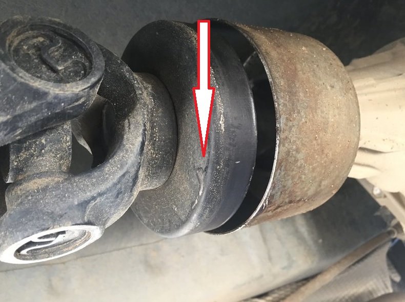

    Name the part below time. = ) Also, extra credit if you have a part number. LOL
    It goes on the rear of the transmission and your slip yolk goes through it. My truck doesn't have one. Someone mentioned they help with vibrations and I get a little play in this area. Figured it would be a cheap repair.

    It's just a thin metal shield. Since the drive line slips in and out of the transmission, the yoke and splines need to be protected from road debris.
    As far as a part #, I highly doubt Toyota sells like by itself and would likely only be available by purchasing a new drive line.

    Its not metal but rubber??? Right? It looks rubber from the picture. Its even thick. If it were all steal it would weight 5 pounds....

    It's metal and cupped, not a solid piece.
    Also, in that picture it appears the vehicles been lifted and the yoke has been pulled out from the transmission. They have spacers that bolt onto the rear differential flange to help correct that issue.

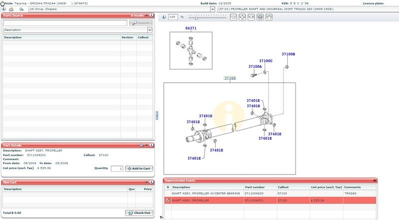

    PM me your VIN # and I can look it up for you and see if it's an available part.

    Called a guibo isolator. To dampen driveline vibration and NVH (noise, vibration, harshness). Usually bonded to and part of the driveshaft....
    edit: It is probably only used on certain builds, bed lengths, cab lengths, transmission combos. Seeing one on a different truck is a poor indication "you need one", LOL. If anything be glad your truck doesn't have one...

    As suspected, not available by itself, Toyota only sells it with a new complete drive shaft.
    How did it go missing in the first place?
    I'd say as long as you have the shield on the back of the transmission and you're not thrashing the truck in the dirt/mud you'll be ok without it.

    It's not that piece, so look else where. It doesn't serve any vibration/balancing/black magic purpose. It's nothing more then a stamped steel shield.
    There is no Guibo Isolator/flex disks on the Tacoma's. Those are mainly used in car applications.
    I'd start with checking u-joints if you think it's a drive shaft related vibration.

    There is no way it "fell off". Your trucks build did not require it, hence why it is not there. Even if it is not a true Giubo, it is a dampener; but it is tuned only to work with a certain length driveshaft, etc. Putting one on where it is not needed will likely just imbalance your driveline, then you will have REAL problems...

    If the u-joints were replaced by a shop, they probably took the shield off. It's not that big of a deal.
    The spacer was mentioned because of the picture you posted, so now knowing that photo isn't yours, the spacer doesn't apply to you.
