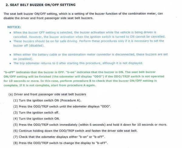

    i read this on here somewhere.
    1) Turn the Car 'ON', but do not start the engine (Leave your foot off the brake). Cycle your trip reset knob until it reads ODO. Turn the ignition back off. Wait a couple of seconds.
    2) Make sure seat belt is not fastened
    3) Turn the ignition back on, do not start the car (Leave you foot off the break) As soon as you see everything light up, press and hold the trip reset knob and do a long 12 second count.
    4) Keep your finger on the trip reset knob. Fasten your seat belt, as soon as you fasten your seat belt, you should see the ODO display go from XXXX miles to "b-on". At that time take your finger off the trip reset knob and press it again. It should cycle to "b-off". You should be all set and turn the ignition off and unfasten your seat belt.

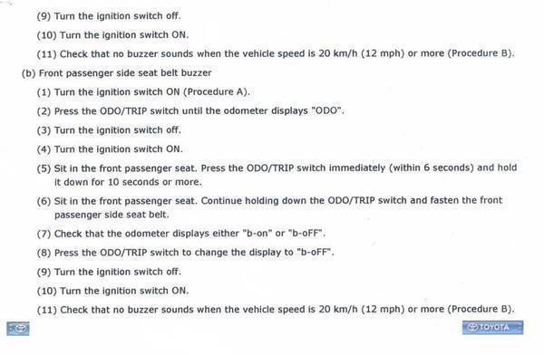

    this works for the driver's side. for the passenger do the same but have sit in the passenger seat
    It worked on my 09 to turn off that seatbelt chime anyway.

    Let us know how it works out. Many others have had success if you follow the steps completely.

    Just wanted to say thanks again for posting this info. My workday is 10k times better! The simple things...
