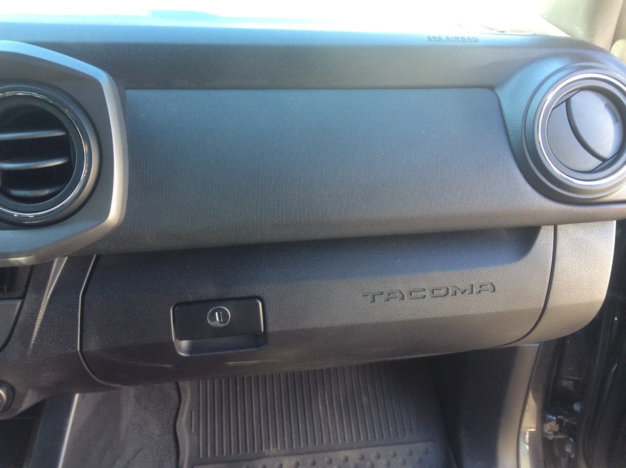

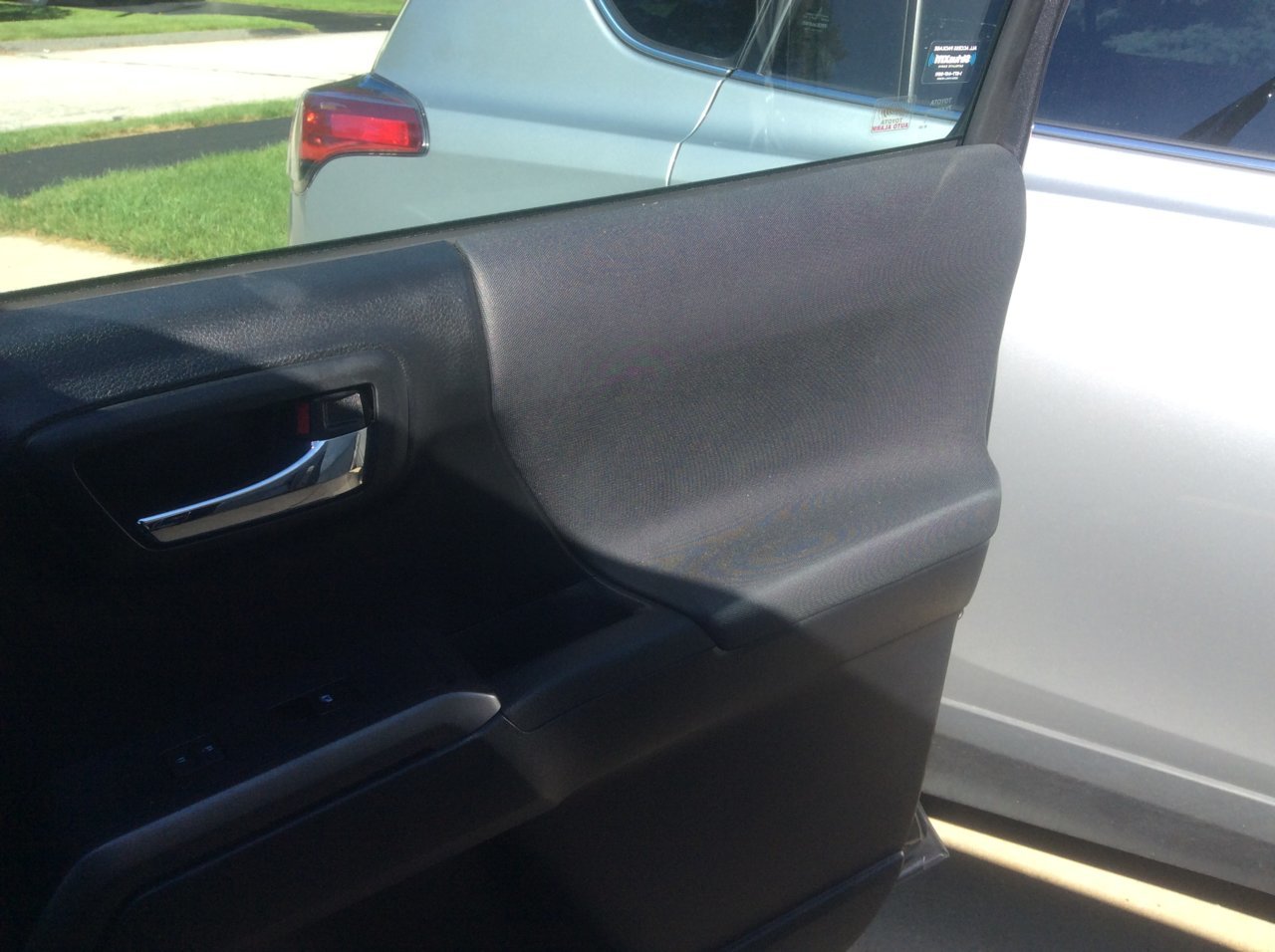

    052886A6-17AC-4BF9-A57B-D4D6B19EC90B.jpg DD13EDED-4974-4B75-936A-D00E874283AE.jpg how do these panels come off? I want to leather wrap them like the red or caramel dash inserts.

    I have not pulled apart the dash yet but the door panels come off as one large piece, look up the speaker install threads for instructions. I'd imagine the cloth like inserts are glued on.

    I’m reading it now.they are melted ln place. I’ll have to grind and use epoxy or small screws and washers to put it back together.

    I wonder if it would be possible to wrap what you want over them. I don't know if there is room at the seams, but it might be easier than grinding it off.

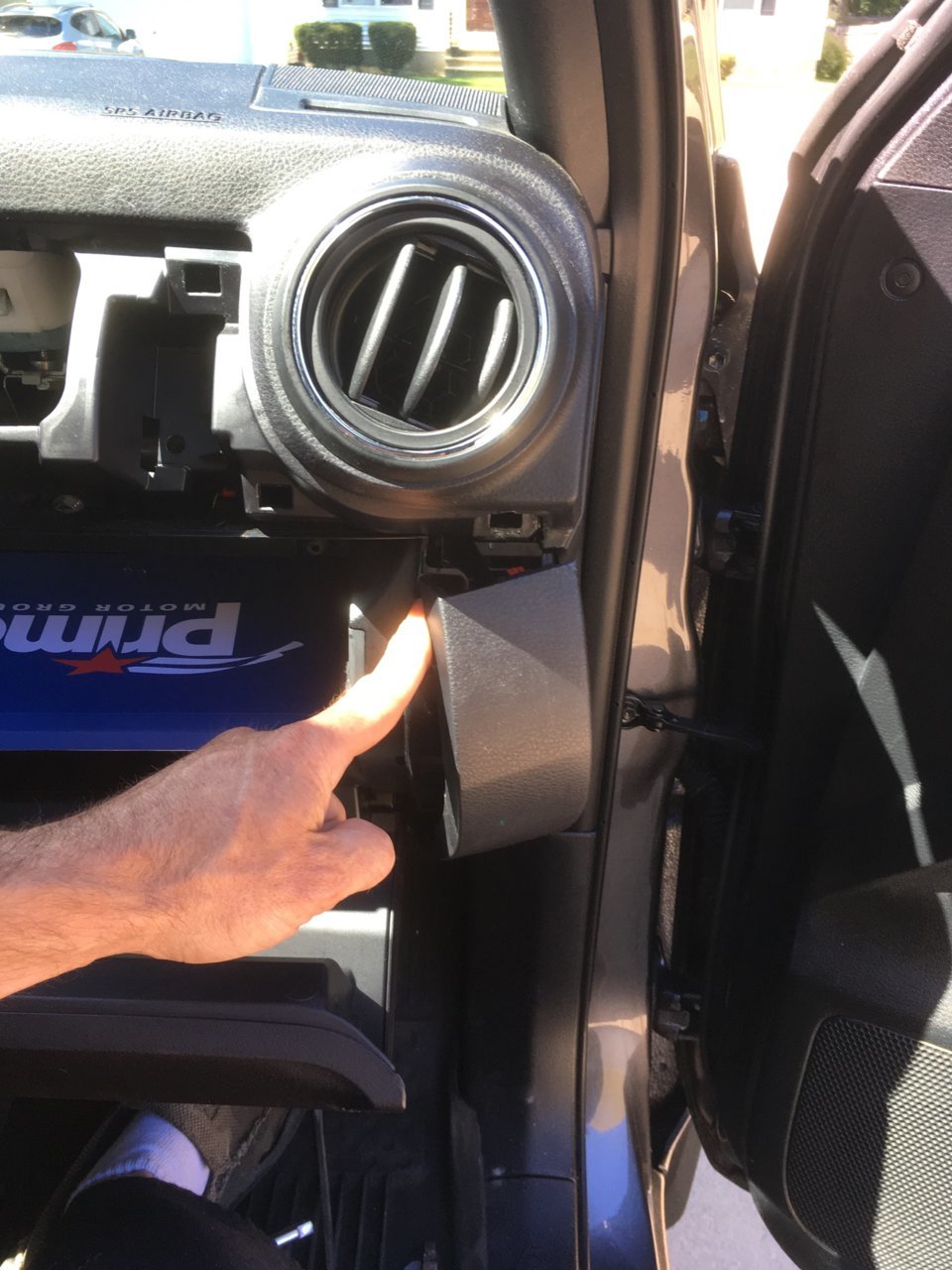

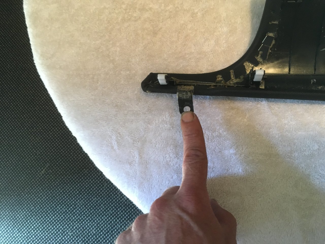

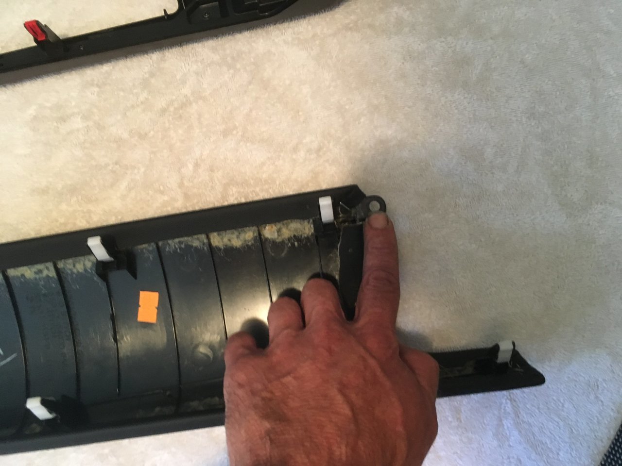

    0A4B0542-06E9-4B46-9506-FA24C024C28A.jpg 30ABB990-7F62-404C-881E-C746EF041E87.jpg Not to bad.2 screws and a whole lot of fear. I haven’t even made a payment yet.?!! After doing this to my 03 I’m confident in knowing when to stop.

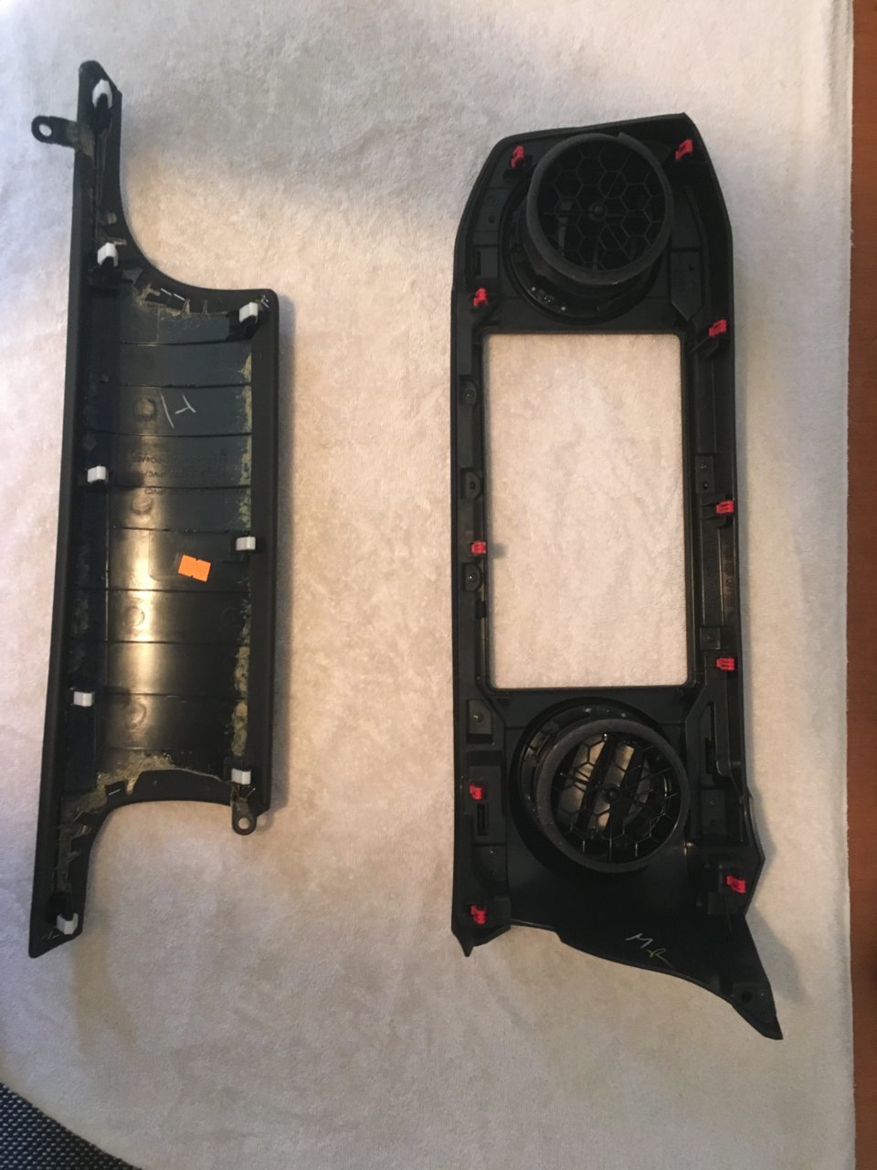

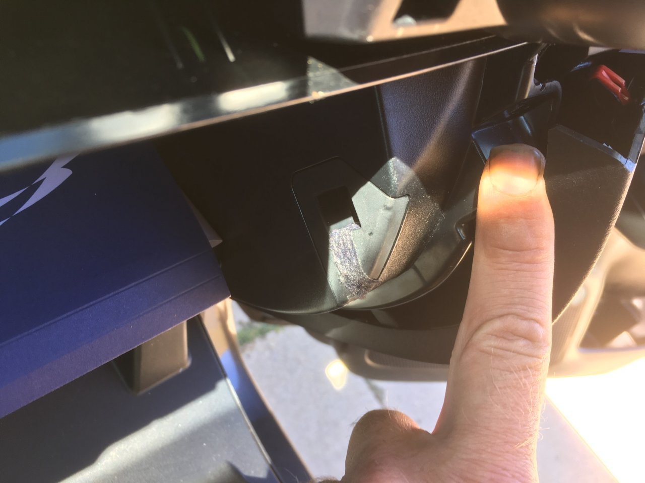

    2 screws. You need to move the panel under the dash over a bit,it suck a little. The material is glued and stapled on. 1DBA82DC-A485-44E0-A6A7-87F5CEABFA86.jpg4DE0505F-D076-450F-96C8-5C325E218B2B.jpg35BC9F6B-8D50-413A-A367-94359E3E0489.jpg16433DAE-13BD-426E-9419-9B9989EAB3F7.jpg940075FE-D423-4D8A-9C1E-AAD81326B14A.jpg

    My experience with the panels that are glued on is that if you want your next wrap to be perfect you have to strip every last bit of the glue off. If you don't you see every little bump you missed.

    So it's 2 screws and just pulls off? Do you have to remove the headunit dash first?

    yes. That just pops off to. You can see one screw under it. The other is under the trim next to the glovebox.
