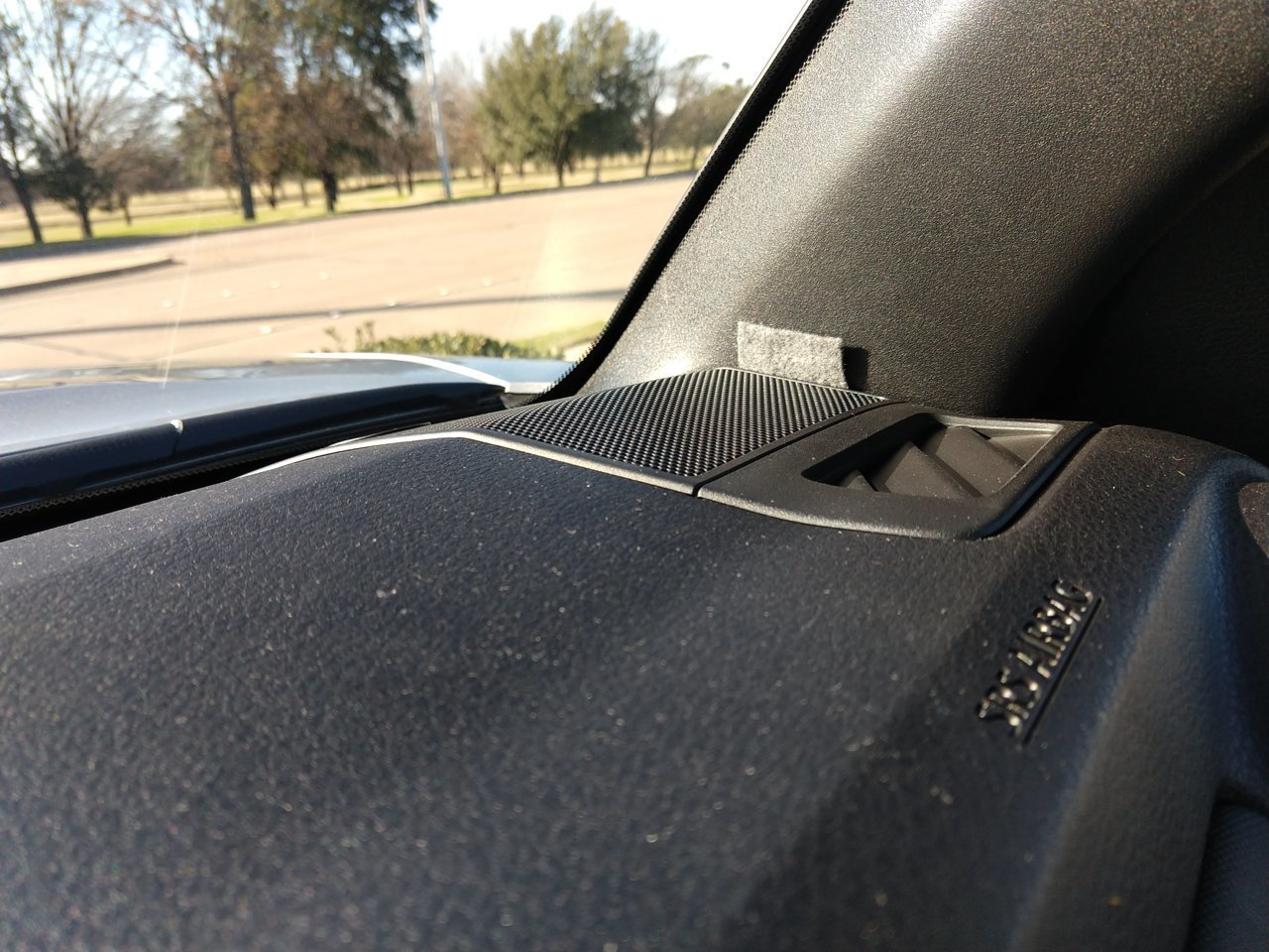

    My Dash/A pillar rattled when the temp was cold. I used some felt to cushion the gap.
    NOTE: I trimmed it after I confirmed it fixed the rattle.
    Hooper89 and hokiehunter19 like this.
