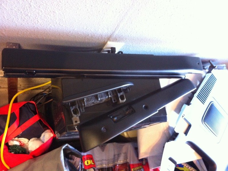

    You have to remove the door panel to get it off because there are two gold screws on the backside holding it in place also. Not just those two screws in front.
  17. Nov 19, 2012 at 11:33 AM
    #17
    Madjik_Man
    Madjik_Man The Rembrandt of Rattle Can
    Dec 2, 2009
    #26893
    19,612
    Colorado Front Range
    1998 Ext Cab 3.4 4x4 TRD 5MT, 2004 DC 3.4 4x4 TRD
    In the pic above you can see the armrest in the middle.
    There are those two large holes through those large posts. Those are where the screws, that you can access from the front, go through. These large/long screws help hold the whole panel to the door skin.
    Then you can see two smaller holes on smaller posts which are set in from those larger aforementioned ones. Those holes line up with tabs on the back of the door panel which are used by two small gold. And those two small gold screws hold the armrest to the panel. These two small gold screws can only be accessed from the rear of the door panel.
    That adhesive you see in the OP's picture holds the actual pad to the internal plastic framework (which incorporates those posts the screws go through). That adhesive fills the entire internal void and the framework is literally buried in the adhesive. If you were to pull the pad off, you'd destroy the whole assembly.
    If it was me, I'd take the 5 mintues to remove the door panel and armrest properly, fill the gap with burley adhesive/glue, and clamp it overnight.
