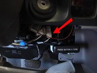

    Wow that was really hard to do.... It took me all of 5 minutes to shut that buzzer up for good. My 2000 it was the green/red, not the blue. The 04 may be blue, but here are the pics to see where the wiring is.
    SORRY ABOUT THE PICS, I FORGOT TO PUT THE CAM IN MACRO MODE......

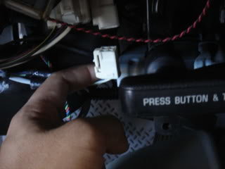

    find this...
  10. Jun 30, 2009 at 2:45 AM

    unclip it from the harness...

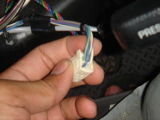

    2011 4x4 TRD Sport
    closer shot of the wires...
