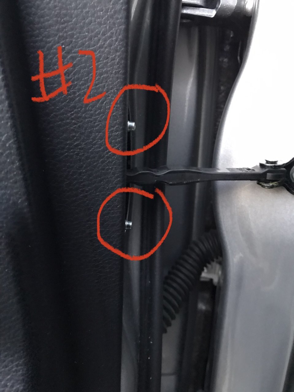

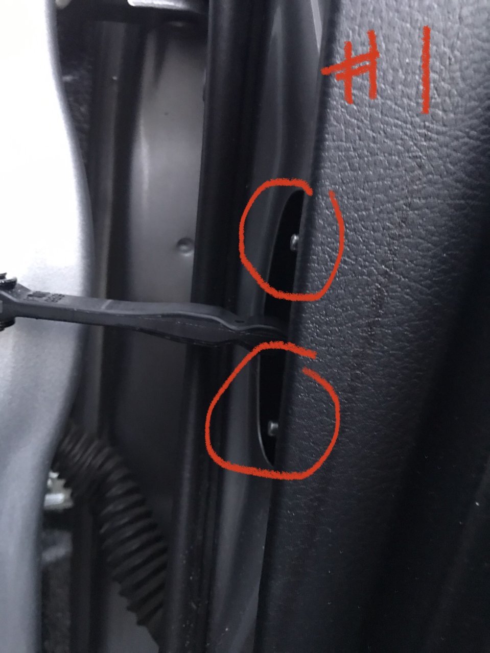

  13. Mar 6, 2023 at 2:54 PM
    Ben J
    Ben J Member
    Mar 2, 2023
    #419193
    16
    Sweet thread, man. Same exact issue on used 2018 We just bought. Just spent like 25 minutes comparing the two doors and suspected broken check arm. Checked Tacoma World and here you had it all laid out for me. Thanks, checking bolts now and will replace arm if necessary. Definitely feels like someone opened the door too far at some point… but this is a truck! Would not expect door opening to damage check arm.
    SandyTaco4x4 and Danbest82 like this.
  14. Mar 6, 2023 at 3:04 PM
    Ben J
    Ben J Member
    Mar 2, 2023
    #419193
    16
    Photo 1 Passenger side, catch arm bolts recessed… no noise
    Photo 2 Driver side, catch arm bolts not recessed, proud by a few mm or so… “clunk” a couple inches before closing
    Danbest82 likes this.
