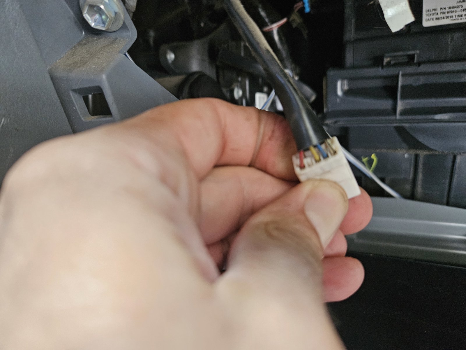

    Hey guys, I was trying to program my new key fob when I discovered that my door control receiver is missing from the truck, a 2015 4x4 base model. As far as I can find my model should have had this as standard equipment.
    My question is that if I order one from eBay, TOYOTA PN#8974104010 KEYLESS ENTRY DOOR RECEIVER will it be plug and play replacement?
    Obviously I have to program the fobs but is there any other pairing such as bringing it to the stealership to make a used one work with my VIN?
    photos of what I found (nothing but wire) and what I need below. 20240804_160452.jpg IMG_1402.jpg

    Providing its the correct part it should be plug and play aside from programming the fobs to it.

    I checked my 2014 base model and I have the white box - the same wire you're holding is plugged into it, so I'd assume a 2015 base would have it as well from the factory. Someone must have removed it.

    Thank you, Yes that’s what I think happened. The box photo is from a YouTube video. I’ve only had this rig a couple of months and it was a fleet vehicle before so it may have been removed by the company for some odd reason.

    There isn't anything to program on the Door Control Reciever, its not even on the bus and can't even talk to a scan tool.
    The only functions it has is programming/deleting fobs and a couple settings, all of which is done with key, door, and button sequences.
    If your truck is pre-wired (which it appears to be) you plug the module in and program the fobs to it. Note that since the reciever is absent the beeper may be absent as well, this won't affect the function of the system but you won't have the beep (which some people dislike anyway).

    So I installed the module and programmed the FOB per the key in/door open method and everything worked perfectly.
    You are correct about missing the wireless door lock buzzer PN 89747-AC010. I found the plug neatly tied up from the factory in the location you specified. The parking lamps blink when the doors lock and that’s enough for me.
    So if anyone wants to add keyless entry to a base model fleet vehicle that they have, it can be done.
    I’ve added cruise control, rear-view camera, intermittent wipers, and now keyless entry. Total cost about $350. On to fog lights and other mods!
