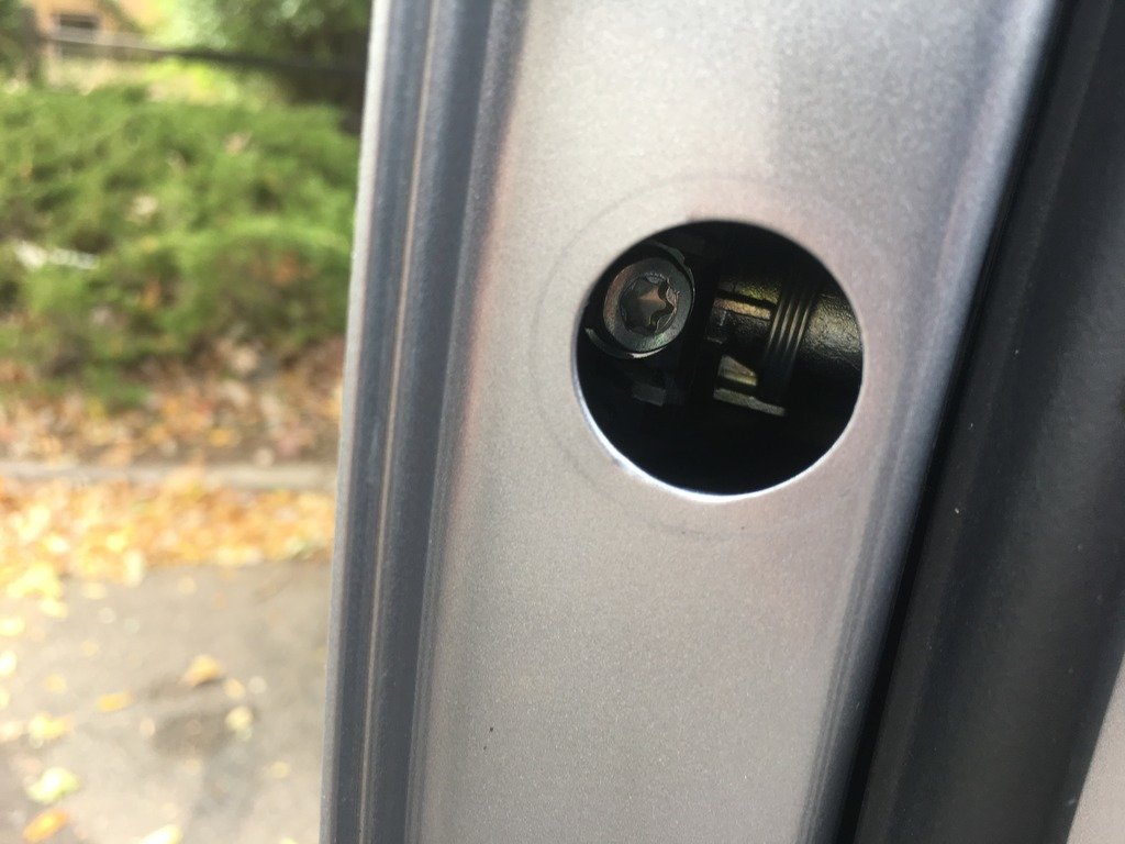

    Step 1 (front doors):
    Remove the weather protection cap to reveal the bolt that secures the handle
    You can use your fingernails to remove the cap to avoid scratching the paint with a flat-head
    Step 2 (front doors):
    Use the T-30 Torx driver to loosen the bolt
    The bolt is secured with a retainer so don't worry about losing the bolt in the door
    Step 3 (front doors):

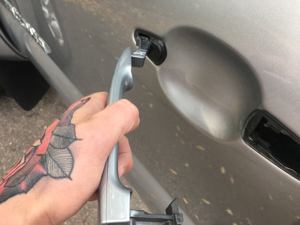

    Step 4 (front doors):

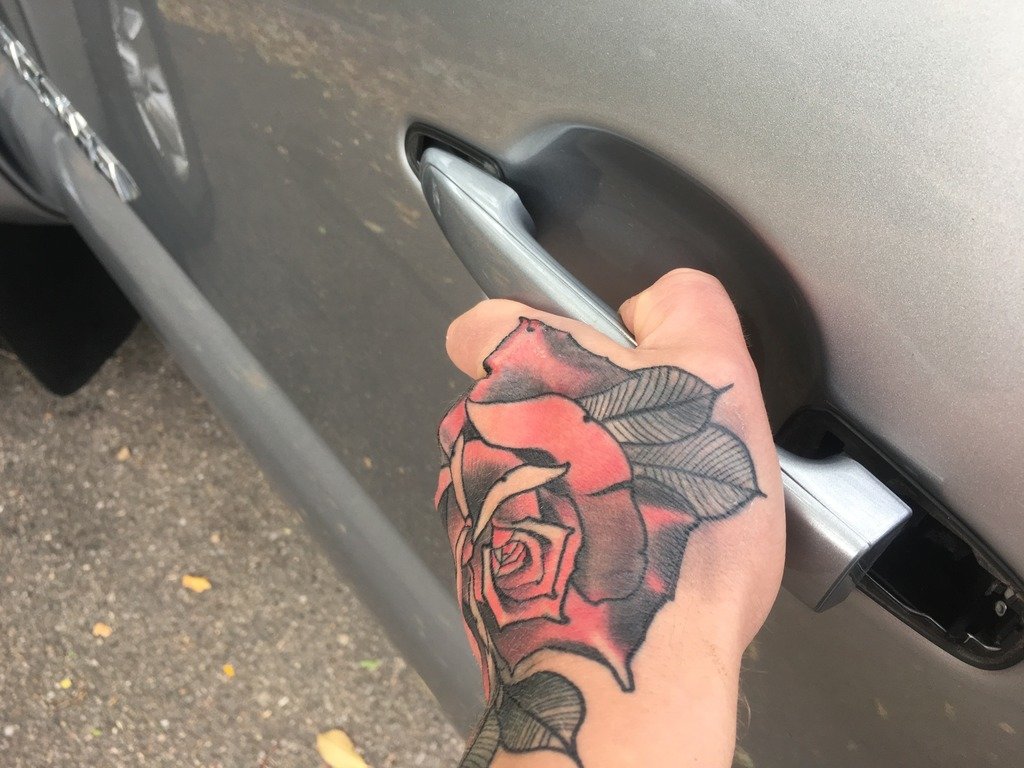

    With the cap removed, you now have room to remove the handle
    Grab the handle and with out pulling it away from the door, pull backwards
    Once the handle is pulled back (towards the rear of the truck), pull the handle away from the truck
    The handle should slide out of its holes
    (position of handle once it is pulled back)
    (position of handle once you pull away from the truck)

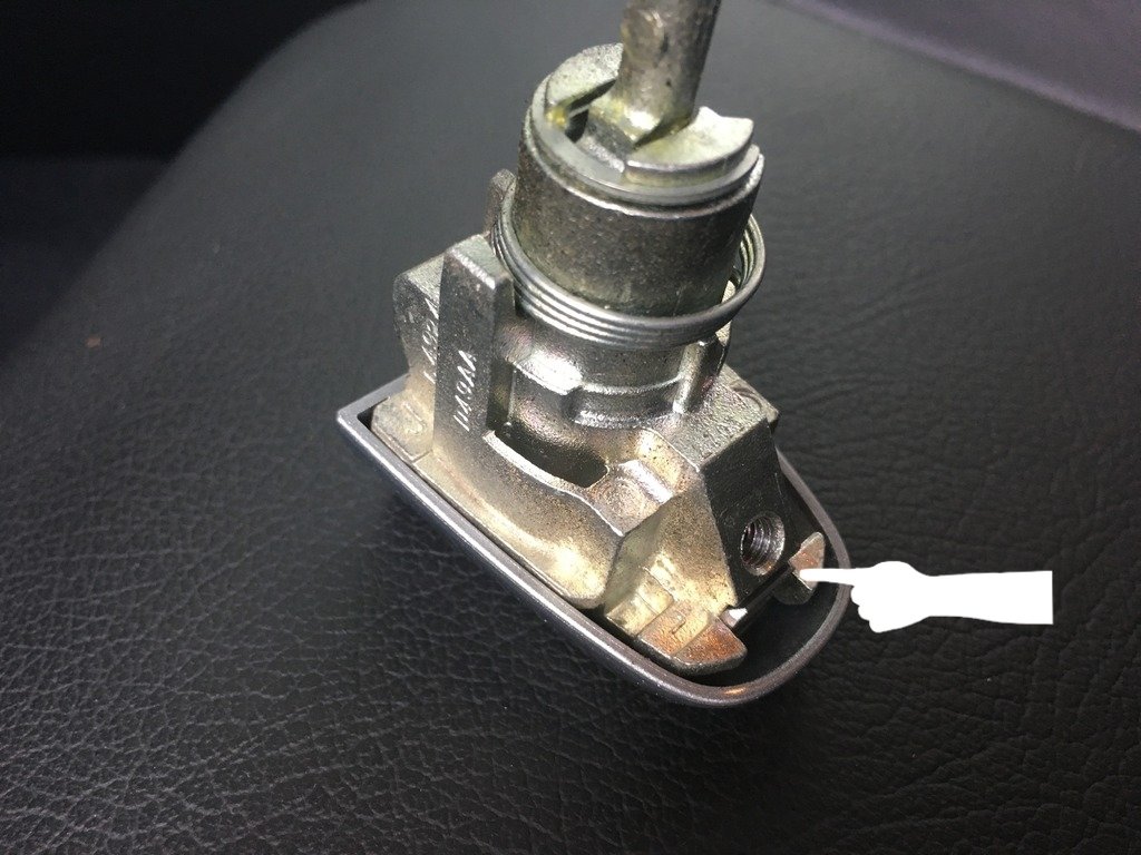

    Step 5 (front driver's side door only):
    The front driver side door's handle cap houses a locking mechanism
    If you are replacing your door handles, you will need to swap that mechanism to the new handle cap
    To remove the mechanism, simple use a flat head screwdriver to press the clip that holds the mechanism in place
    The mechanism should come free
    Putting the mechanism into the new cap is as simple as pushing it into the cap until you hear the clip click into place

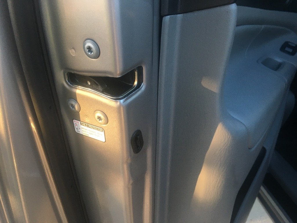

    Removal of the rear door handles is a bit more complicated but still very doable
    There is no weather protection cap on the rear doors
    To access the bolt that secures the door handle, you will need to move the locking mechanism in the door
    Step 1(rear doors):
    With the T-30 Torx emove the three bolts holding the locking mechanism in place
    If you are able to wiggle the mechanism down enough to reveal the door handle bolt by reaching into the opening, repeat steps 2-4 of the front door handle instructions
    If you are not able to move the mechanism by hand, proceed to step 2 (rear doors)

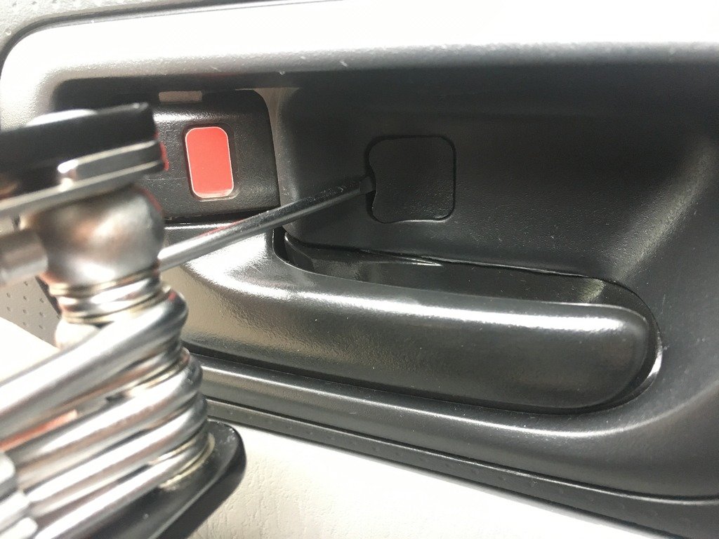

    Step 2 (rear doors):
    Use a small flat-head screwdriver to open the screw cover located behind the interior door handle
    Remove the screw using a phillips screwdriver

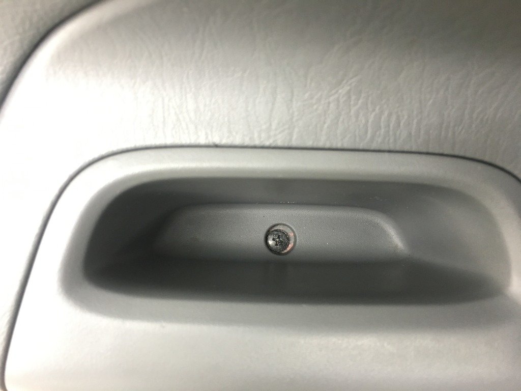

    Step 3 (rear doors):
    Use a phillips screw driver to remove the screw located in the close door assist handle
    Pull up on the close door assist handle to remove it

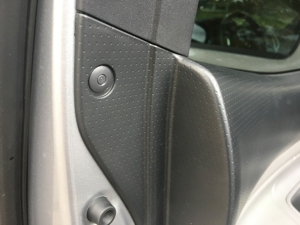

    Step 4 (rear doors):
    Use a phillips screwdriver or something similar to pop the center of the retaining clip in
    This clip is located by the rear bottom corner of the window on the door panel
    Step 5 (rear doors):
    Starting with the side closest to the front of the vehicle, pull the door panel away from the door
    You will hear the clips popping out of their holes
    Just be gentle and make sure not to pull the panel too far away from the door (there are still wire connections for the power windows attached; you do not need to detach them if you don't want to; you just need room to get your hand behind the panel)
    Step 6 (rear doors):
    (this is where it helps to have a friend hold the door panel while you work)
    Pull the clear plastic weather cover down enough so that you can reach the locking mechanism
    Be careful not to tear the weather cover or remove the adhesive keeping it attached to the door
    Move your hand into the opening and move the locking mechanism down enough to reveal the door handle bolt
    Repeat Steps 2-4 of the Front Door Instructions
