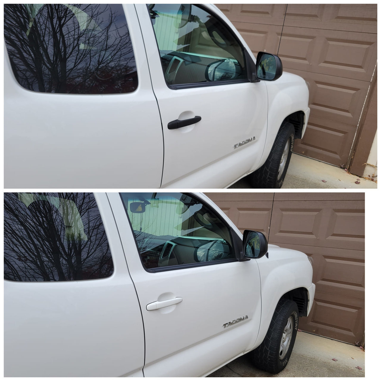

    Reply from the dead: The lock cover pops off the cylinder.
    This video shows the Tundra, but the process is the same for the front doors.
    https://www.youtube.com/watch?v=-3_MQKgXhok&ab_channel=SparksParts
    Color matched handles make a big difference to me
