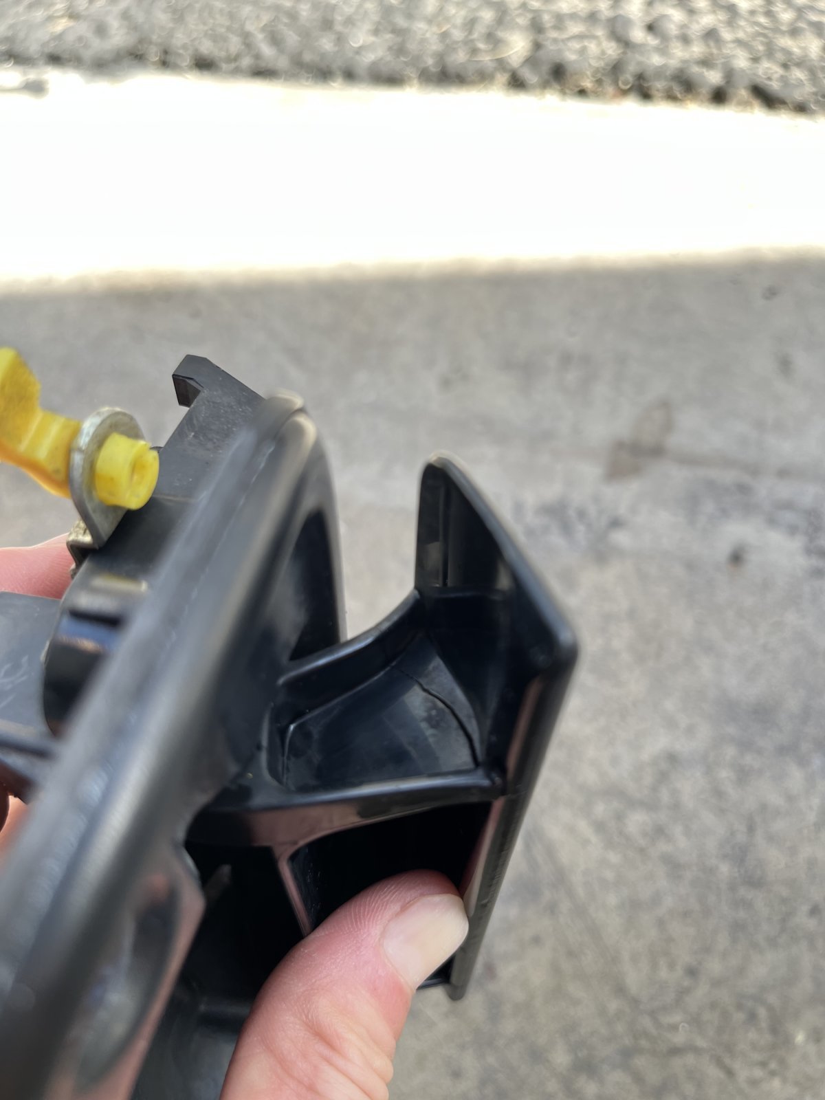

    I’ve replaced my driver’s side door handle once when some stellar human punched my lock cylinder and I learned how to replace that, as well as lubricate the linkage that’s back there. That was 2016.
    Today I wanted to remediate some very poorly opening doors due to cracked handles on both sides as well as grimey linkages.

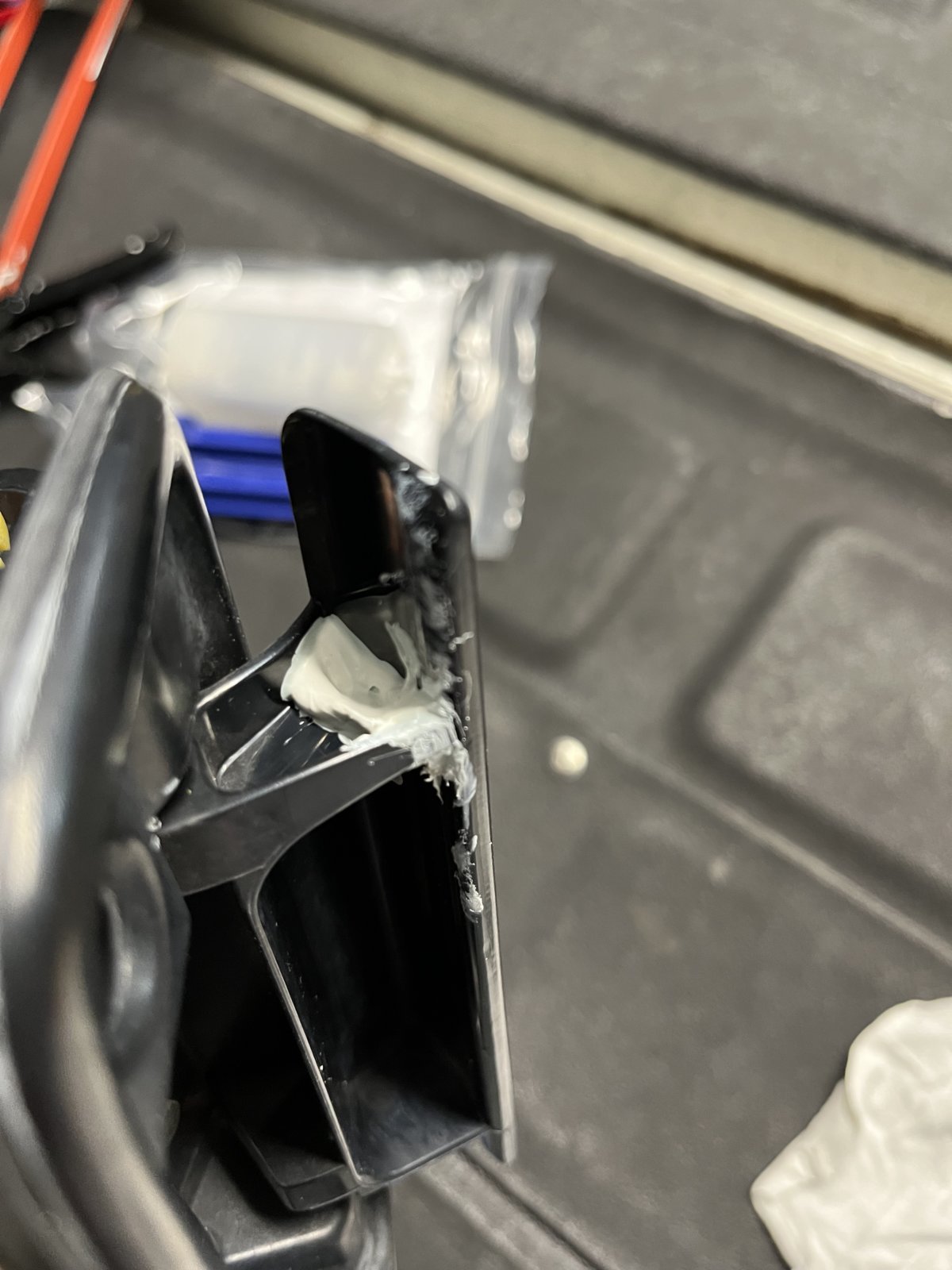

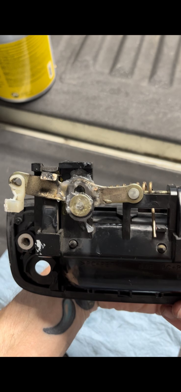

    I used a two part epoxy from work called Devcon. Cures rock solid but it mixes as a workable paste. Very useful stuff. I applied it around the cracks and inside all corners to reinforce them with more material. Cleaned both handles and applied fresh grease. Maybe too much, dunno. Sprayed some silicone grease on the inner linkage and also hand applied grease to pivot points I could reach.
    Both doors open like new again. Massive quality of life improvement.
    I can sell this Devcon to anyone that might need a high quality two part epoxy.
    It’s meant for hot tubs and chlorinated water exposure 24/7 so it’s robust stuff. I was able to apply it enough but also make it not visible unless I happen to be looking up at my door handle from below grade - unlikely.
