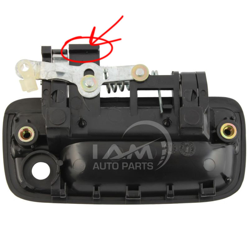

    Any member out there hand luck with Non OEM or Dorman replacements?
    Both my Dorman replacements are around a year old and neither of them work correctly. Drivers door only opens when you completely lift the handle. Passenger door does that false open requiring another unlock from the door lock to open.
    EDIT: I do realize it may not be the handle but the small clips in the door actuator arms behind the door skin. Anybody source those plastic clips?

    @eon_blue has had good luck with his Dorman replacement. He lubed it up real good with silicone grease or PTFE lube or something. He even mentioned the typical part of handle that breaks looks to be more substantial on the Dorman. No experience personally
    OneWheelPeel[QUOTED] likes this.

    I had multiple OEM handles break on me and the all failed on the circled part of this photo....the Dorman handles I installed have a bigger lip there to engage the handle. The smaller OEM one would start to slip there and cause the door to not open.
    The handles on our trucks are shitty in more ways than one so it really depends on what kind of issues you're having with them, but for me the Dorman handles are much better. Mine have lasted over a year so far with no issues, I daily my truck and use them often
    EDIT- just realized I circled the wrong part, its the smaller lip to the left of the circle that presses down on the metal there.
