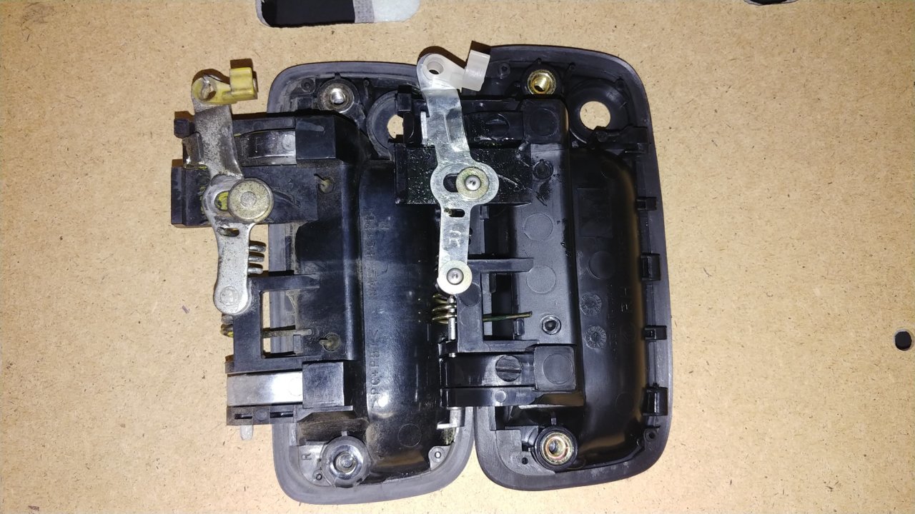

    I recently replaced my perfectly working OEM door handles. I wanted to go from chrome to all black. So I had the chance to have both side by side. I read about a half dozen posts on here about how the aftermarket door handles will break, and people should spend $130 on the OE ones.
    I realize it's not the best foto, but I inspected both in hand and I could not see any meaningful difference between the two. I had expected to JB Weld parts that were thinner (as suggested by another post) but without breaking out the calipers I saw no thin parts.
    I got a PAIR of handles for $14!
    https://amazon.com/gp/product/B0030F2O7E/
    I don't see the value in spending $130 on them.
    I wanted to emphasize that I do believe other's suggestions that the problem with broken handles isn't entirely with the quality of the handles, but the lack of lubrication of the the door latch and associated linkages. I removed my handle, latch, and lock mechanism from the door, degreased it all, and sprayed every part (including the nylon bushings) with white lithium grease. Despite not having any problems before hand, it's amazing how easily everything moves now.

  18. Oct 4, 2019 at 1:25 PM
    #58
    eon_blue
    Mar 4, 2016
    #180213
    69,834
    Azusa, CA
    Curious to know how those Amazon ones hold up, I got mine off Amazon too but they are Dorman brand (about $15 each).
    Been almost 2 years now since I switched to Dorman handles and haven't broken one since...I'm usually an OEM guy through and through but when it comes to door handles, I'm sold on Dorman. I had half a dozen OEM failures and these Dormans have lasted me a long time now, comparatively.

  20. Oct 6, 2019 at 10:25 AM
    #60
    cruiserguy
    cruiserguy Well-Known Member
    Jul 31, 2016
    #193416
    19,000
    Elijah
    SEKS
    2000 ext cab, 2.7L, auto, 4x4
    Great post man, appreciate the side by side comparo and the pic. This is good to know stuff. I think in past posts I might've read that someone had the original and an 'equal' aftermarket one break on them. I think he said that he thought one of the tab areas where a pressure spring thing resides was weaker material or something, not necessarily different size. Crap I really don't memba. I could be way off
