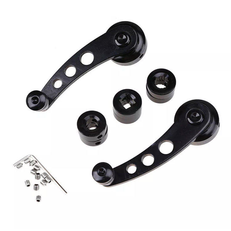

    I finally got my new exterior handle installed. The initial failure was due to being frozen. Once it thawed out I was able to use it another couple of weeks before a complete snap off of the handle.
    Being naive for years as to what the plastic lining was for I always peeled that crap off every time I put in door speakers or for whatever reason I had the door panels off. Every vehicle since my first. After realizing it was a barrier I used the plastic shower curtain a few months back and it’s made a big difference with interior dust and overall maintaining a constant temp as well. I feel like an idiot.
    I also snapped a window crank about 8 months back. I replaced both with some aluminum/Chinesium universal fitting cranks. They work well for maybe a week before the set screws work loose and they fall off. So I used Blue LocTite and that lasted a month or so before the main, and single, set screw worked loose on the splined crank. The pot aluminum apparently wallowed out from use and caused the cranks to nearly fall off again. After managing to get the blue LocTited set screws out I got at the splined portion and decided 2-part epoxy was my choice of cursing in a couple of months. I applied some to the splines and to the universal piece. Installed it and red LocTite on that set screw. Waited 10 minutes and installed the rest with blue. Today it’s solid as can be and only time will tell. But I do not suggest these cranks as a replacement for anyone.
