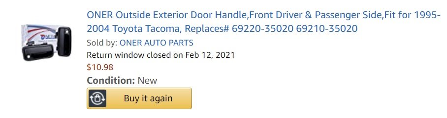

    Just received mine today. I came looking for a review but I guess we'll have to wait and see. I expect these to outlast the plastic ones. I also expect the paint to wear off of them, which may be why they are available in chrome, as well as why they weren't metal to begin with.
  6. May 29, 2021 at 5:17 AM
    #86
    Five
    Five Well-Known Member
    Aug 11, 2020
    #337286
    90
    The plastic ones are utter carp. I bought a pair because the metal ones were not in stock for a while. I plan on keeping the plastic ones on a for short while and swap out with metal ones.
