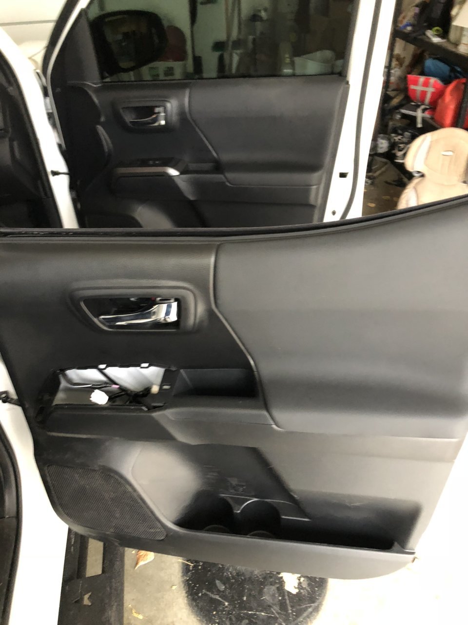

    Had time to mess with it today and taking out the screws as if you were going to take the panel off and then just pulling in the middle I was able to get it open enough to fix my mistake.
    Tried the pulling the door handle really far deal, but that didn’t work.
    Just above the handle and to the right in the image.
