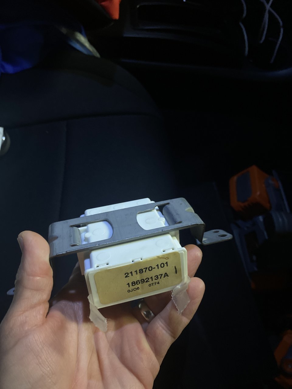

    I have a 2014 2.7 2wd Automatic AC base model. With rear camera harness up to the tailgate handle/no camera,
    Power door locks no keyless entry. I looked behind my glovebox to see if I had a door lock control module, nope.
    Just assumed the white pigtail connector that was there, was for the DLCM , assumed wrong. So when the used OEM DLCM came in the mail today, it didn’t plug in. That pigtail ended up plugging into a little black box that was connected to the plastic piece I had to remove after the glove box, not really sure what it does. Does anyone know if I were to swap out my main harness behind the dash will do the job, or do I need to swap out my door harnesses and actuators too , if I already have have power locks.
    I read up on a TW thread that was written a few years back we’re a guy did the whole Shabang, $500, weeks of labor and months of looking for the right parts , he did it. But that’s money and really time I just don’t have. I’m pretty sure he didn’t have power locks. But if it’s just the main harness, I’m pretty sure I can pull it off in a weekend, plus that will be the only part I would need, now that I have the DLCM and key fob.
    Any help will be greatly appreciated!
    Mahalo!

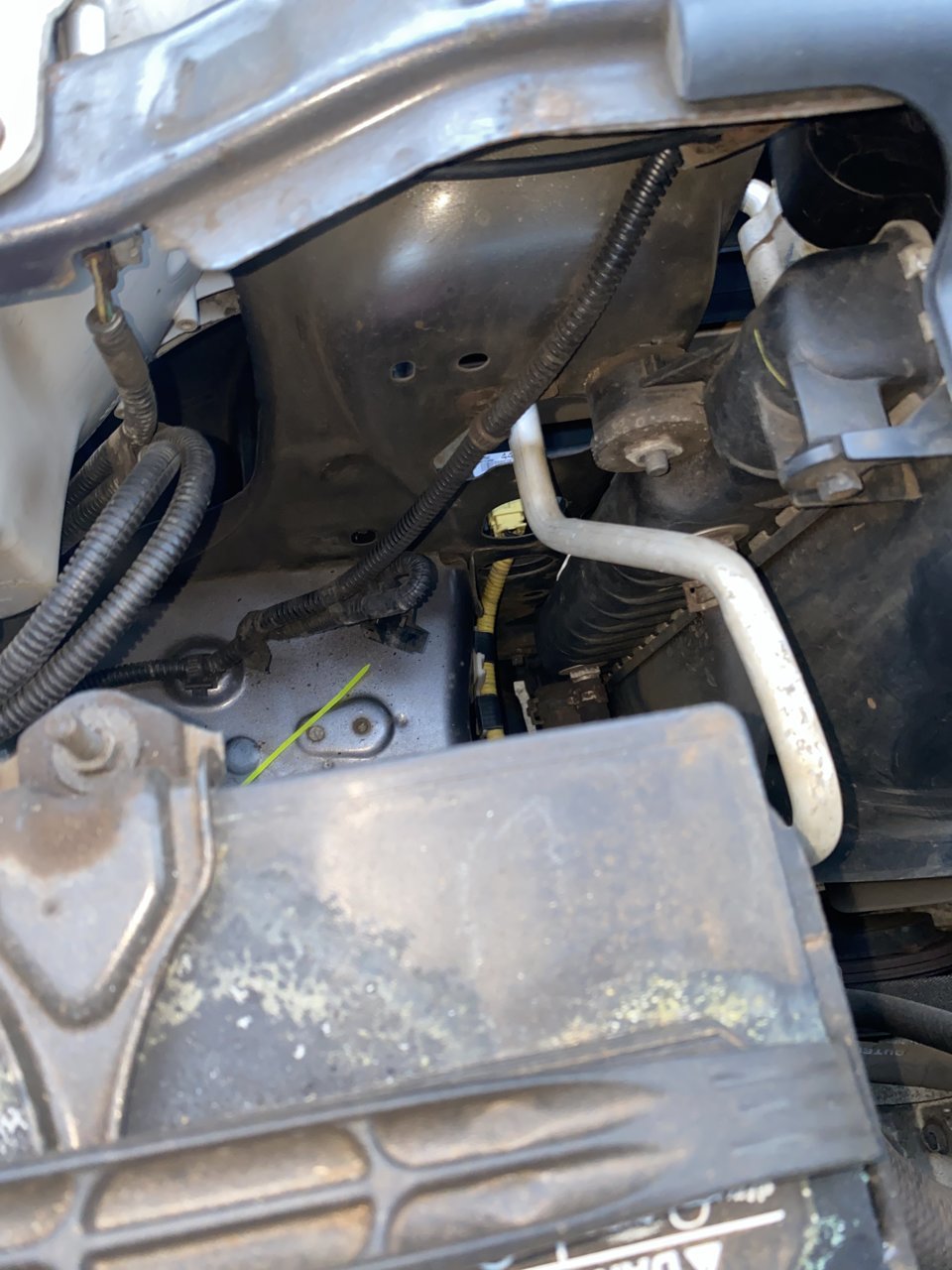

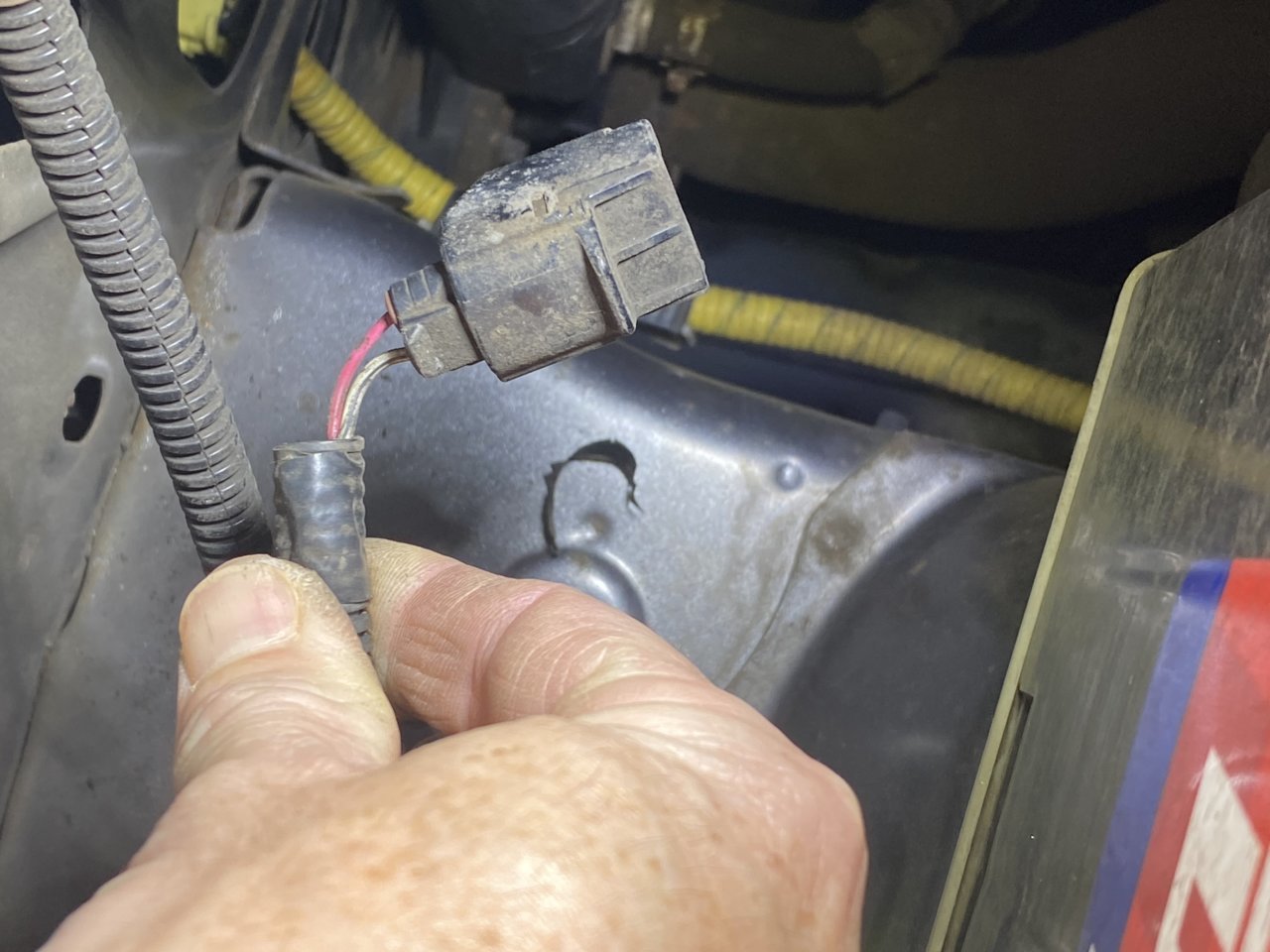

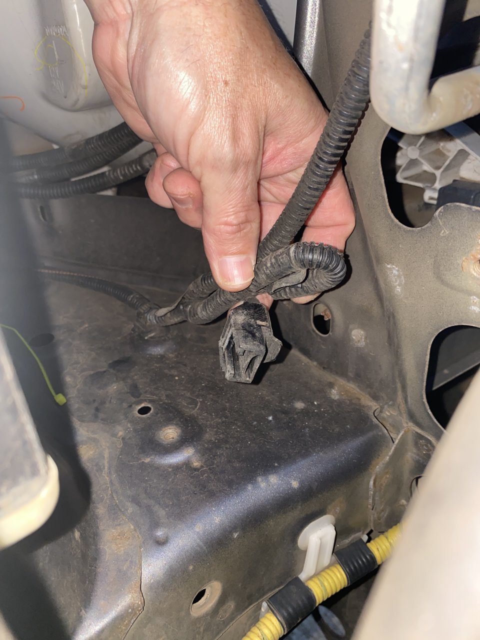

    Check this out @Dm93! From the looks on all the Pics I’ve seen on TW this looks like the wiring for the beep/cherp mechanism part#89747, it would be awesome if the pigtail for the DLCM would be in the dash! image.jpgimage.jpg

    The beeper is located on the radiator support in front of the battery.

    Nice definitely looks like it, beeper wire colors are Red and Black/White.

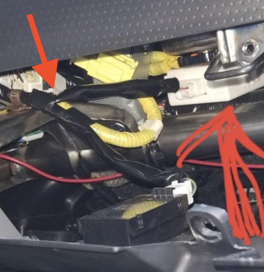

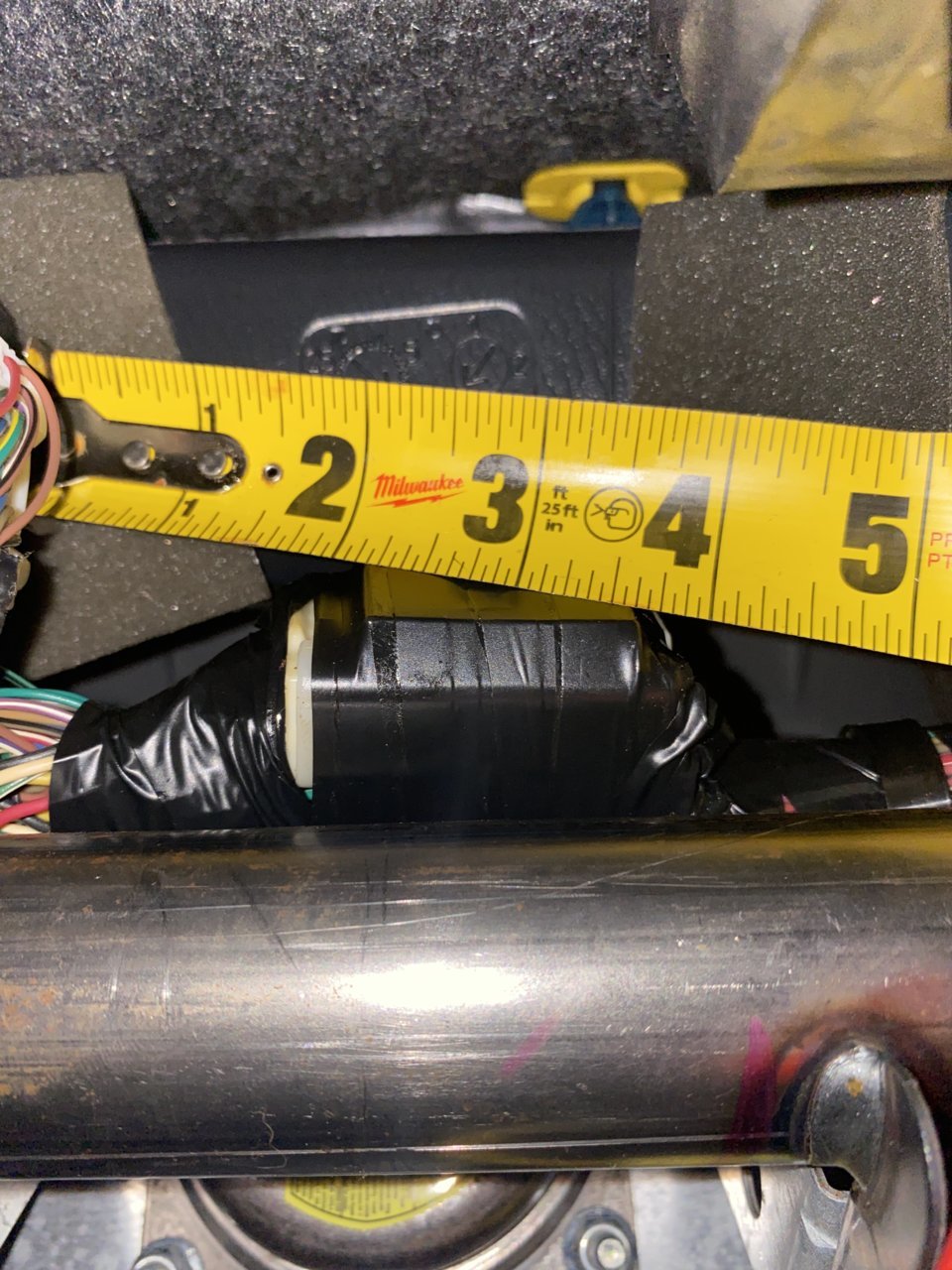

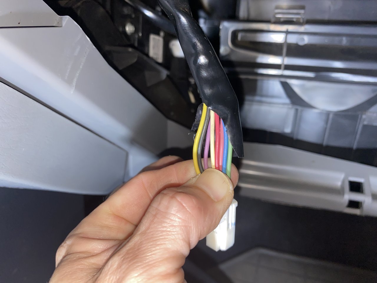

    @Dm93 wow that wiring diagram is awesome! Yup beep is red, white/black this is what I am looking at behind the glovebox, the white pigtail connects to 86516-28030 some kind of radio setting condenser. When I took out the glovebox for the first time, that pigtail was floating there , giving me the impression that this was the pigtail I was looking for! Pfft!CDAB2427-EAC3-4B5B-B7F3-2F9C510F325D.jpg 2248C548-2CAA-4BEF-B9C1-441E4B8037FA.jpg 7C58B04F-5C80-4579-8C2B-11002F586124.jpg
  10. Jun 1, 2022 at 10:43 PM
    808takoama
    808takoama [OP] Active Member
    Nov 10, 2021
    #381840

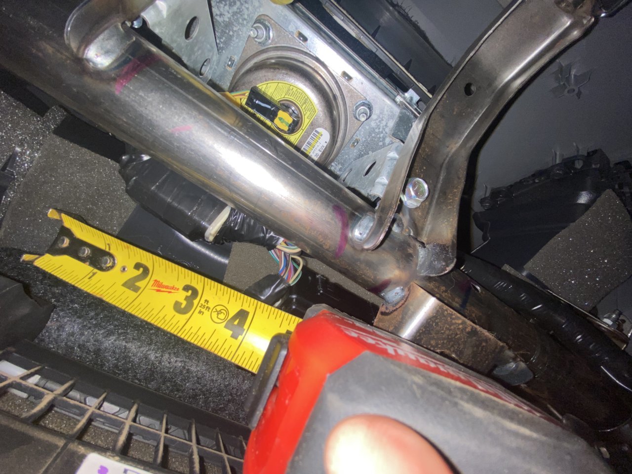

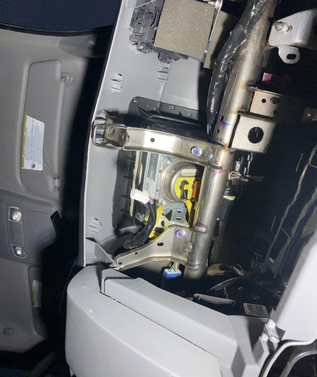

    26
    96 Tacoma

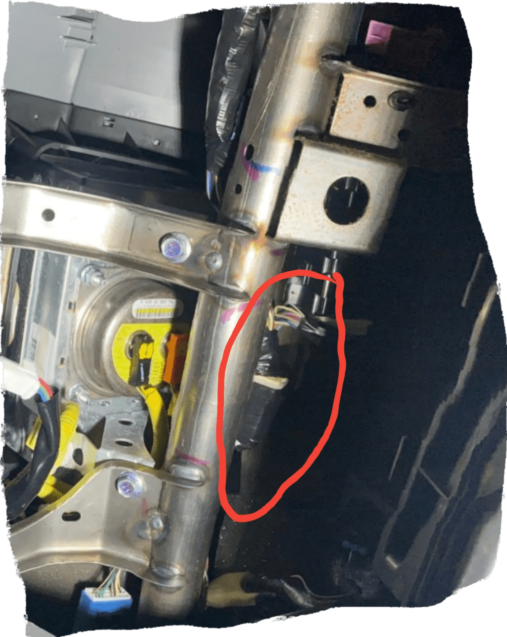

    88A540AB-8DBA-48B7-BC1D-7F65E15BFCBD.jpg D2F21CD8-9251-4F9C-B9DB-34FF417E5F3D.jpg
    couple different pano shots of the glovebox from the floor mats looking up

    Texas
    2014 DC OR 6spd 4x4
    Predator tube steps, Ranch Hand grill guard, Magnaflow CatBack exhaust, Toyota tool box & bed mat, 2LO Module by @Up2NoGood, Rearview Compass/Temp Mirror, Tune by @JustDSM.
    I see something here but I can't really tell if its anything or not, if I get time tomorrow I'll look how the harness is routed on mine.

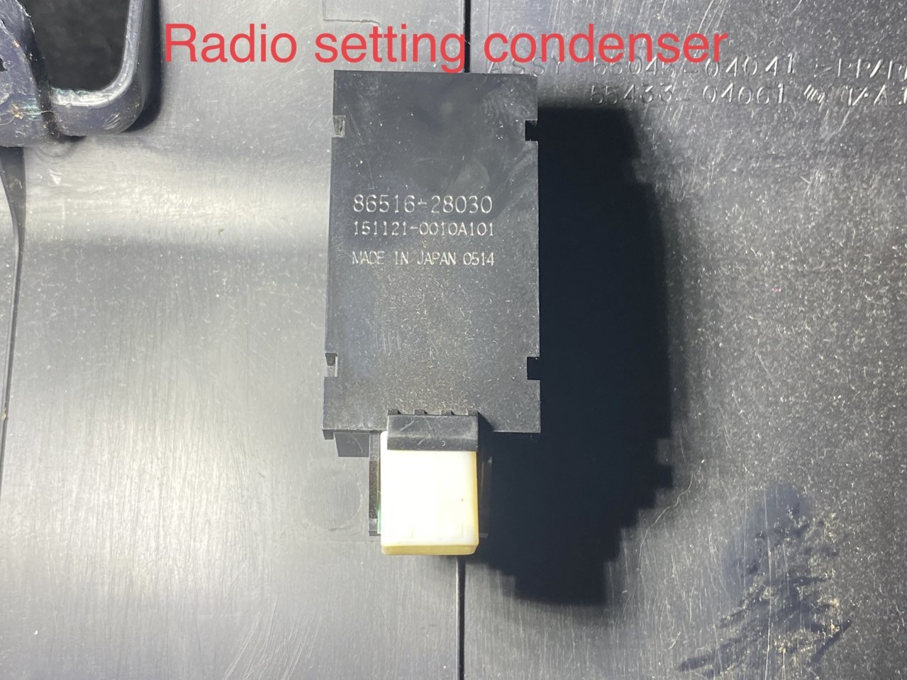

    Hey @Dm93 i just noticed that the color schematics you gave me for the DLCM are in the same loom as the radio setting condenser
    Except for the white/black, probably why most pics I’ve seen the pigtail is branching off of this loomB14924D8-5310-4924-958B-990822111E25.jpg

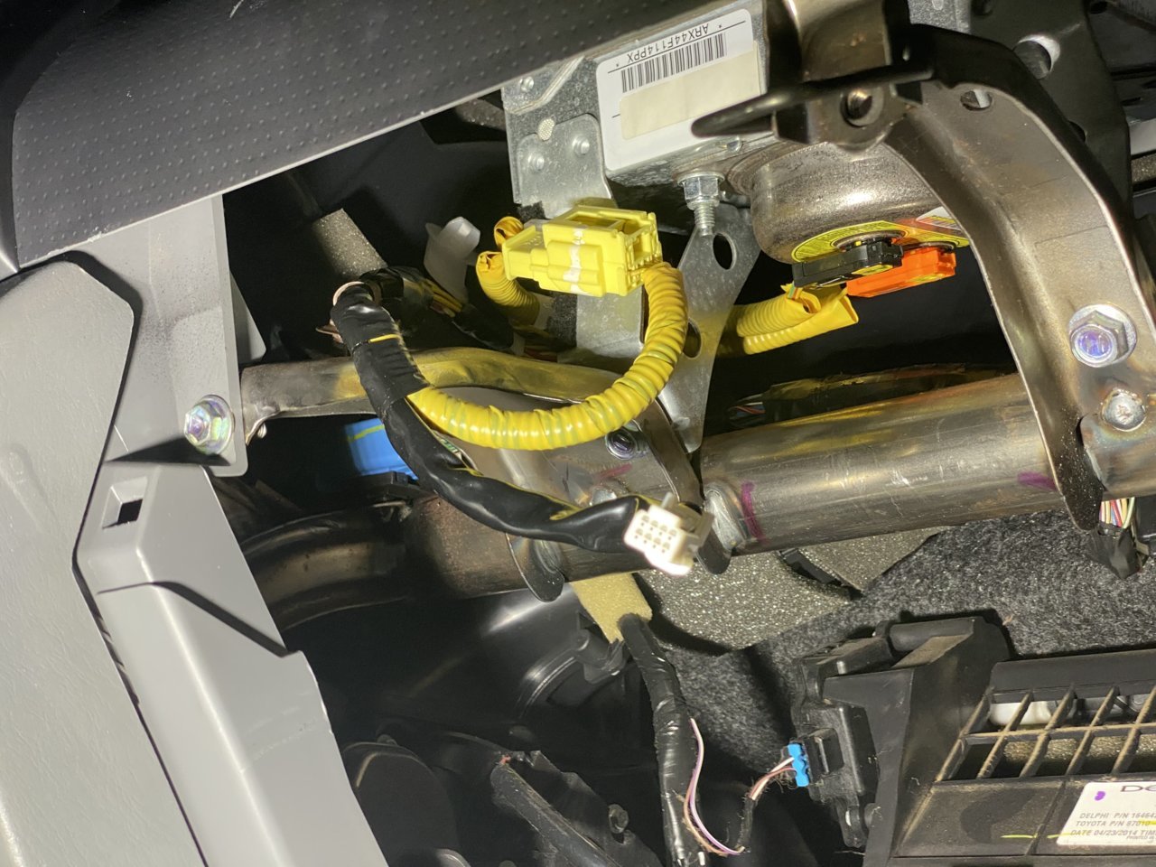

    96 Tacoma

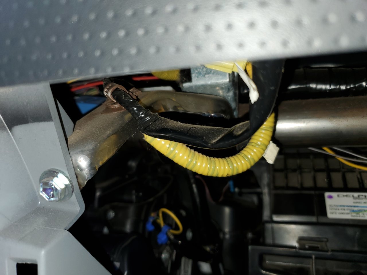

    I seen that guy earlier, I’m thinking it’s a larger connector, that harnesses more then
    5-6 wiresimage.jpgimage.jpg sorry if they are crappy pics, I’m solo , literally had to fold to a pretzel to take this pic lol
    I was able to open up tape to get a better pic of the tapped connector 60541741-3187-4ADC-AEE9-9F14261D2128.jpg shucks, not what I was looking for…

    26
    96 Tacoma

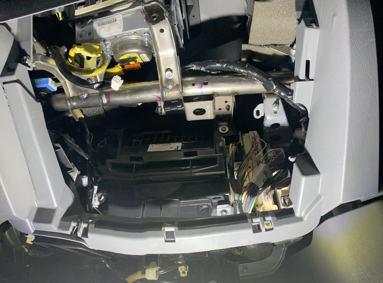

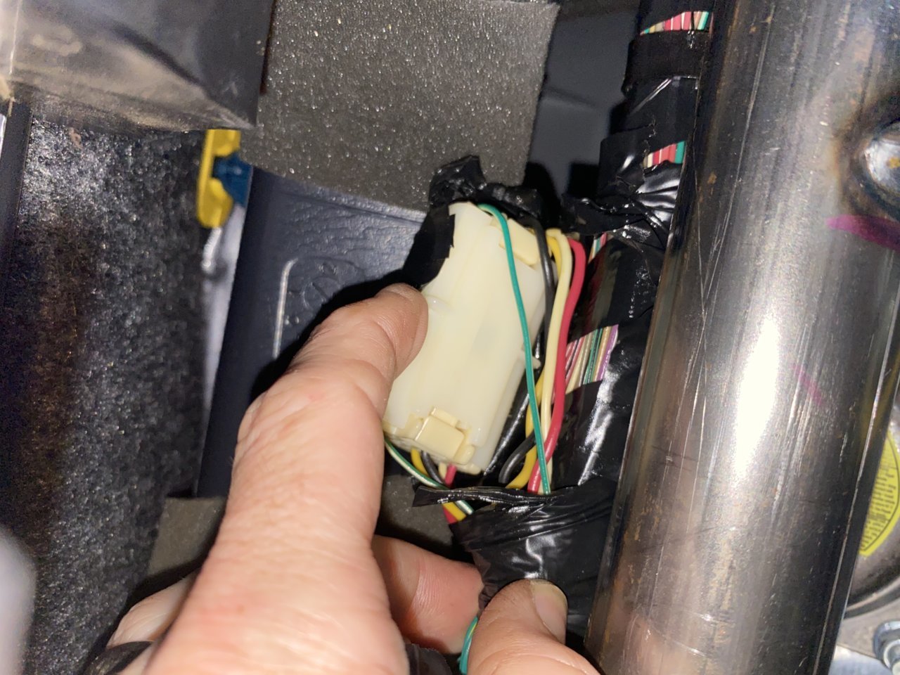

    759DDC7B-026A-4361-A44E-A983B84124DD.jpg @Dm93 after getting a better look at the pic you sent earlier, looks like the pigtail should be attached to this loom of wires.
    I even took the radio out to get a better look inside the dash, and still no luck

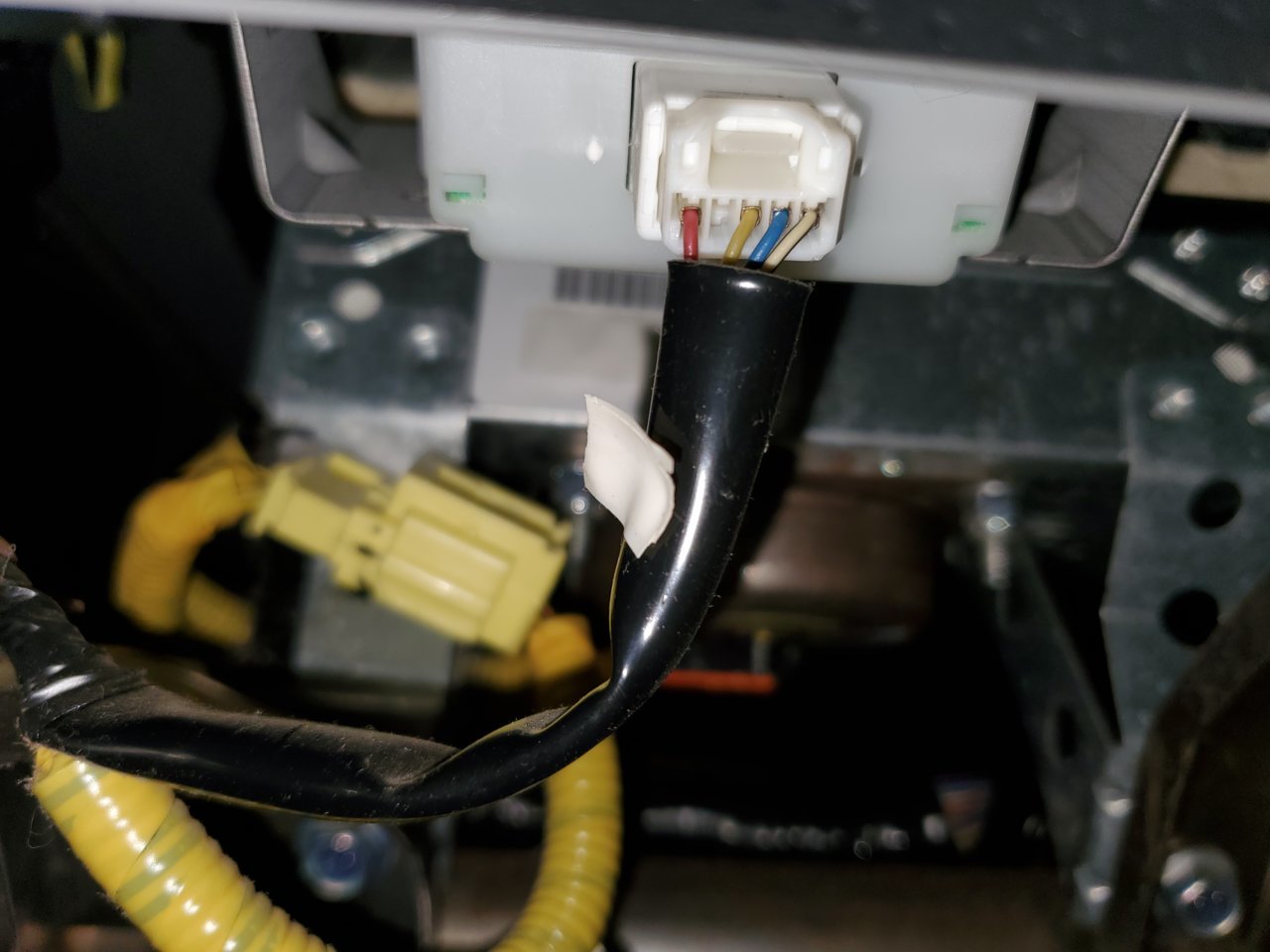

    2014 DC OR 6spd 4x4
    Just looked at mine, it appears that plug should come out of the harness so it would seem yours is indeed not there. 16542134845587170002233043150210.jpg 16542135182855352722603970956450.jpg

    @Dm93 that is an awesome shot of the wire format for the plug, yup I went to the weee hours of the night last night, hoping, it go wrapped up in the loom before or after it’s designated exit spot, but I couldn’t find anything. So if it doesn’t pop up, I’ll have to try and tap in somewhere, hoping the cpu is programmed for the part. From the looks of the red and white/black wire, they are tied in somehow with the beep/chirp wires . I’m not that good at mapping wire diagrams but I’ll try my best to see if those wires Coincide with each other. Thanks for your help @Dm93, what would be your next step in this situation?
