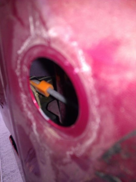

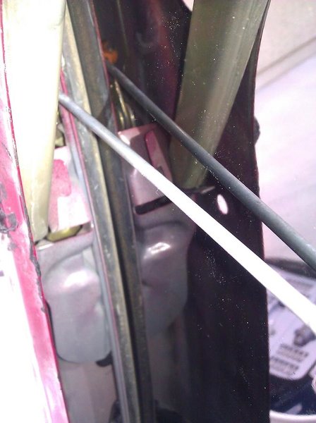

    Thanks for your help. I finally have got around to working on repairing this door lock actuator and cylinder this weekend.
    I got in there and got to the step before replacing the actuator and hit a few snags. First, that orange clip that holds the rod is difficult to remove! I couldnt fit my hands through the available spaces and/or through the quarter sized hole to remove it. I didnt want to pull on the rod too hard and break the orange clip! Any suggestions?
    Also, once I have the rod off, it seemed like the doorlock actuator is behind a lot of sheet metal from the door and is difficult to get to. I removed the hex screws from the door frame holding the actuator in place but how do you get the old mechanism out of there and the new one in?
    Here are some pics I took for illustration:
