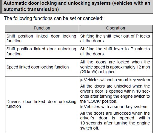

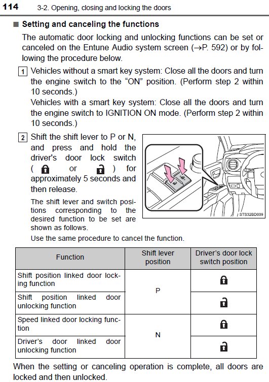

    ok...my 2019 tacoma SR has that function when you park your truck or put it in drive....it opens and locks your doors! trying to turn that feature off!
    "my radio doesnt give me the options to disable it"
    any other ways to do this! besides going to the dealer?

    ok...got it....yea ;0) hold button only 5 secs... if you hold it longer doesnt respond. once you get it right , release the button... doors will lock and unlock automatically....letting you know your done..now when you place in park, doors stay locked..
    btw....if you dont get it right the first time, turn truck off and back to ignition on.
