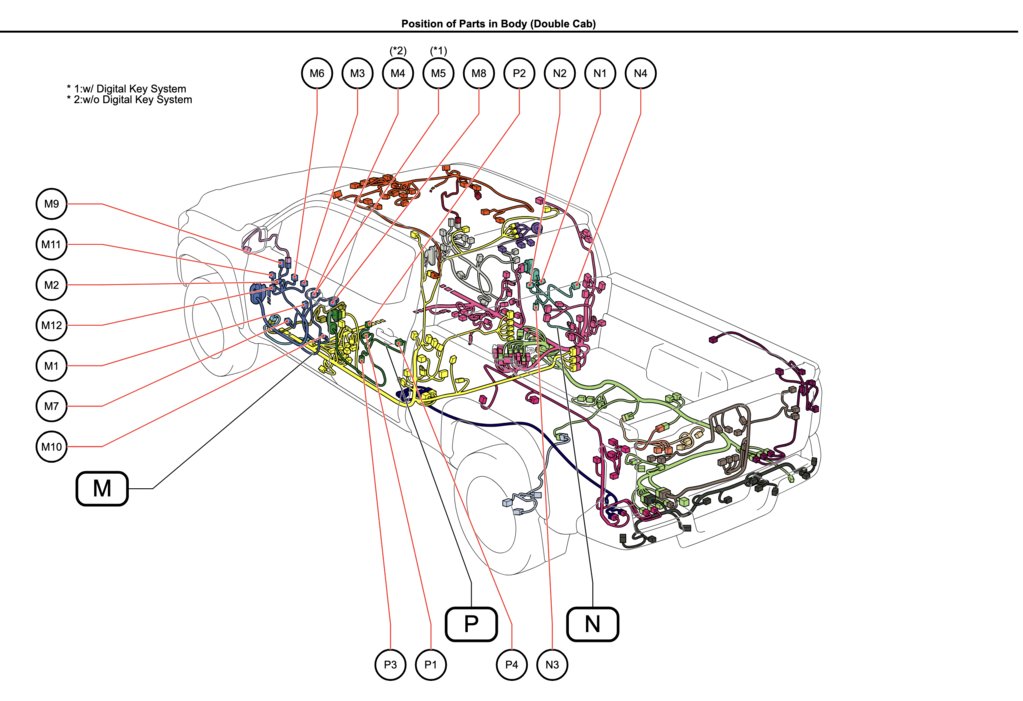

    Note: for some reason the javascript seems broken when I click on the links for the connectors nothing happens. But I did find the location & connector types for L8 / P4:
    But I'm unable to find the wiring diagram showing which controller they are connected to, which fuse, and colors of the wires? Would be great to be able to just pull up the door sill panel and splice in there without having to remove the entire door panel to get access to the P4/M8 connector.

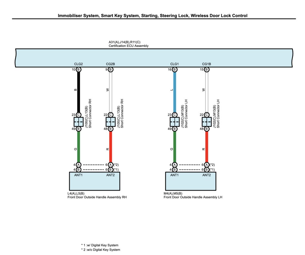

    The closest I found to the actual locks was the antenna's in the door handles:
