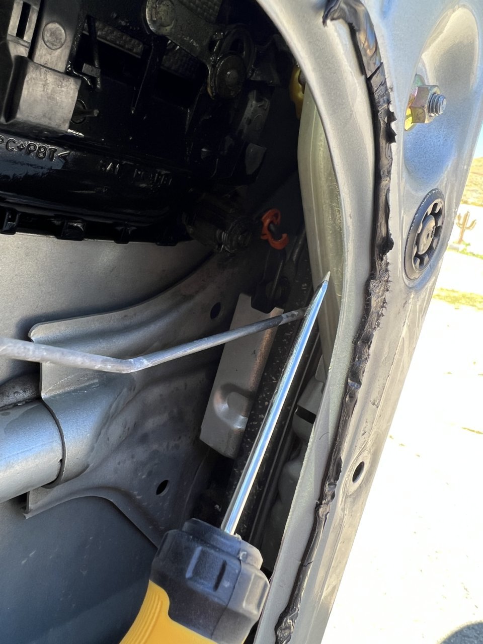

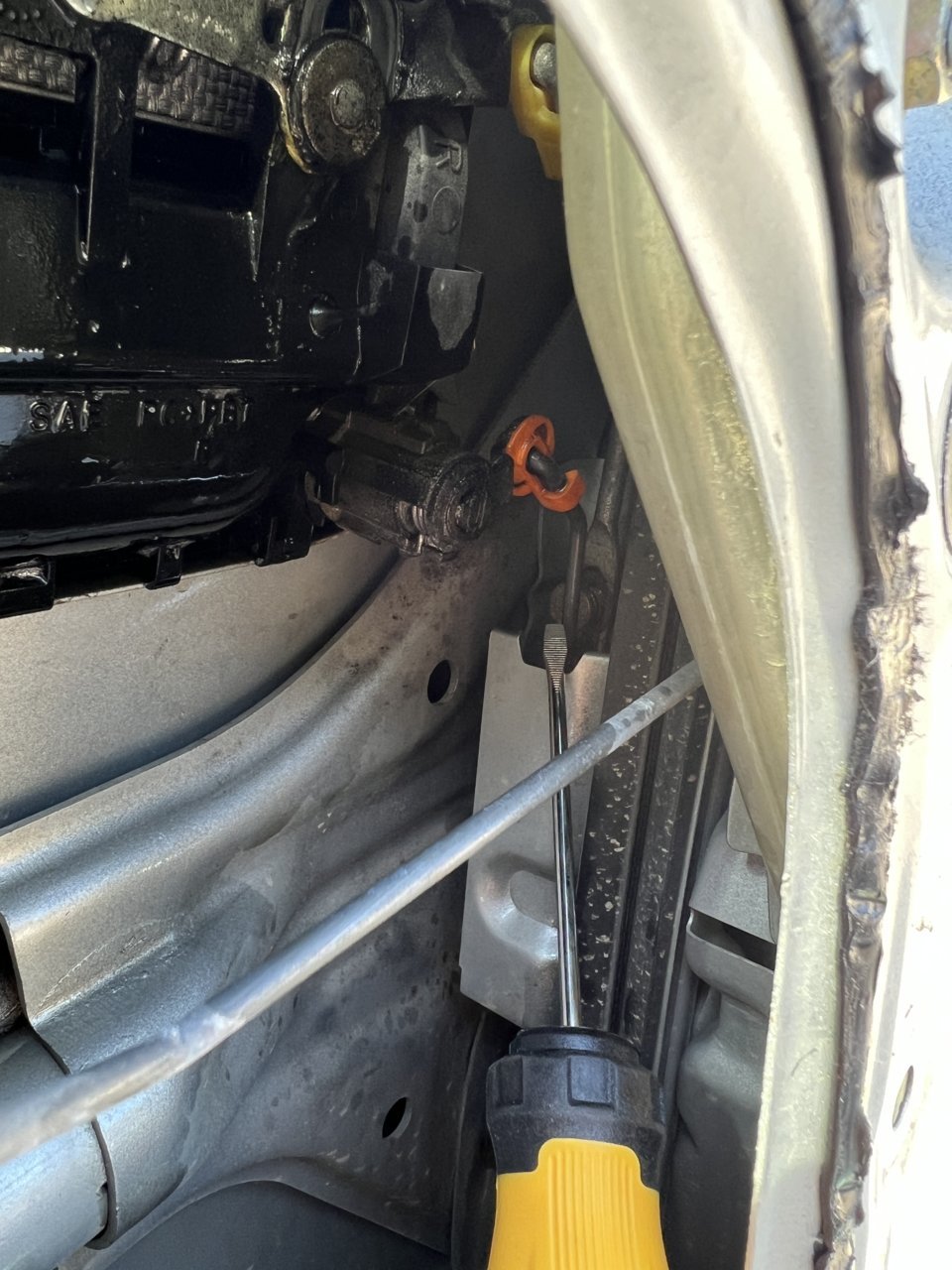

    Hey everyone,
    I had this same issue too. Just needed to give it some WD40.
    Here's a quick write up:

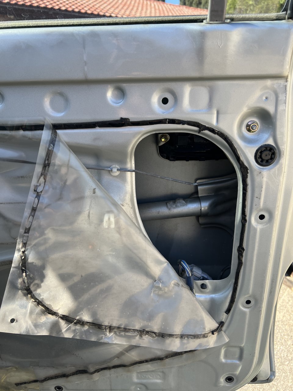

    I used this YouTube video to take off the door panel. From there I pulled the liner off to expose the door handle and the locking assembly.
    I followed the tube that contains the lock rod and it leads to the area with the orange clip. Feel free to reach in there with one hand and then start unlocking/locking the door with the inside lock and you'll feel the mechanical assembly moving.

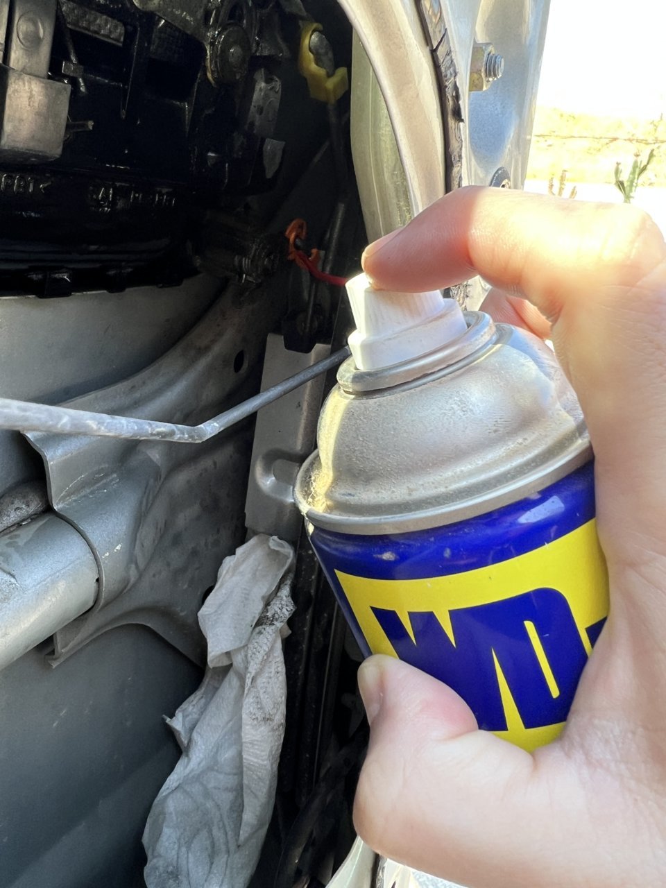

    I got the WD40 and started spraying in that general area ensuring that everything in there got lubrication. I also placed a paper towel to get the residual WD40 that'll be flowing down.
    I sprayed other components that moved as well since I was already in there and to hopefully spare any future headache. Once done, test by pulling the outside door handle and hopefully it fixes your issue.
    Reassemble once complete and you'll be good to go.

    I’m just popping in here to say that WD-40 isn’t lube… I’ll let myself out now.
