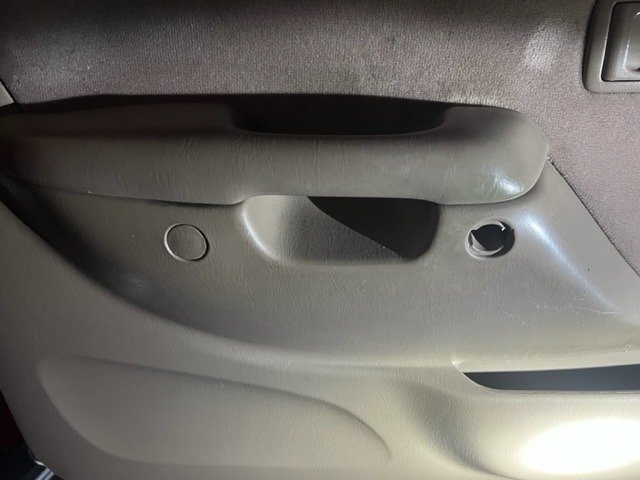

    Does anyone have any idea on the part number or name for the circular plastic pieces on either side of the door pull for my '03 Tacoma ? Have tried ordering online and the parts I receive are not correct. Thanks

    OEM Part Numbers:
    67772-04030-B0 Cap, Front Door Trim Retainer (CHARCOAL)
    67772-04030-E0 Cap, Front Door Trim Retainer (OAK)

    Many Thanks for your help. Parts have been ordered.
