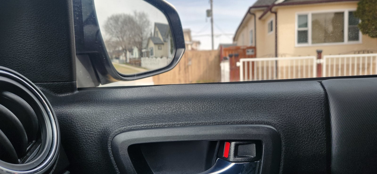

    IMG_4319.jpg It must be a manufacturer defect mine is ever so slightly on the passenger and driver door. It’s not enough for concern but I will be watching to see if it gets worse with time.

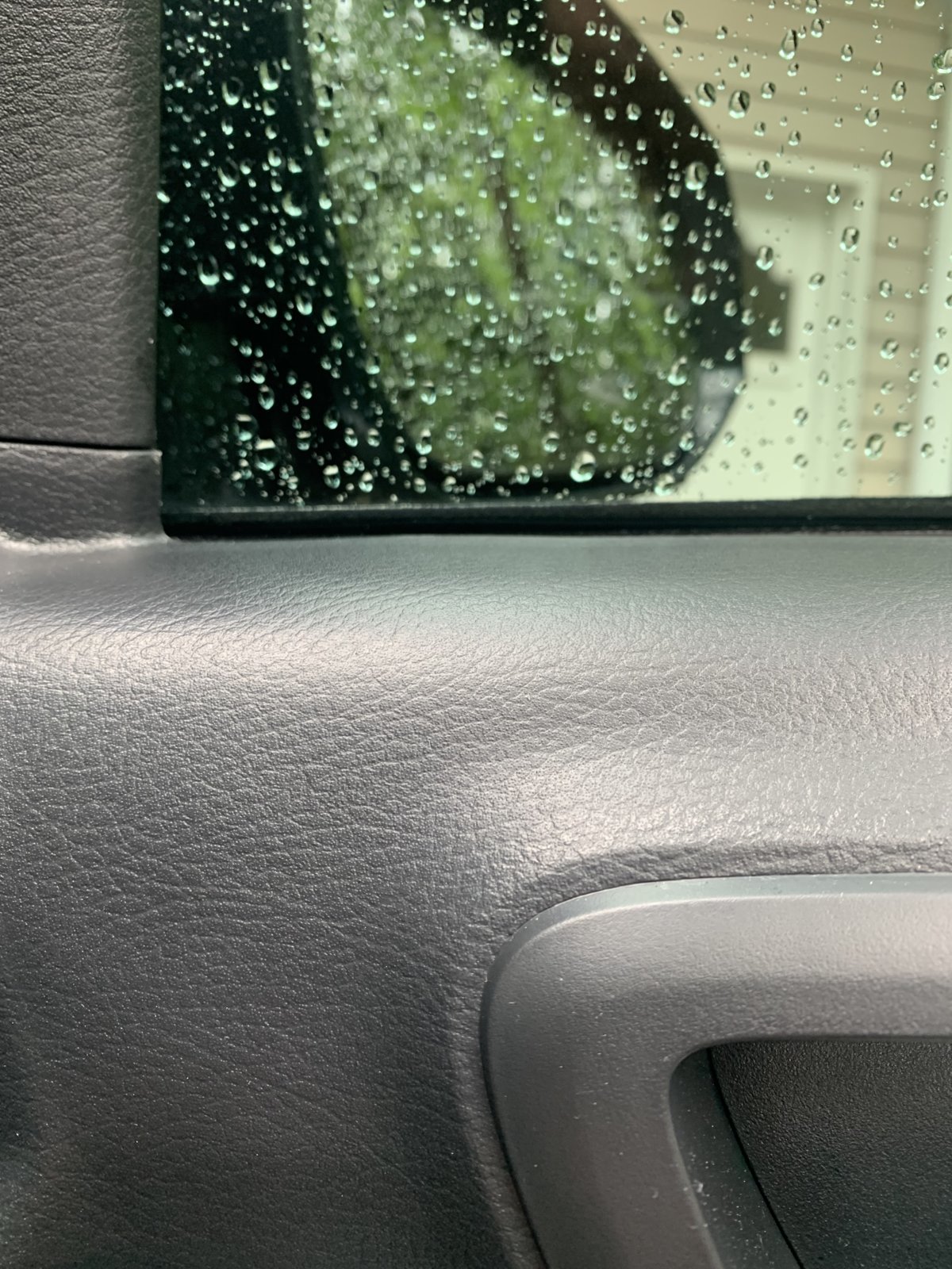

    Double checked my drivers door and it seemed to have a littlr warpage similar to yours but not enough to bother me as much as the passenger side..

    Both of my doors are about the same as long as they never get any worse I will be good. As far as your passenger door I would feel as you do and have Toyota make it right I am sure the only fix is to replace the door panel.

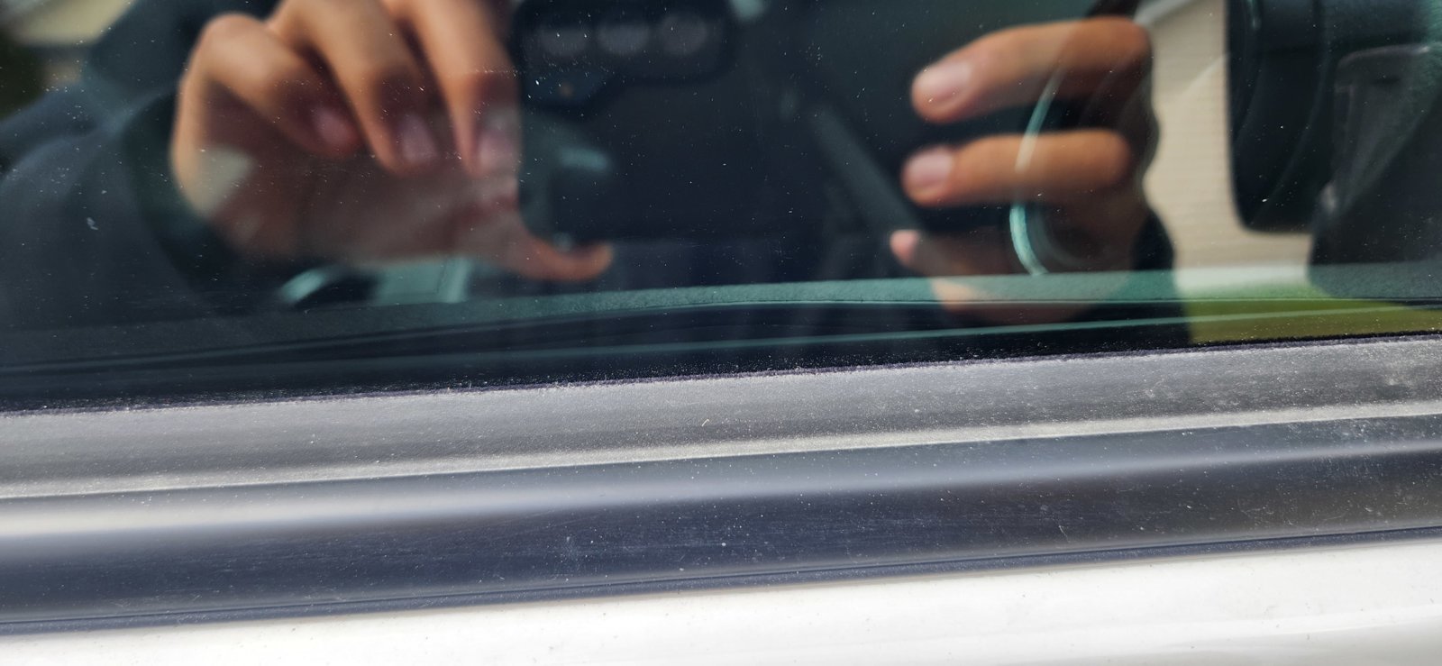

    Update - Service manager noticed that it was not seated where it was to supposed to sit and he popped it back in place. Popped back in place pretty close to the driver side but just needs time for the plastic to conform back to its shape. Probably put heater on max and aim on the panel and massage. It does not have the huge gap anymore.
