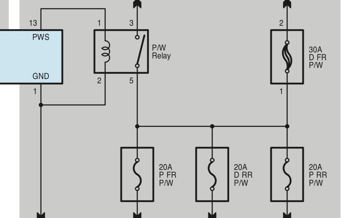

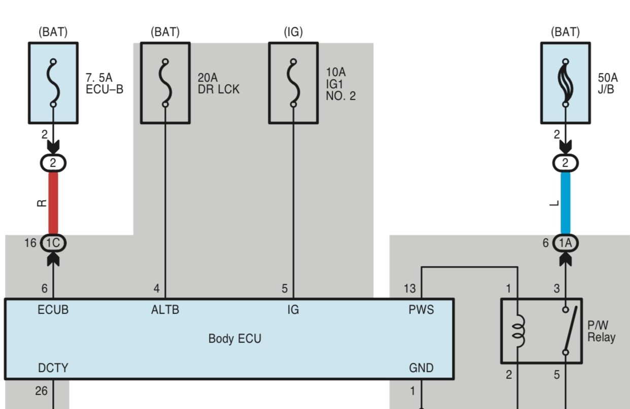

    I read it as 'it worked' (not 'it still works') with the old door wiring. But in any case, there may well be differences in '12 and '10-down wiring. I only have an '05-'06 wiring manual, and an '05 truck to look at. However these are just wires and switches, not like a can bus or whatever, so there's no 'training' or 'learning' required for the ecu. Either a bunch of wires aren't connected, making lots of things not work, or two wires are connected in a way that is wrong, which has made a fuse blow (or maybe messed up the body ecu but I would be surprised there.)
    Here are the complete diagrams for the '05 windows and doors. As you can see the power for all window motors is routed through the switch assembly in the drivers door. Testing the fuses and then for voltages at key points is where I'd start, because it's way easier than swapping doors or harnesses.
    Here are things that would help with diagnosis:
    -Are all the fuses good?
    -Does the passenger door lock button still work?
    -Does either door lock actually move, e.g., with the key fob?
    -Do any other power things work in the new door, e.g., the mirrors, speakers, or the window button lights? (in my car, the "auto" on the driver window switch lights up at night)
    A set of diagrams for a '12 would also help. Good luck!
