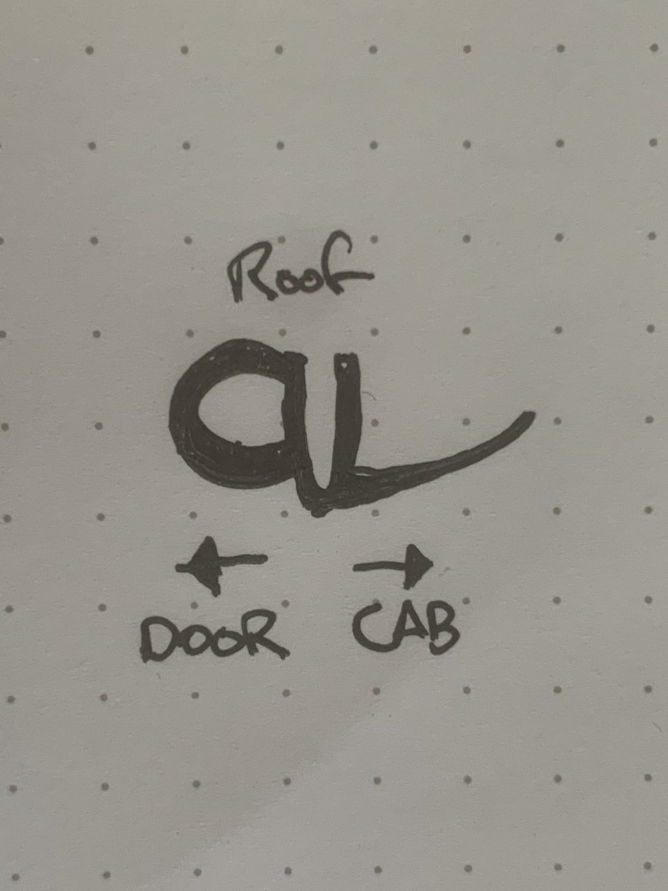

    @Rastopher
    I took some pics of the seal that's on the truck so I could use it as reference while looking on line. Darned if I know what folder they are in & I was using them not long ago, like last week. Anyway, I thought I had narrowed the other seal down, but now I'm not sure cuz I don't have the pic. See what I can do tomorrow, or rather later today, I'm glad to have you working on this as well, I kept getting stuck & shelving it. Thank you!
    Rastopher likes this.

    Best I can tell, there are no universal types that fit the profile. Some would probably work, but it wouldn't cover the seam between the door sill and the headliner. I'll post a drawing of what the cross-section looks like.
    I did notice that the OEM 2nd gen seals are a third of the price, and seem to be very similar. I'm going to ask my neighbor if I can take a look and measure the seal on his 2nd gen. If it looks like its close enough to be adapted, I'll probably buy one and see if I can make it work. If i do, I'll update here.

    Your best bet to find a similar cross section is to look at other Toyota models built in the same years. The door weatherstrips are extruded parts. If a supplier can just extrude different lengths for diff models, and cut and fuse them for different vehicles, that's a really good thing. So, designers will try to commonize the cross section when possible to lower part costs to Toyota.
    To get the correct length, you might end up using two weatherstrips from a vehicle with a smaller door opening. But having a joint in say one of the vertical sections, would not be so bad. Silicone caulk could be used to join them together.
