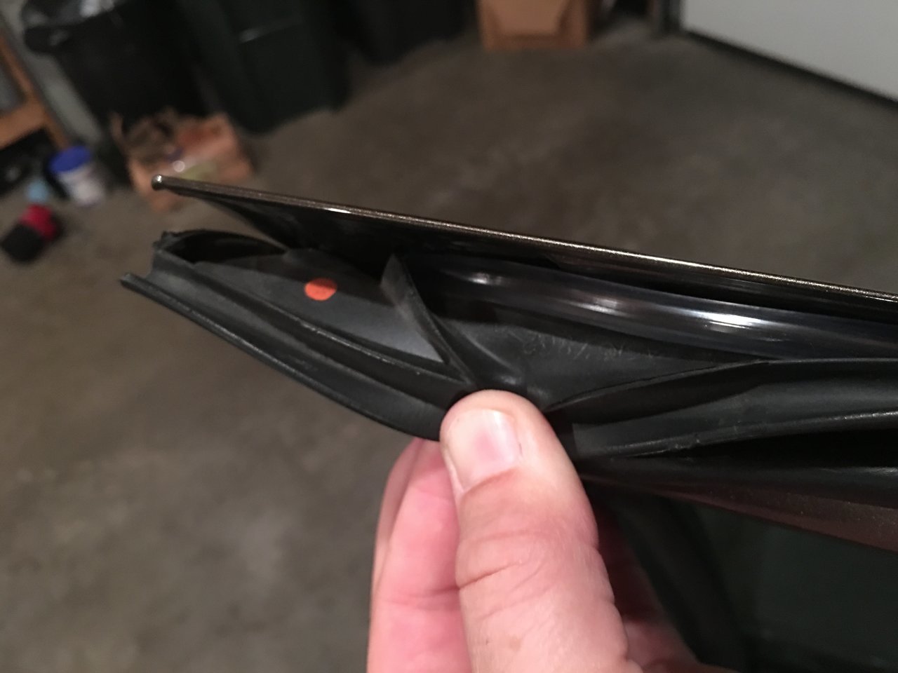

    I can try and find it. Basically you take something like 1/4" tubing and stick it between the weather stripping along the top of the door. The extra pressure prevents the seal from squealing.

    I came up with the fix that toyota now uses on the TSB door seals, ever since i did it i have been kazoo free (almost 4 years now).
    hardware store, 3 bucks for 1/4in dripper pipe 50ft roll, cut 3 pieces that run the length of the front and top of the door and put the 3 pieces in each of the folds (you can actually get away with 2 on the inner most and outer most fold not the center)..... 5 min of your time and 3 bucks.... cost more in gas and time to go through the dealership which puts on seals with the same exact fix.

    This is what I'm gonna do. I'd rather do this than try and deal with the dealership.

    I went down to lowes and bought a 20' roll of 1/4" clear tubing for $5. Put it between the door seal and door frame. Now I just need a windy day to see if it works.

    It occurs on my 2014 AC. I used the 1/4" drip line fix. It works but a real TSB fix would be ideal.

    Are yall actually sliding the thing INSIDE the OEM gasket?
    Or just behind it...Thanks yall​
