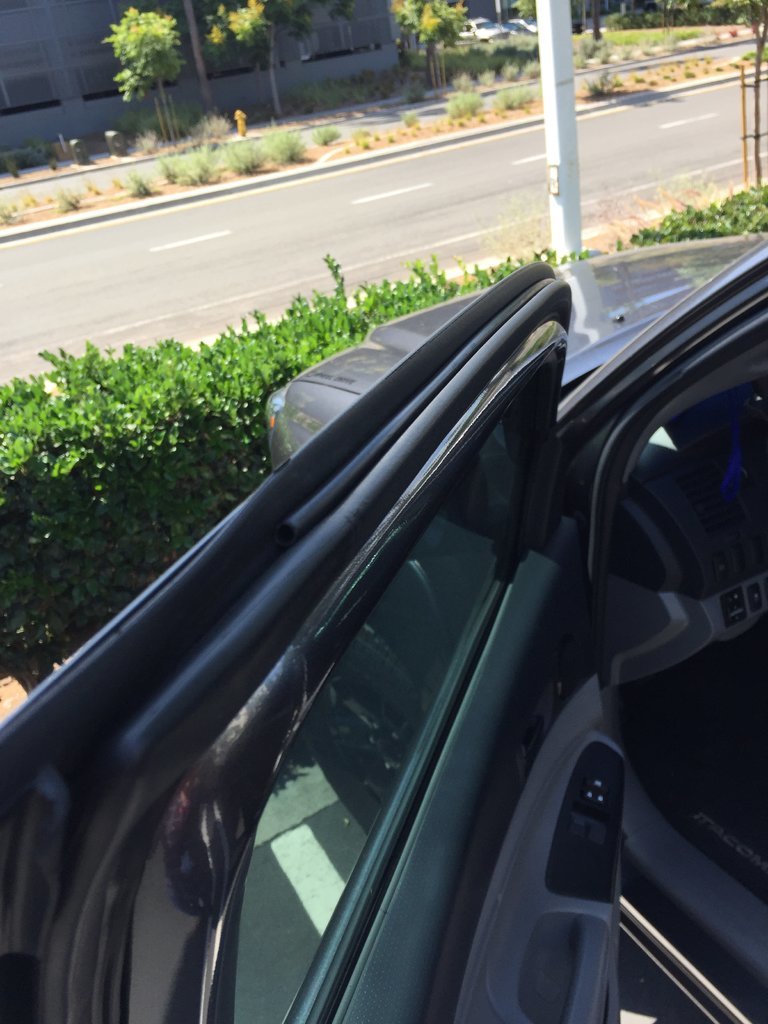

    No, i placed the drip line just in between the two flaps. I can take a pic shortly.

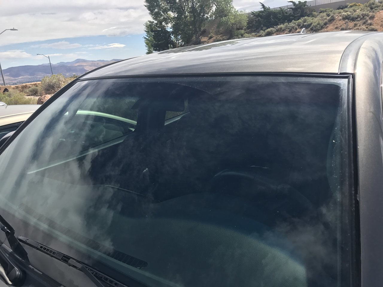

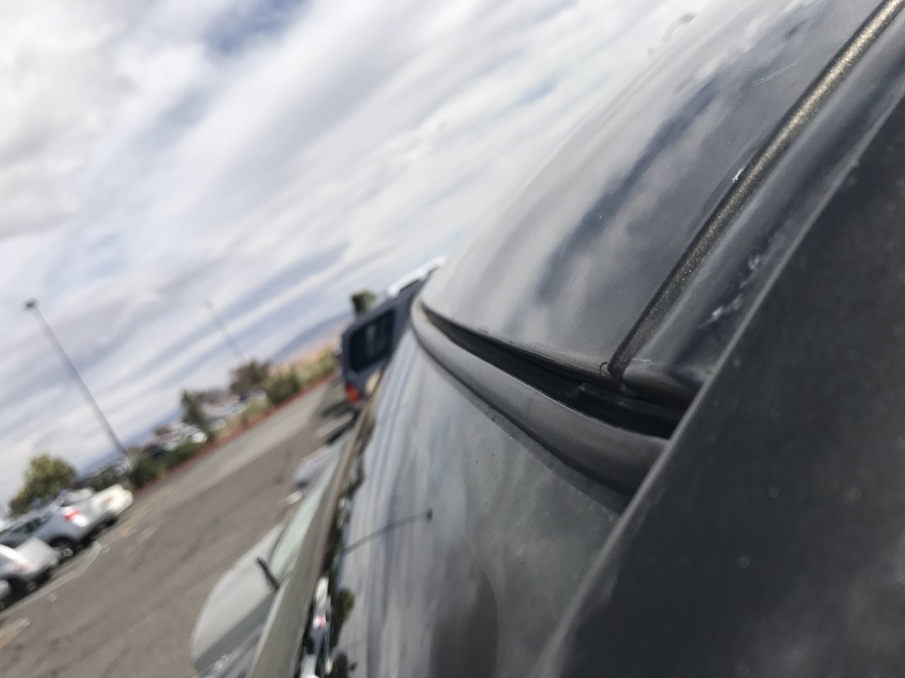

    The windshield seal flaps in the wind when driving, you can just poke it into the crack between the windshield and cab with a flathead. Takes 30 seconds
  4. Sep 18, 2017 at 12:21 PM
    #44
    Paul123
    Paul123 Web-Wheeler
    Feb 26, 2016
    #179510
    822
    Paul
    Reno
    2014 TRDOR pyrite mica, 3" lift 33's, 4.56’s
    Normally the upper side of the seal sits on top of the cab, you can see in the pic that I just poked it down. It fixed my kazoo 100% after being frustrated by everything else not working

    Here you go:
    This has stopped the noise for me.

    Sometimes it can be a pain because i don't have the drip line glued into the channel or anything so it can pop up a little or readjust itself. If you notice it moved, just fix it by readjusting it with your hands (or glue it in). Mine runs the length of the whole channel up to where you see it in the picture.
