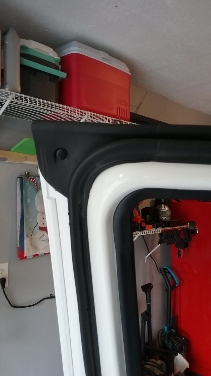

    Just thought I would update my situation. My rig is about 4 years old and basically had the squeaky seals right out of the gate. I didn't bother taking it to the dealership because, at the time, there wasn't an official fix and I figured they couldn't do anything more than I could. Silicone didn't work for me. And additional tubing inside the seal was only moderately effective.
    After poking around on various forums, I stumbled across a VW site. Apparently squeaky seals are common with them. They recommend a product sold by NAPA called Sil-Glyde. Worked great. After a couple of applications the speaking was completely gone.

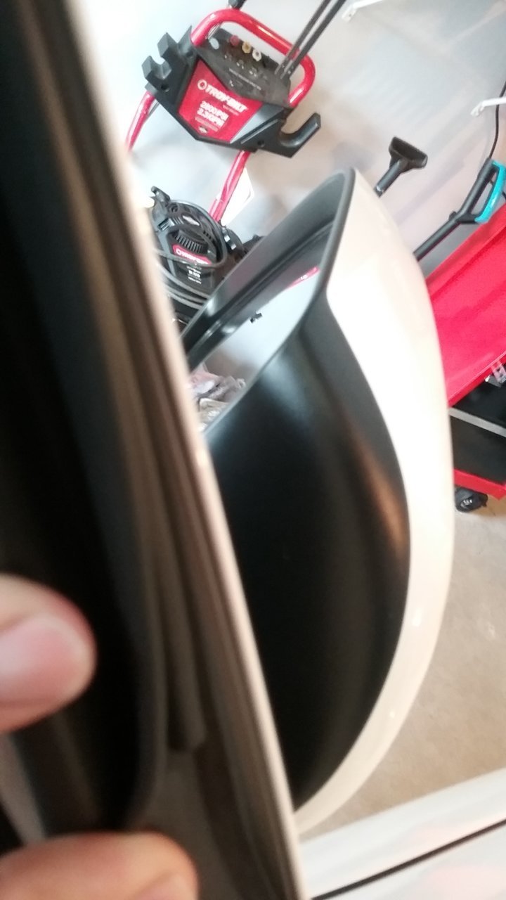

    However, over time I developed the dreaded cross-wind howl...both sides. I tinkered with several things, including additional tubing in various spots. Everything I did helped. But nothing was 100% effective. I just wasn't willing to get to intrusive with the seals.

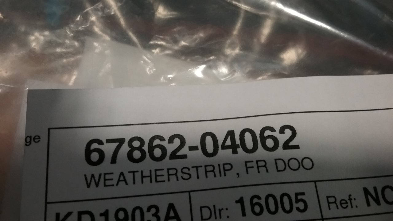

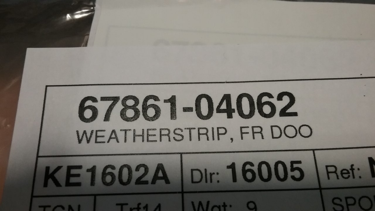

    So I broke down and ordered 2 revised seals for the front doors (DCSB). I paid $59 for each from my local dealer. Installed them this afternoon. Hopefully you can see in the pictures that the new seal has the additional tubing built in.
    They say this seal solves both the squeaking and the cross-wind howl. I alcohol wiped the door, jamb and inner seal several times to ensure the Sil-Gylde was all off.
    I will give updates over the next few days.

    A few tips for those wanting to tackle this job.
    Nothing difficult about at all. Just pull off the old seal. Most, if not all, the clips will stay on the door. I used a combination of needle nose pliers and a clip puller, both covered in electrical tape to avoid scratches, to remove the clips.
    Next, you'll need to remove the 10mm bolt securing the door-checker to the A-pillar. This allows you to remove the old seal and install the new one. Be mindful that the door is now free to open much further than usual.
    Next, you'll want to alcohol wipe the top of the door frame. This is important because there's an adhesive strip under the seal that needs to securely stick. It's not there to hold the seal in place....that's what the clips are for. But rather, it's there to help keep air from getting under the seal.
    I started in the top corner and worked my way clock wise around the door...snapping in each clip as I went.
    When done, go back up top and work your way across the top of the door to make sure that adhesive portion is secure.
    Don't forget to reinstall the door-checker bolt.

    Thanks for the info and part numbers!
