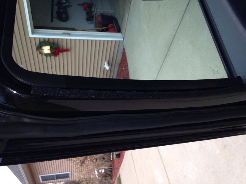

    I used a long piece of Velcro (soft side) on the door where it meets the rubber on the door frame.
    I found the idea on a BMW fourm.
    I have done to two Tacomas, no more noise.
