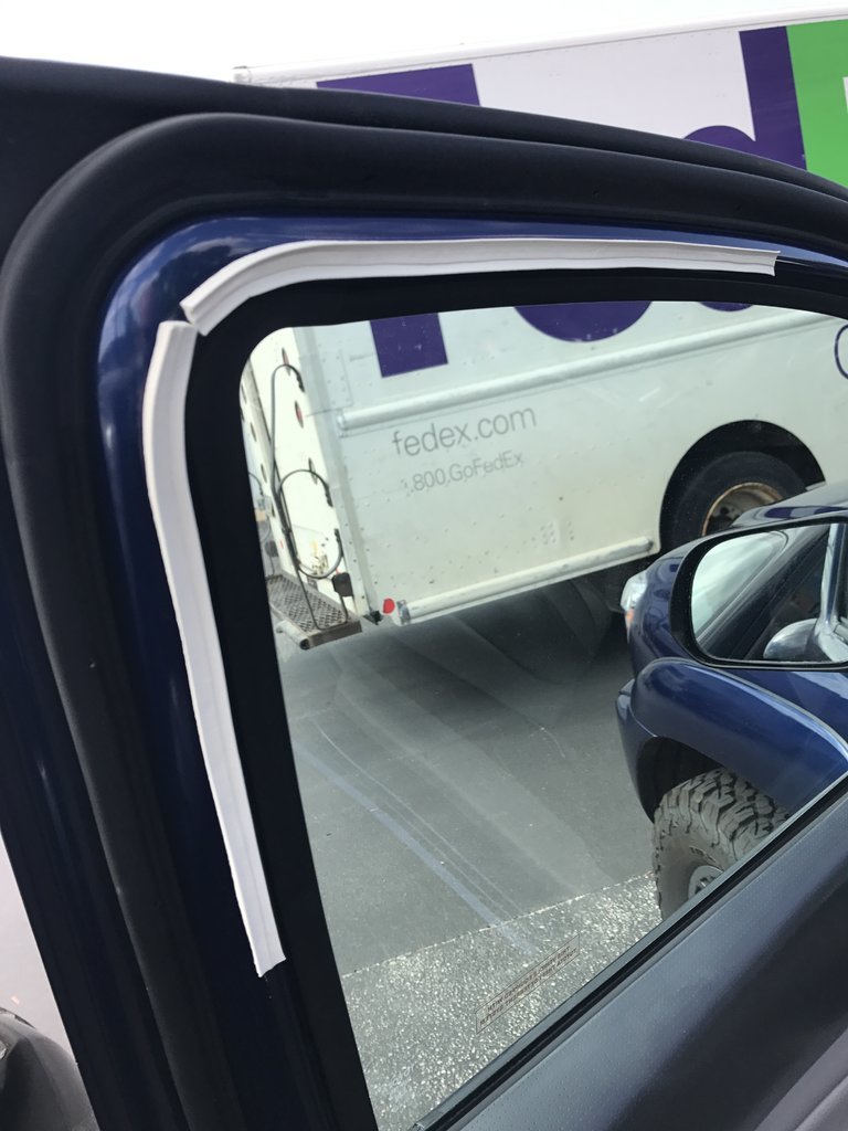

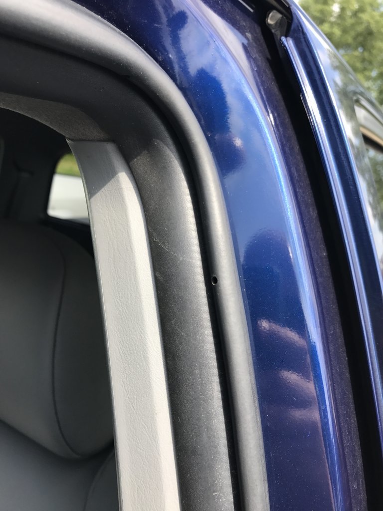

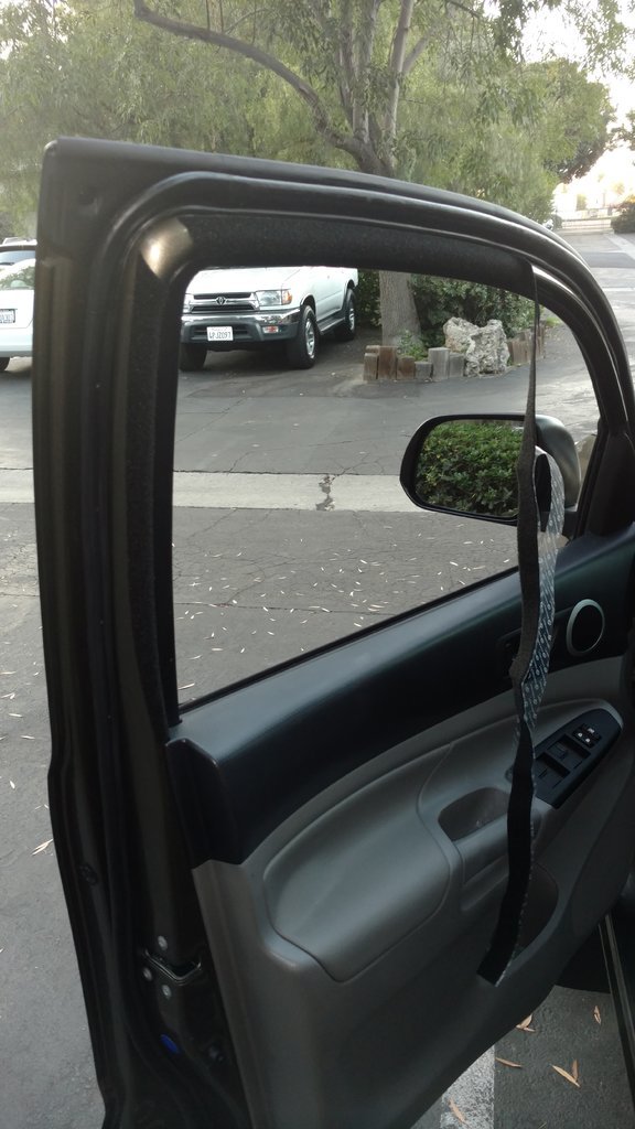

    IMG_20170818_191251003.jpg IMG_20170819_142112886.jpg IMG_20170819_132738399.jpg
    Someone mentioned using the fuzzy side of velcro.
    This works awesome, it completely eliminates the paint rubbing on the rubber - I took a little road trip yesterday and I'm not hearing that squeak at all.
    I got a little carried away, but I'm sure you could just do the corner and 6-7 inches on the top or down the side, just where needed. $18 for 10 foot strip, but I think they also had a 5 foot option too.
    This worked for me but you might have to experiment with the location, I bought the 10 foot strip cuz I was prepared to do the inside of the door frame too, but I didn't need to.
