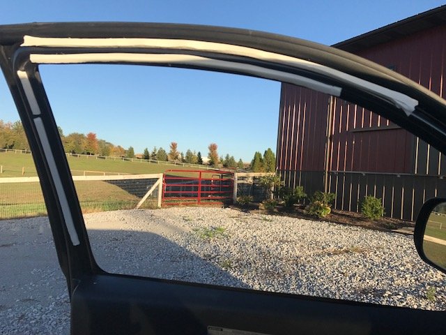

    Current situation:
    Still noisy :censored:

  4. Oct 19, 2017 at 7:34 PM
    #124
    Crazy Nick
    Crazy Nick Well-Known Member
    Oct 1, 2015
    #165591
    591
    Crazy
    03" TRD 4X2, 07" 4Runner 4X4, 2015 TRD Sport 4X4
    I think you're missing the mark. You're above and below the paint, so you're above and below the problem.
    Go back one page and check my pics, I'de really like to know if it works for you..
    BraskaTaco[QUOTED] likes this.
  5. Oct 24, 2017 at 6:05 PM
    #125
    BraskaTaco
    BraskaTaco Well-Known Member
    Jan 11, 2016
    #174711
    2,069
    Midwest
    2013 Tacoma TRD OR
    You’re definitely right, that muted the rattle but the strips have since compressed or been pushed out of the way so I orderd some tailgate seal to give that a shot :fingerscrossed:

    Tailgate seal seems to be the end all. Got mine on and silent as can be.

    I just got mine on last week but so long as the adhesive doesn’t wear out it should be a permanent fix since it completely covers the contact point on the door that causes the rattle against the door frame.
    I can take a pic later but mine looks just like TommyG’s.

    In my humble opinion you guys that are adding the thicker weather stripping are missing the mark, or making it worse by widening the gap.
    The squeaking is the paint on the door rubbing on the inside wether strip (or vice versa). Even if you used something as thin as cloth hockey tape it would stop the paint on rubber squeak.
    I used the fuzzy side of a velcro strip and I haven't heard a peep ever since...and definitely no leaks.
