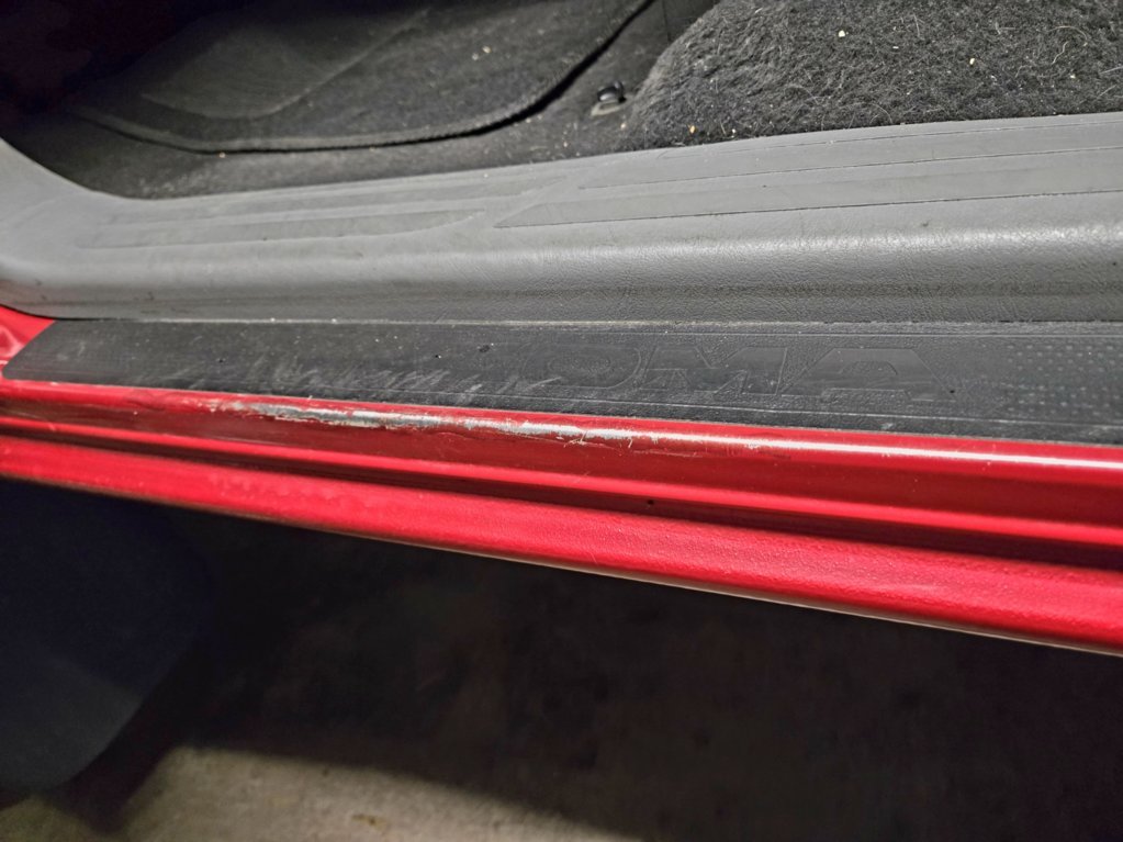

    My driver side door sills the paint is coming off, I bought some door sill protectors to put on to protect them from further damage. My question is should I paint the door sills first or could I just put the door sill protectors over the peeling paint without it rusting? I think it should be fine since it’s on the inside of the doors and won’t be out in the elements. Wanted to get different opinions. Here is a picture of the paint coming off. FE35365B-DEF2-41BB-8336-899DA83C3FC8.jpg

    The part of the sill is outside out the door seal so it will rust. My truck looks the same but worse, I'll need to have it painted.
    It doesn't look like it's down to bare metal yet.

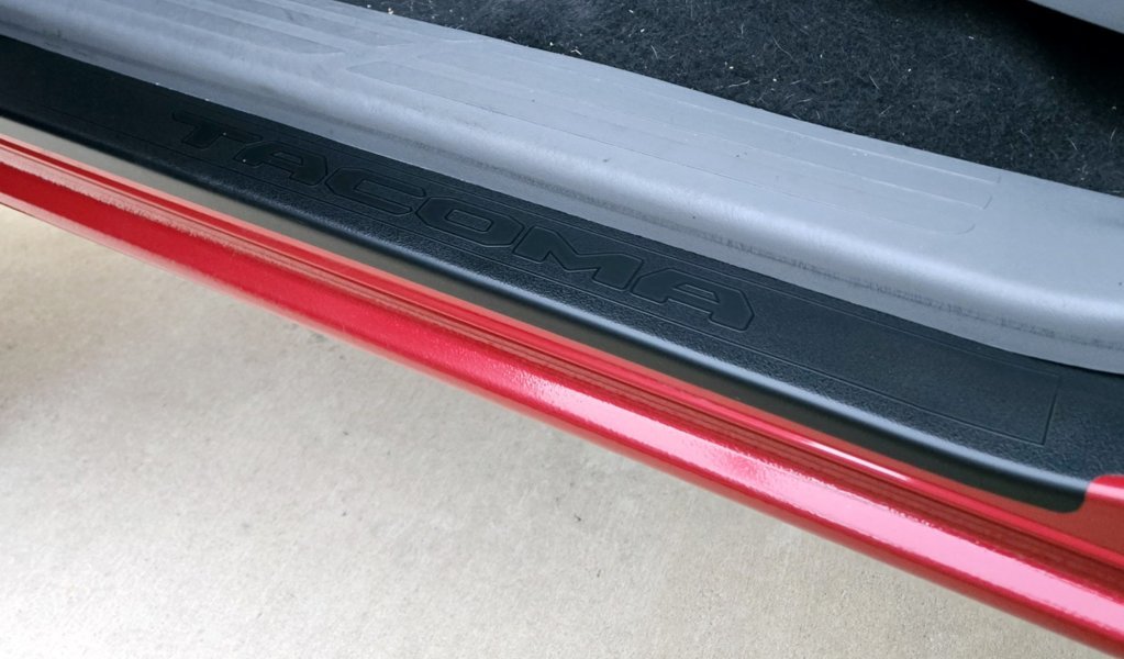

    Yup I also didn’t go with the OEM ones because they don’t wrap around where the paints worn. I went with these

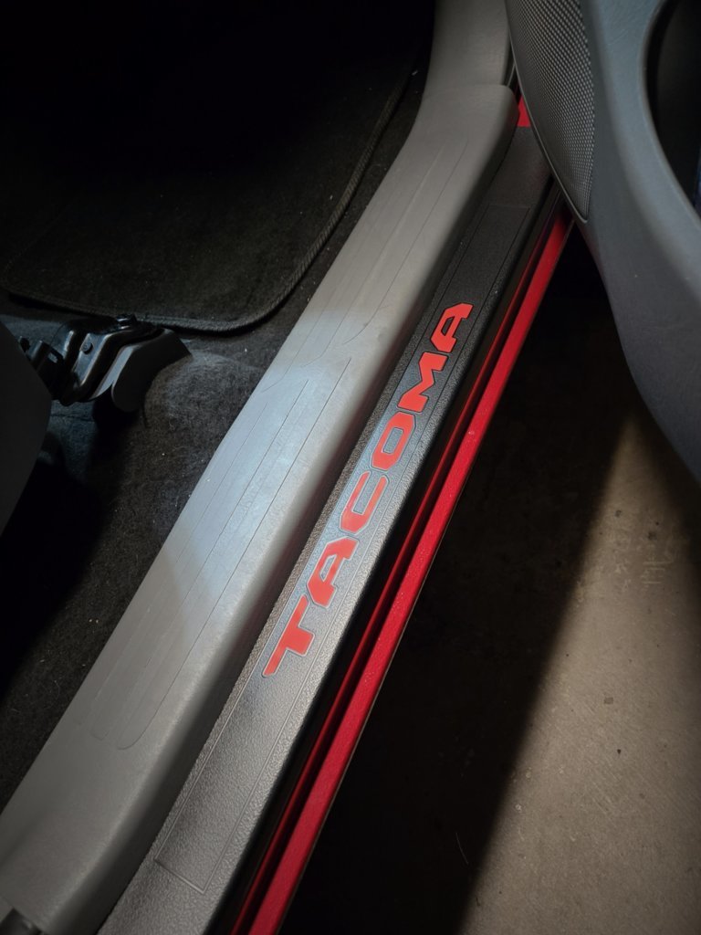

    The best fix is to Install the 3rd Gen Door Sill Protectors on the 2nd Gen Tacoma. I bought the genuine 3rd Gen Toyota Door Sill Protector for my 2014 double cab on Amazon $48 and installed them myself for a perfect factory look and then added the colored stickers into the letters for totally awesome finish.
    a400ryan, Jp5385[OP] and EdgemanVA like this.
