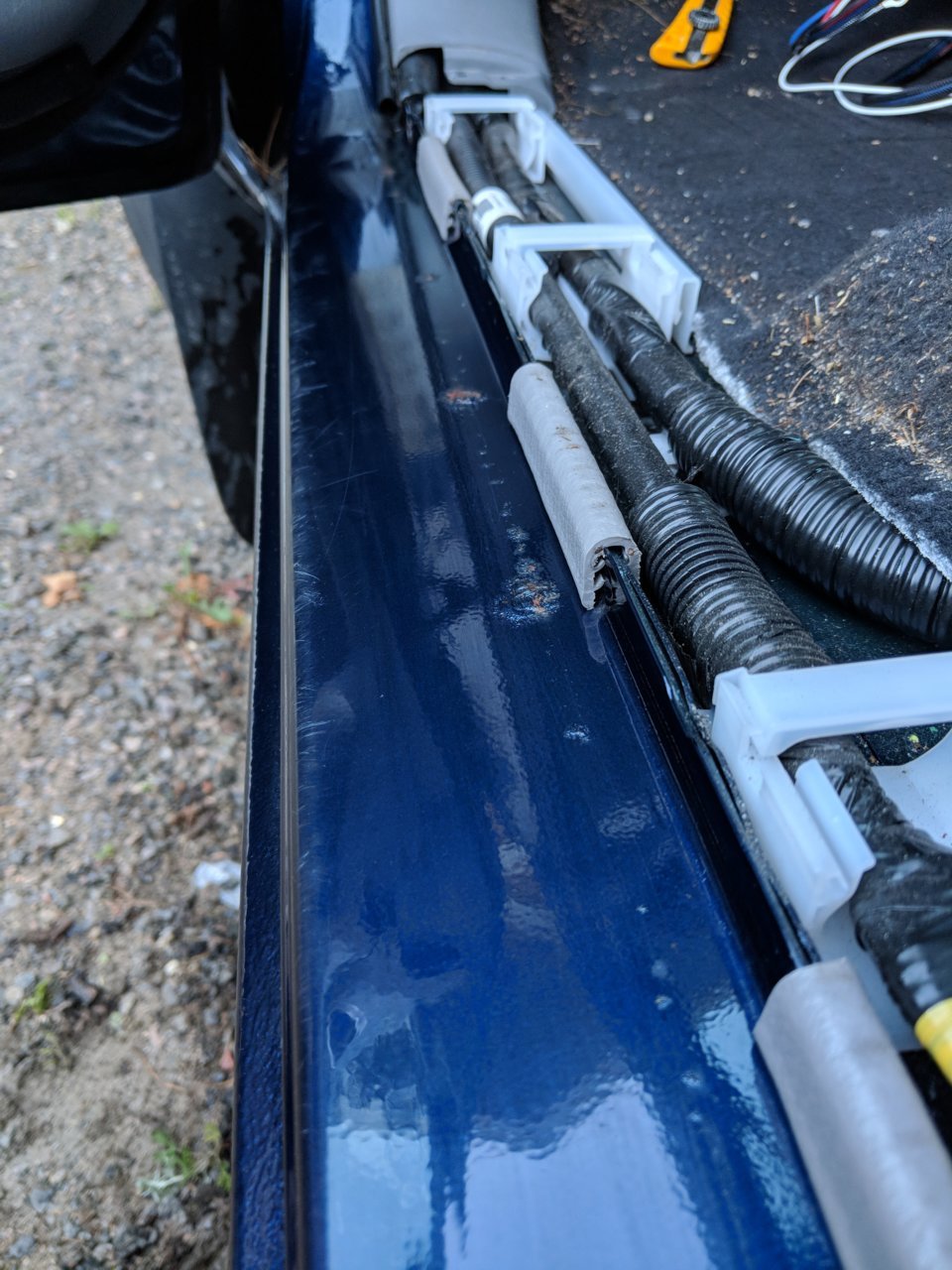

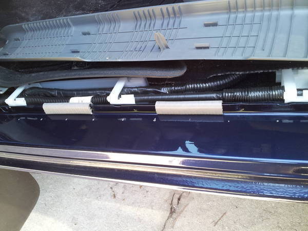

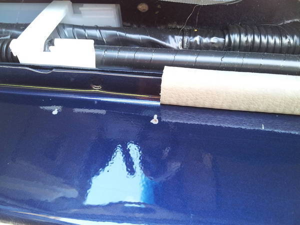

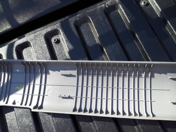

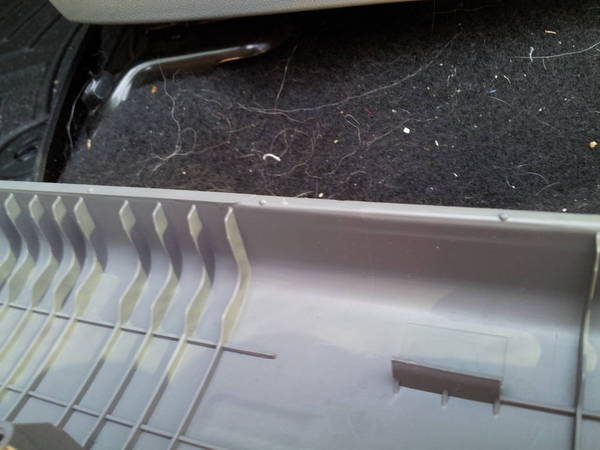

    On my 2012 DC I found that the little 'bumps' on the bottom edge of the plastic Door Scuff Plates had worn through the paint of my door sills down to the metal. Even started getting some rust on one of the spots. I first found it on the driver side, which was worn the worst, then check and found wear at all 4 doors.
    Took it to the dealership, they gave me a hard time at first about it. They ended up taking some pics and going to send it off to the Regional Manager to get Approval to fix my door sills under factory defect in the factory warranty.
    Has this happened to anyone else? If so, what did you do to resolve this? They mentioned about putting some foam tape under the edge after it's been fixed. Just wanted to get some feed back.

    Door sill protectors won't save you from that like suggested above. If it was me is grind those nubs flush and if dealer doesn't make headway definitely touch up those spots

    Touch up paint and grind off the plastic nubs in the area that caused this. Done.:cool:

    I'd touch it up, grind off the nubs that are contacting the paint and as extra precaution, place some 3-M chip guard under that area. Over the years a roll of 3-M chip guard has become one of my best frineds for so many applications on my truck and my bike.

    Hey dude. I got the same issue and mines rusting. What did you do to yours.

    I wish I would have caught on to this sooner :(
