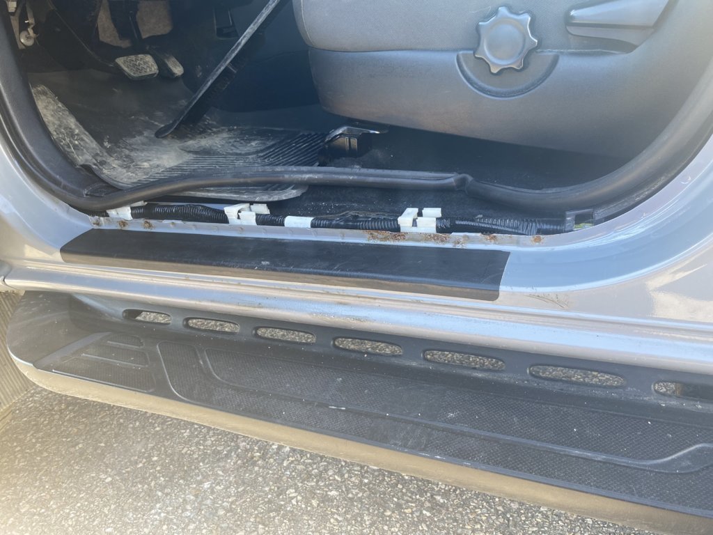

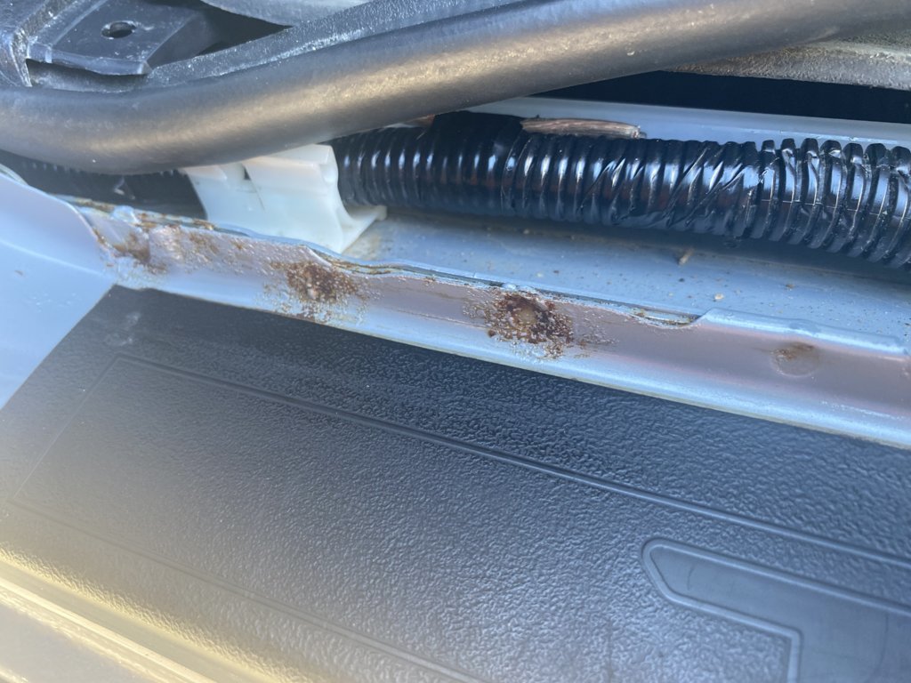

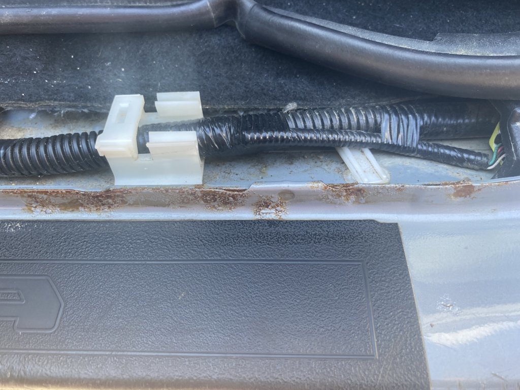

    Anyone having this issue? I have a 2016. About to perform surgery. Having a hard time getting the sill plate to come off. I have debadged using a hair dryer haven’t tried that yet IMG_5492.jpg

    #409697

    Are you in the Salt belt , or Canada?

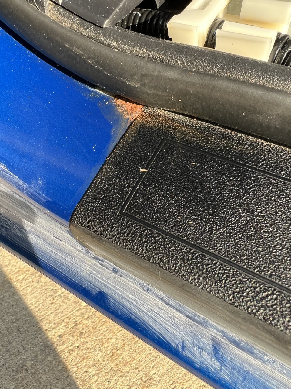

    My 17 had the same thing. Toyota fixed on my 23... they extended the sill protector so it covers that spot lol
