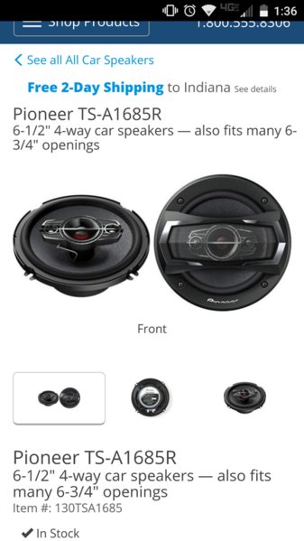

    I have these in my front doors and they sound awesome for the price
