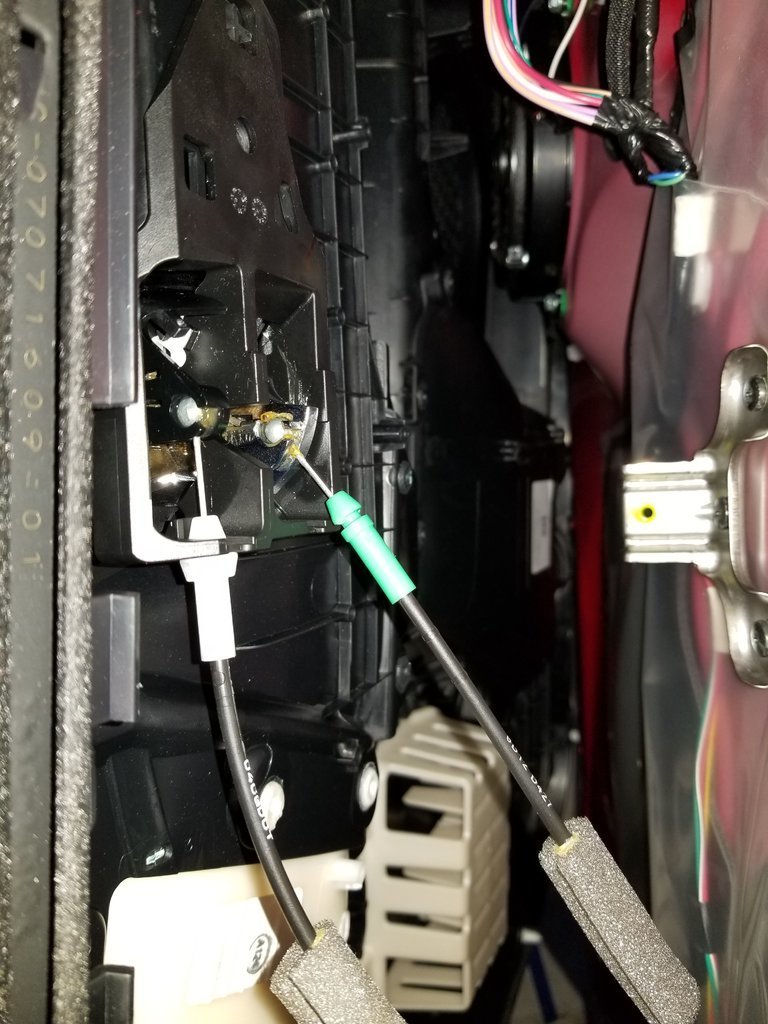

    Same thing happened to me. Check out the post below for the solution. I did not seat the cable all the way in.
    https://www.tacomaworld.com/threads/need-help-rear-passenger-door-wont-open.511685/#post-16093040
    The green plastic has to be inserted like the white one is.
