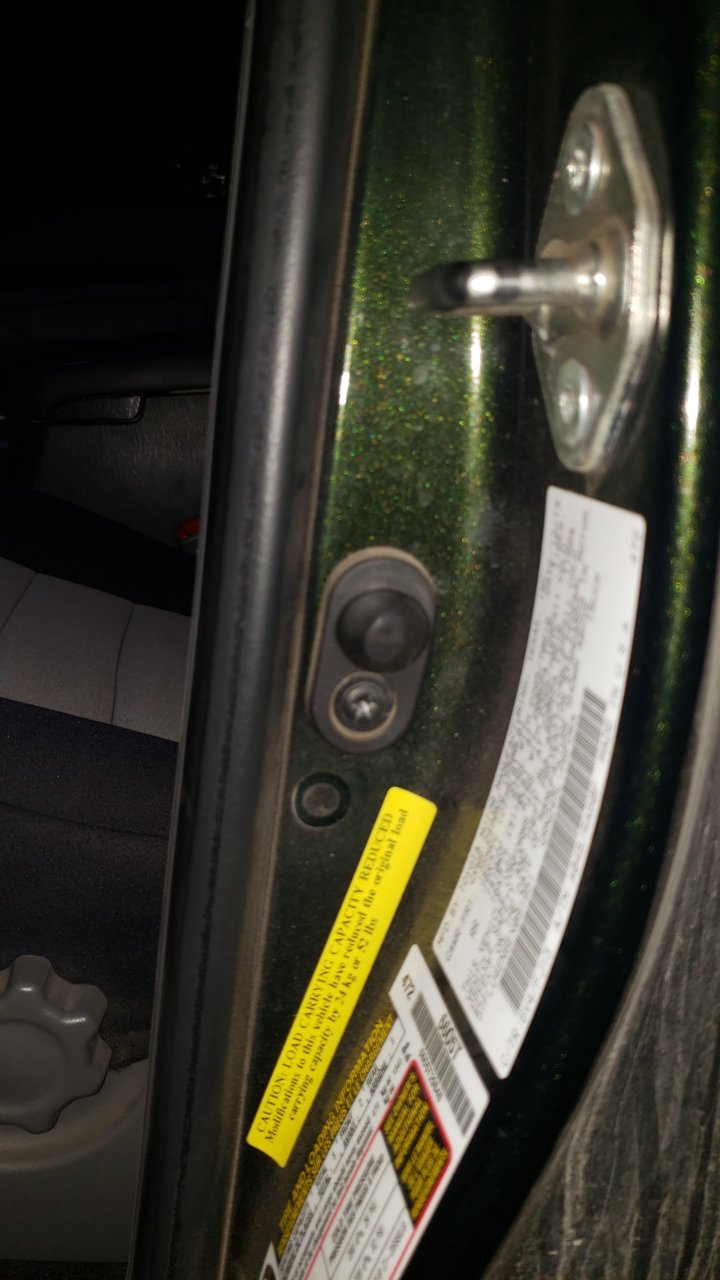

    Is this the switch you replaced?

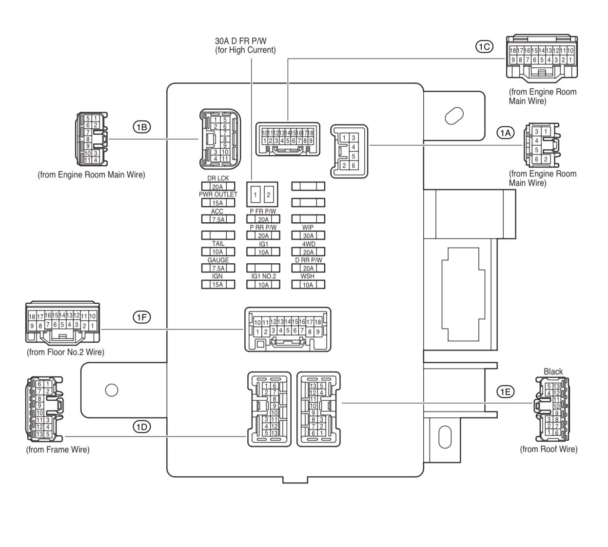

    If so make sure it has a good clean ground surface. If all is good and the wire isn't broken I would have to go with the Body Control Module on the back of the interior fuse panel.
    Back side of fuse box with the BCM Exposed:
    Dm93 and TnShooter like this.

    Yea, in fact it's not on the door at all it's under the latch striker on the B-Pillar.

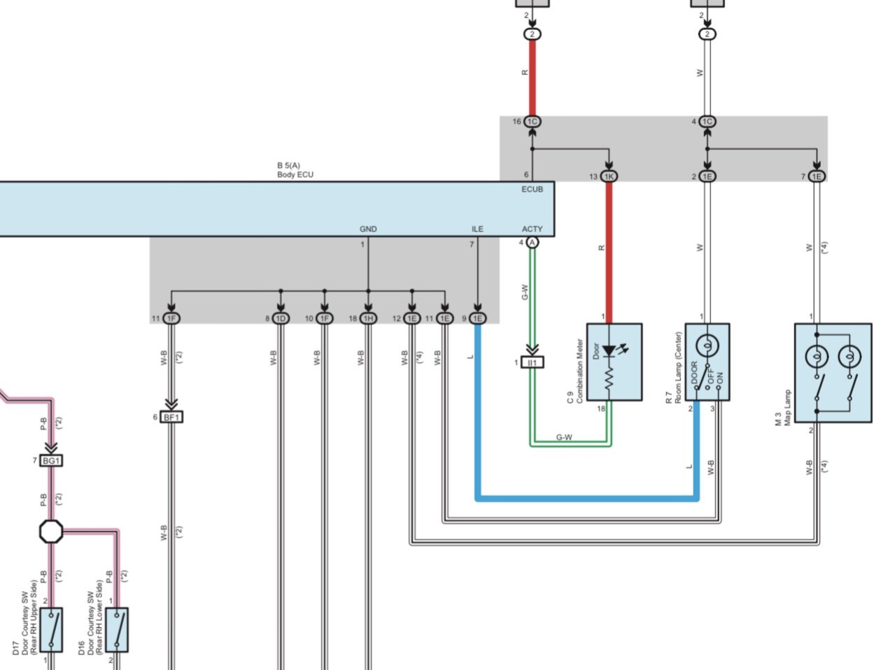

    I’d want to check the wire integrity at the 1E connector for BCM, then the Ground signal from the BCM.
    You could do that with a test light.
    I wouldn’t condemn the BCM until I checked. @Dm93 might have pin out for the BCM plug?
    I don’t have that info available currently.

    I agree not to condemn the Body ECU until circuit integrity is comfirmed, it's not common for them to fail unless they get wet from a water leak or something gets shorted.
    Toyota calls it the Body ECU, it is part of the interior fuse box.
    I don't believe it needs to be programmed.
    I'd look for a good used one before a new or reman.

    Pin #9 of 1E connector (blue wire) is Grounded by the BECU.
    I’d check the wire and use a test light to confirm the BECU doesn’t provide a ground.
    I guess if you wanted to be 100% sure you could do the same at the actual B5 BECU. Pin #7
    But 1E is easy to get to. I’d start there.
    Alway, Always, Always check everything before replacing the ECU.
    Yeah, they can go bad.
    But most of the time, it isn’t.
