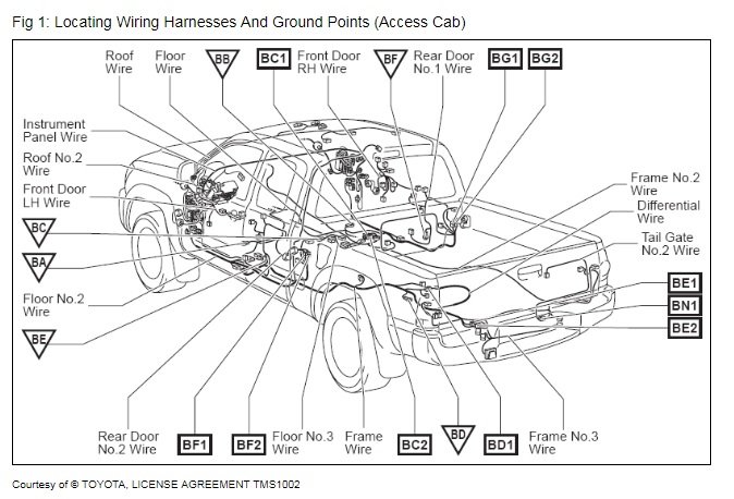

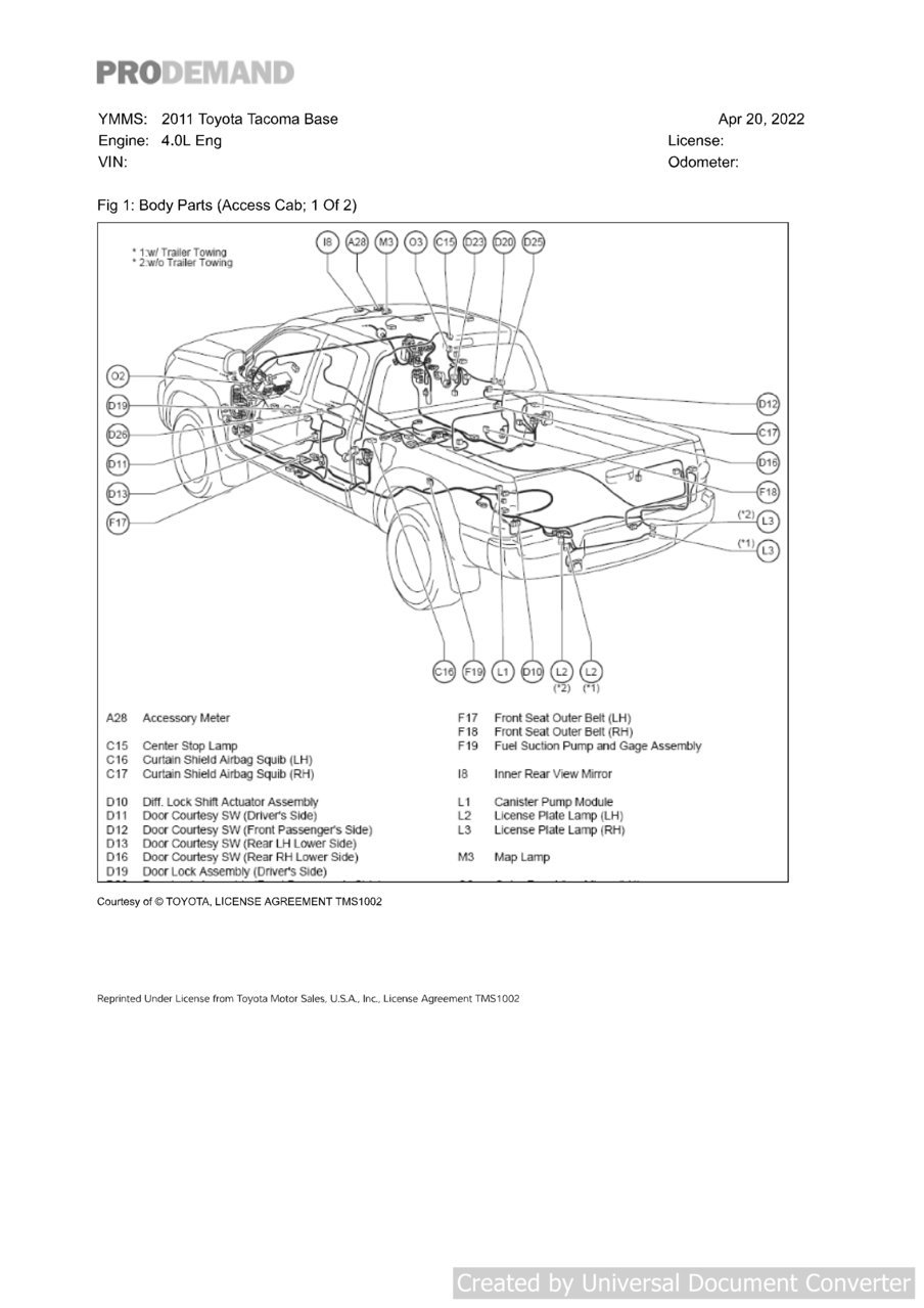

    Seems like a switch or wiring problem to me, have you taken the switch out and grounded the wire to a known good ground to see if it works consistently that way?

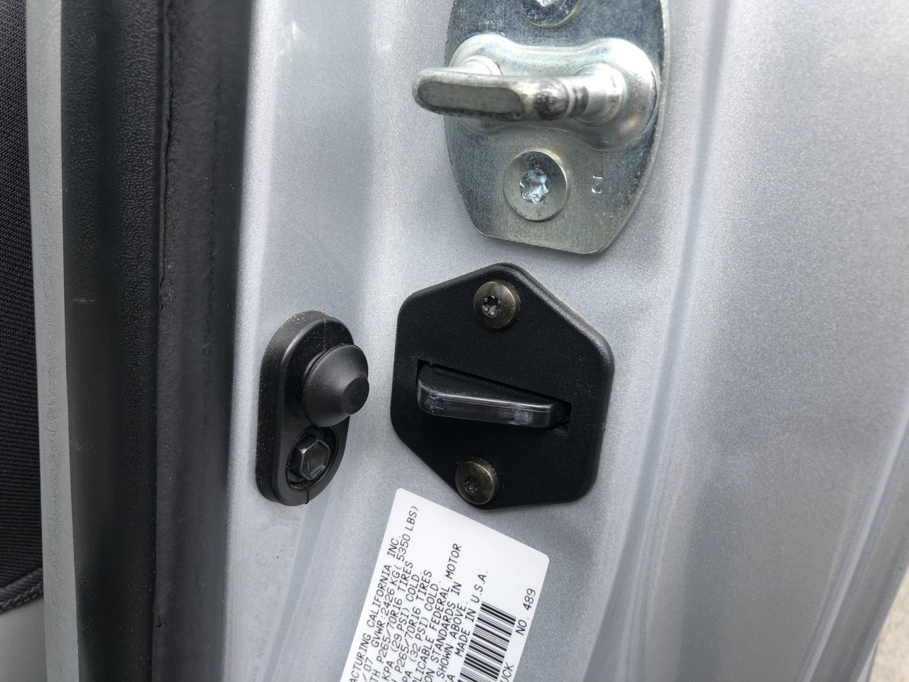

    The wiring diagram has an upper and lower switch. I can only find one.
    The one on the left in the picture below WILL turn the door ajar light off when pressed in.
    The one in the right is the safety for the rear door latch. With the flap out like shown in the picture. The rear door handle will unlatch the rear door.
    With it pressed IN (front door closed) you can NOT open the rear door. Evidently Toyota didn’t want your kid to open the door while going down the road. :rofl:
    Next time you are in your truck with the doors closed. Reach back and try to open the rear door. It won’t open.

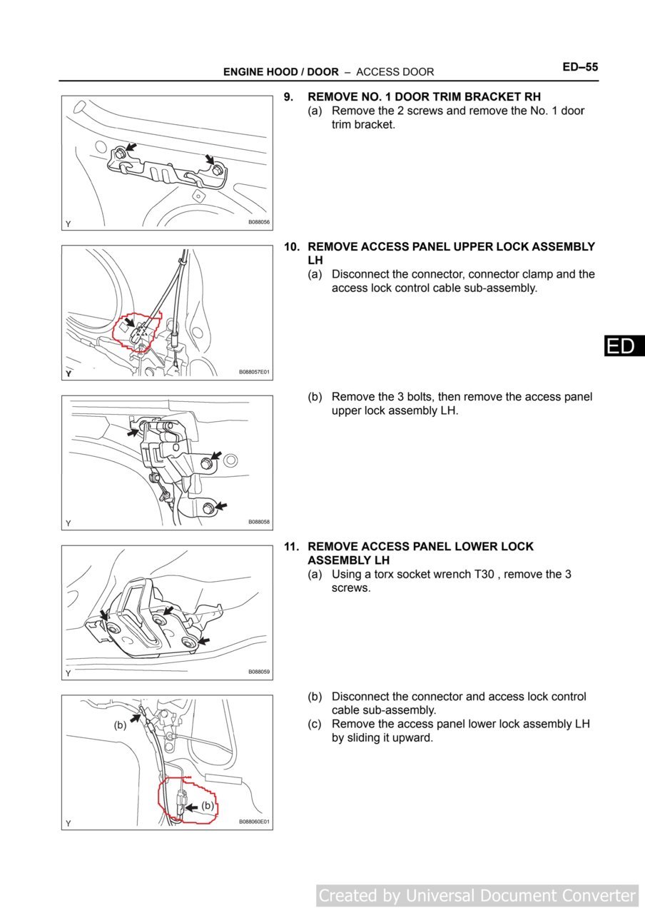

    The courtesy/door ajar switches for the rear doors on an access cab I believe are in the latches, they both have an electrical connector on them

    Seems you are correct.
    Opening both the front and rear doors and then pressing only the exterior switch (left in photo above) does NOT turn off the door light.
