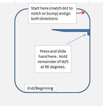

    Those weatherstrips have a metal carrier inside. It looks like a row of staples. The best way to install them is to press and smooth with one hand, while holding the loose end of the weatherstrip at a 90 degree angle to the door flange. It spreads those "staples" and lets the weatherstrip go on more easily.
    Usually these start in the upper rear corner, and go both directions (across the top, and down the rear) and the joint is somewhere in the front bottom section, under the scuff plate. But, some start in the front, top corner. Sorry, I don't know for sure on your truck.
    There should be a paint dot on the weatherstrip, about in the center, to show you where to start in that upper rear corner of the door opening. On the body, there may be a bump or notch to match up with the dot.
    Sounds complicated but it's not. Look for a dot around the middle of the W/S. Find a bump or notch near the upper rear (or possibly front) corner. Install in both directions, holding extra length at right angle while you press and smooth. Hopefully the ends meet as marked.
    Sometimes, if you pull too hard while installing, you'll have "extra" length. Pull some loose and try smoothing,massaging in the opposite direction to use up the extra. DO NOT CUT OFF. It will contract and pull loose later if you do.
    These are generalizations, but most are the same procedure.
